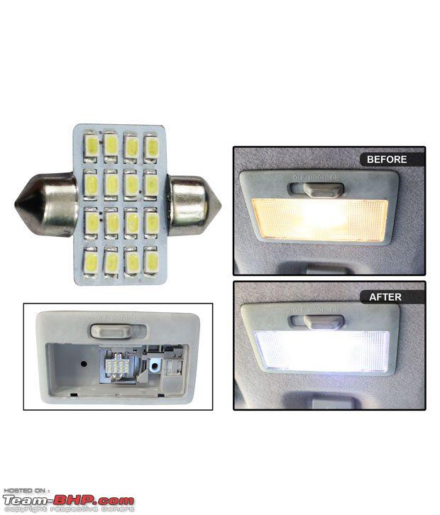

I installed a 48 SMD LED in my Swift last December. Light is too good and I am glad that I installed it.
Bought it from ebay at around Rs.150/- with some discount coupon.
http://www.ebay.in/itm/Super-Bright-...-/271623727959
This pic is from ebay listing. Will post my car pic soon.
Earlier I had installed a 16 SMD LED but it was not sufficient to illuminate the cabin

Nice Mod. I picked up a gigantic 48 LED panel with the festoon adapter from eBay for ~65rs after discounts. It was really big and barely fit in my car's roof light
DIY Install: LED cabin lights for the Maruti Swift-img_20141212_071454001.jpg
However the light was so damn bright, my friends nick named it "cricket stadium lights" after seeing the lights on in my car :D
DIY Install: LED cabin lights for the Maruti Swift-img_20141220_061003001.jpg

Thanks for this DIY. I too wanted to do it in my Swift but was thinking it would mess up the original setup and I wouldn't able to go back in case I want to. After seeing your post, it is clear that the mod is very simple and can be put back very easily. Will try it soon.
