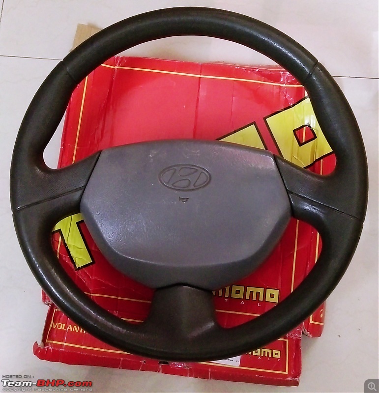

The stock steering
DIY: Installing a Momo Steering Wheel-imag1317.jpg

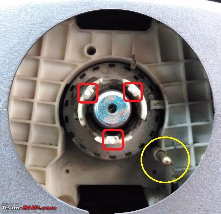

This stub is (+) HORN connection but would not match with delivered HUB, so had to do some JUGAAD (alternate arrangement)

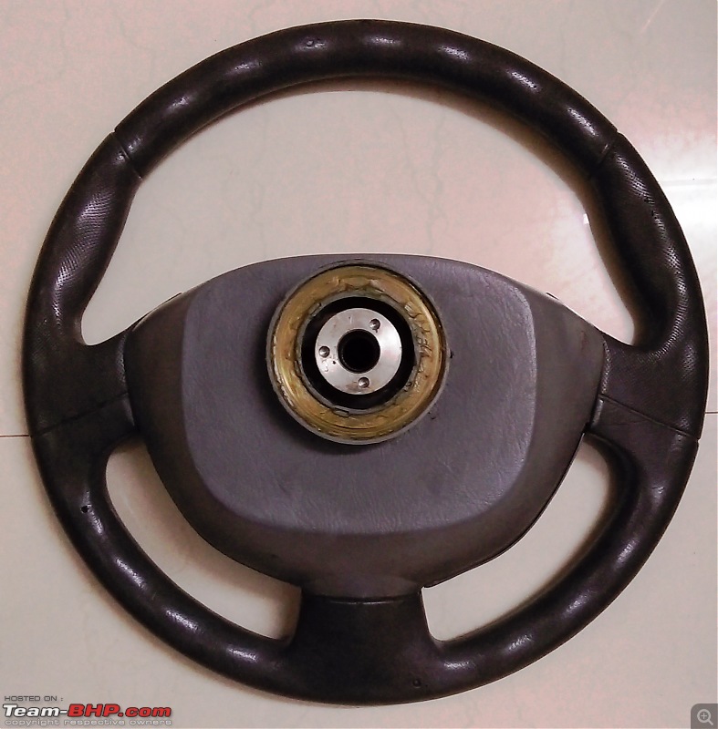

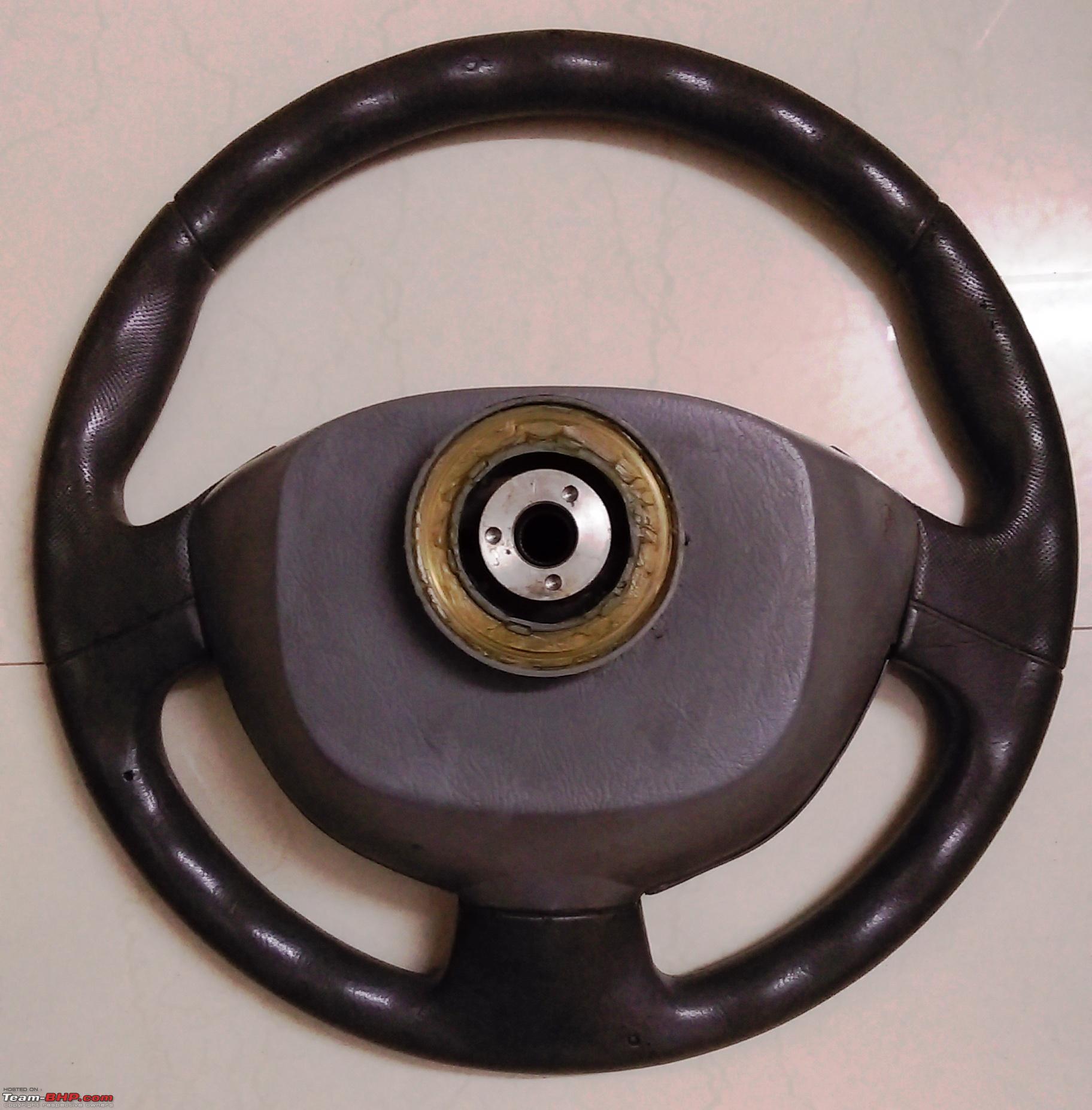

The HUB for aftermarket steering.
That mirrored section (yellow circled) is what need to be in connection with that STUB shown in photo above.
Hi, thanks for the detailed post, have a Momo-Prototipo myself that was bought a couple of years ago & currently lying unused at home - hence your post made for interesting reading.
I had tried to install it a few months back, but ran into similar issues that you did, hence backed off - your thread is great encouragement in this regard - Thanks !
If you still have the stock steering wheel, can I trouble you to post the underside of that too ?
Thanks in advance...

Originally Posted by im_srini View Post
If you still have the stock steering wheel, can I trouble you to post the underside of that too? Thanks in advance...
Hope these help:

As asked & answered on that thread, for turn signal cancellation, the steering column has plastic pins which seat into matching holes in the underside of the wheel.
In my case, the pins are too wide to seat properly into the holes in the hub - widening the holes in the hub should allow turn signal cancellation though.
Now, worried about the horn too !
I agree and had matched the three holes with that of signal cancellation turnstile, but one of them was not matching so after testing it with new HUB I had to thin out one pin to fit it snugly in the given hole. Now it works just fine.
These photos should help more:
