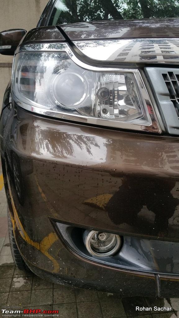

I'm sure like mine, your Facebook feed is full of 'life hacks'. Many of them car related. I finally decided to try one out:
Headlight Restoration Using Toothpaste
Let the images do the talking:
- Let's see some before pictures:
DIY: Headlight restoration using toothpaste!-1.-original-left.jpg
DIY: Headlight restoration using toothpaste!-2.-original-right.jpg

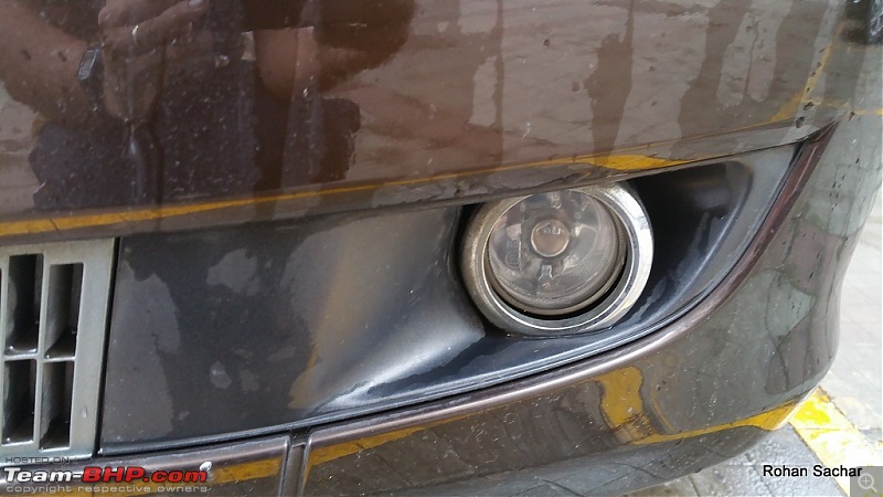

- While the headlamps were fine, it's the fog lamps that had gone really bad:
DIY: Headlight restoration using toothpaste!-3.-fog-left.jpg
DIY: Headlight restoration using toothpaste!-4.-fog-right.jpg

- Initially, clean the area somewhat with water to remove some external dirt. Apply toothpaste evenly across the glass surface:
DIY: Headlight restoration using toothpaste!-6.-application-left.jpg
DIY: Headlight restoration using toothpaste!-7.-application-right.jpg
- Let is stay for 5~10 minutes, then rinse it out. The results were AWESOME:
DIY: Headlight restoration using toothpaste!-8.-after-left.jpg
DIY: Headlight restoration using toothpaste!-9.-after-right.jpg
- Looking at specifically the fog lamps:
DIY: Headlight restoration using toothpaste!-10.-fog-left.jpg
DIY: Headlight restoration using toothpaste!-11.-fog-right.jpg
