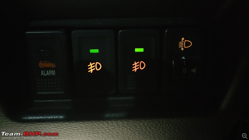

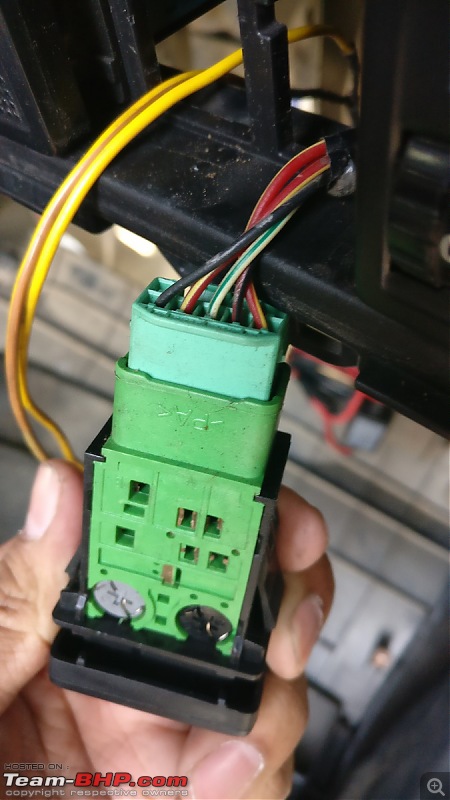

Hi, how did you connect the high beam to your new fog lamp switch? I also have a spare switch available to fit DRLs, but the project is hanging as I am unable to get the matching connectors. Can you pls shed some light on how to manage? Thanks.

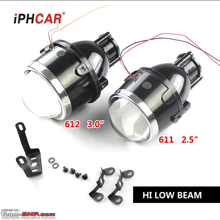

Xenon Planet does not manufacture anything on their own. They source it from outside. XP Micro projector is made by "IPHCAR". The same brand fog projector is available at little lesser price in AliExpress. But the output is not the same. According to Xenon Planet they do minor modifications / tuning to get the best output and they also provide 2 years warranty :)
Details about IPHCAR fog projector :
DIY Install: 3" XP Micro Bi-Xenon Foglight Projectors on my Swift-6358934077438971136548689.jpg
DIY Install: 3" XP Micro Bi-Xenon Foglight Projectors on my Swift-6358934077546611327715431.jpg
http://www.cindyhid.com/en_us/product/show-332.html

OE Fog light connector
DIY Install: 3" XP Micro Bi-Xenon Foglight Projectors on my Swift-oe-fog-light-connector.jpg
I used this old disconnected coupler of Ford Ikon that I found in scrap of the garage. removed the pins, cleaned it and checked if they fit correctly, Voila! Heat shrink'ed them and connected it

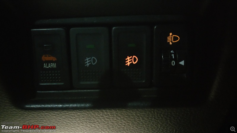

When parking lamp is switched ON
DIY Install: 3" XP Micro Bi-Xenon Foglight Projectors on my Swift-when-parking-lamp-switched-.jpg
When OE fog light switch is pressed when parking light is ON, low beam of XP micro is activated also the green light comes up in that switch
DIY Install: 3" XP Micro Bi-Xenon Foglight Projectors on my Swift-when-oe-fog-switch-pressed.jpg
When I press the second switch, the green light comes up activating the high beam of the XP Micro. Here's how it in the night.
DIY Install: 3" XP Micro Bi-Xenon Foglight Projectors on my Swift-when-high-beam-activated.jpg
I have shared the images above post connection.
