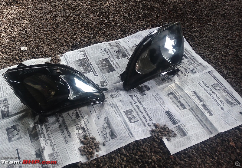

From this
DIY: Headlamp restoration using Clear-Coat-img_20170617_133720.jpg
To this
DIY: Headlamp restoration using Clear-Coat-img_20170617_192225.jpg
DIY: Headlamp restoration using Clear-Coat-img_20170619_163815.jpg

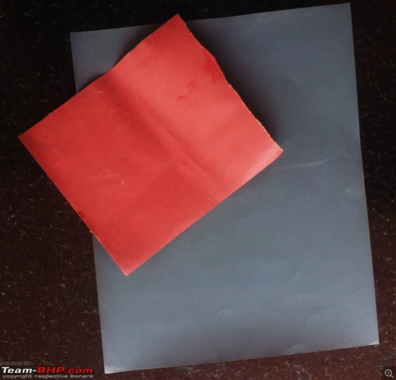

600 Grit and 2000 Grit Sandpapers.

DIY: Headlamp restoration using Clear-Coat-img_20170618_131558.jpg
Here is the result.
