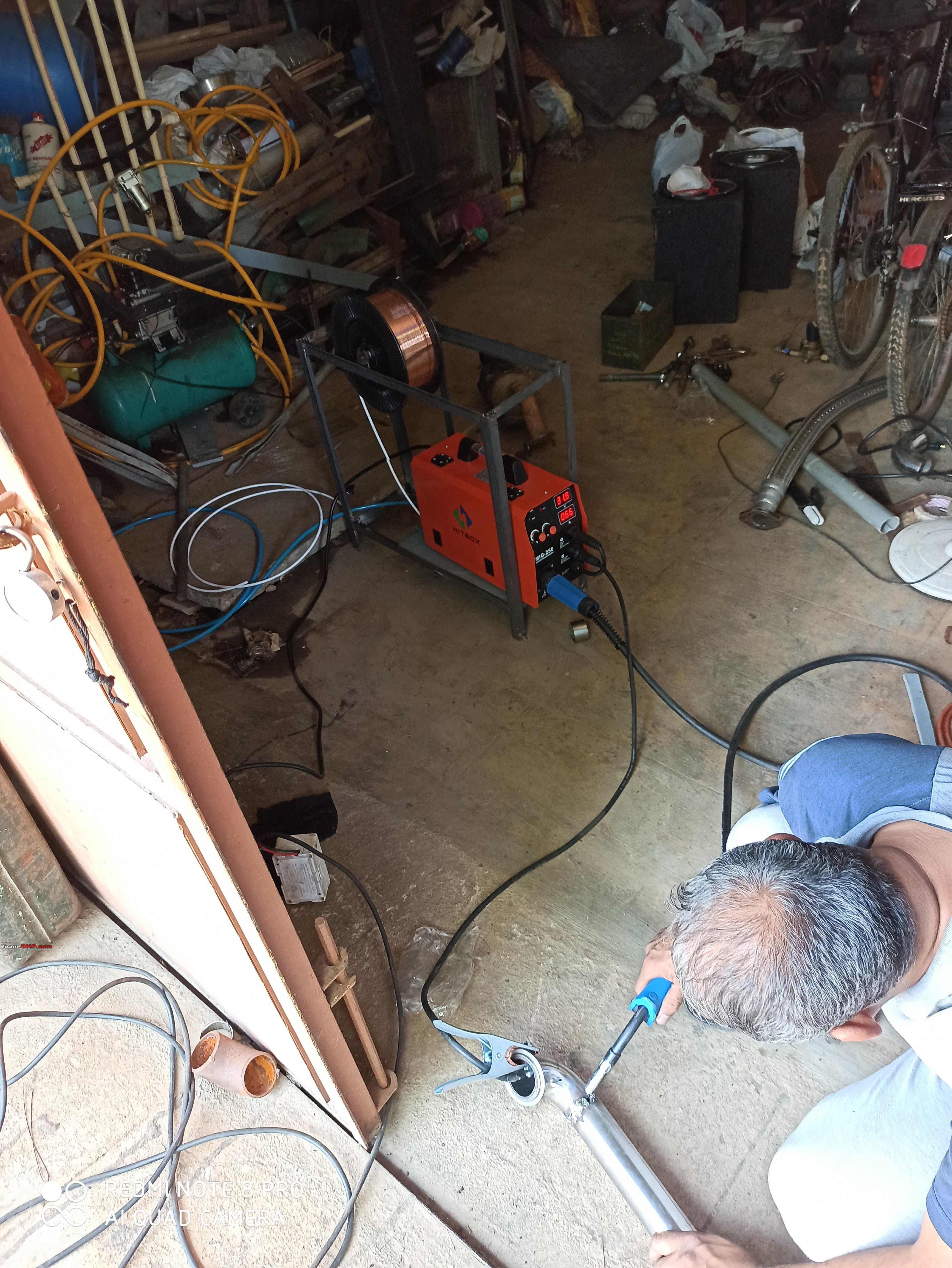

Originally Posted by Dr.Naren View Post
This is very interesting, never knew one could DIY a decat downpipe for just 1.6k
Actually the pipes may have costed 300-400 max and welding didn't cost anything, it was a pure DIY at a tbhp'ians home.
(Spot his MIG, Arc welders, air comp, and many more toys), ps - we were officially on-calls but playing with our cars!
DIY: My experiments with DeCat, EGRs and PUC testing-img_20200313_115913.jpg
DIY: My experiments with DeCat, EGRs and PUC testing-img_20200313_111803.jpg
DIY: My experiments with DeCat, EGRs and PUC testing-img_20200313_132340.jpg
