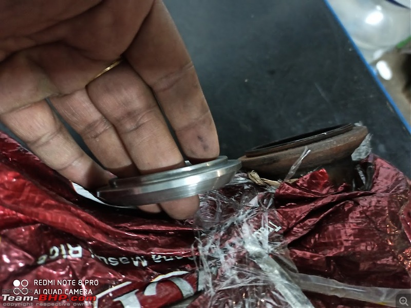

Make two flanges identical to the ones on your cars catcon.
DIY: My experiments with DeCat, EGRs and PUC testing-oval-flange.jpg
DIY: My experiments with DeCat, EGRs and PUC testing-taper-flange.jpg
DIY: My experiments with DeCat, EGRs and PUC testing-taper-flange1.jpg

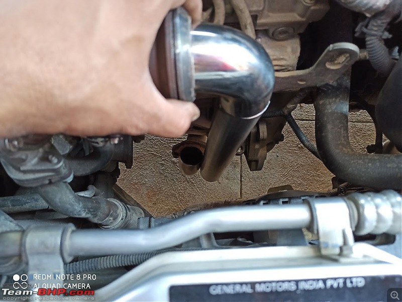

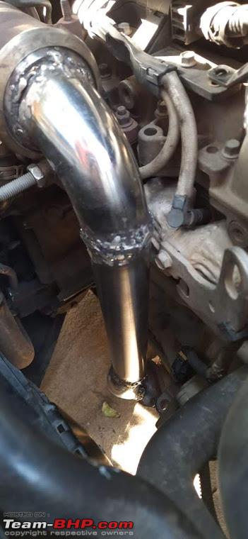

Get some 1mm to 1.5mm thick SS bends and pipe lengths.
DIY: My experiments with DeCat, EGRs and PUC testing-ss1.jpg
DIY: My experiments with DeCat, EGRs and PUC testing-ss2.jpg
DIY: My experiments with DeCat, EGRs and PUC testing-ss3.jpg
DIY: My experiments with DeCat, EGRs and PUC testing-ss4.jpg

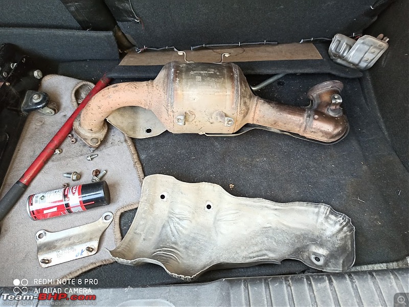

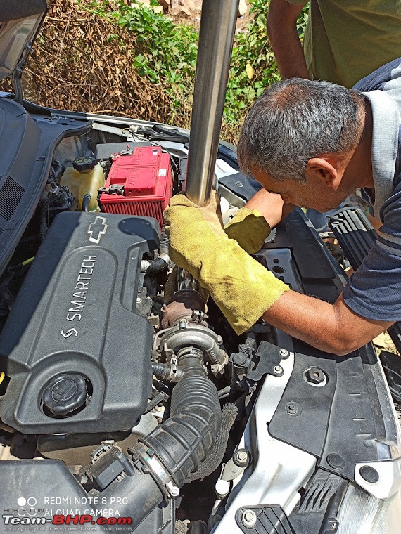

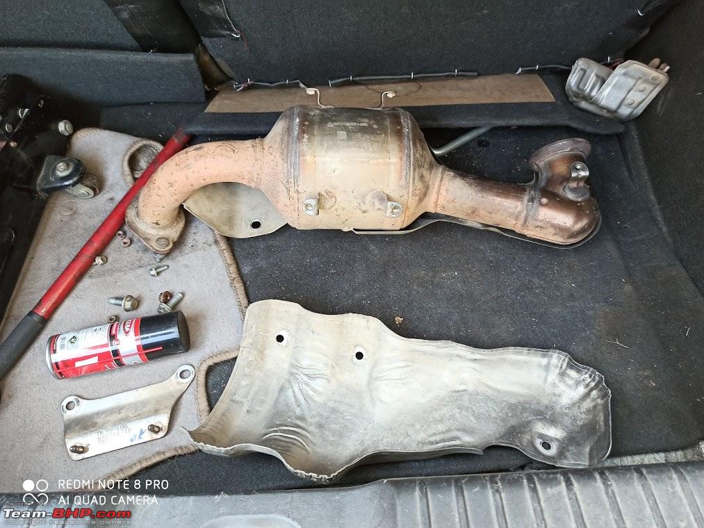

You need basic welding knowledge and a welding machine and presto - the cat is out of the car.
DIY: My experiments with DeCat, EGRs and PUC testing-ss-last.jpg
DIY: My experiments with DeCat, EGRs and PUC testing-catcon-removed.jpg

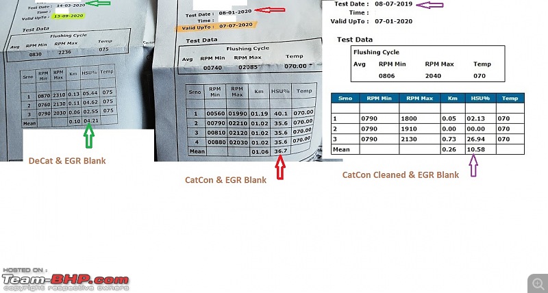

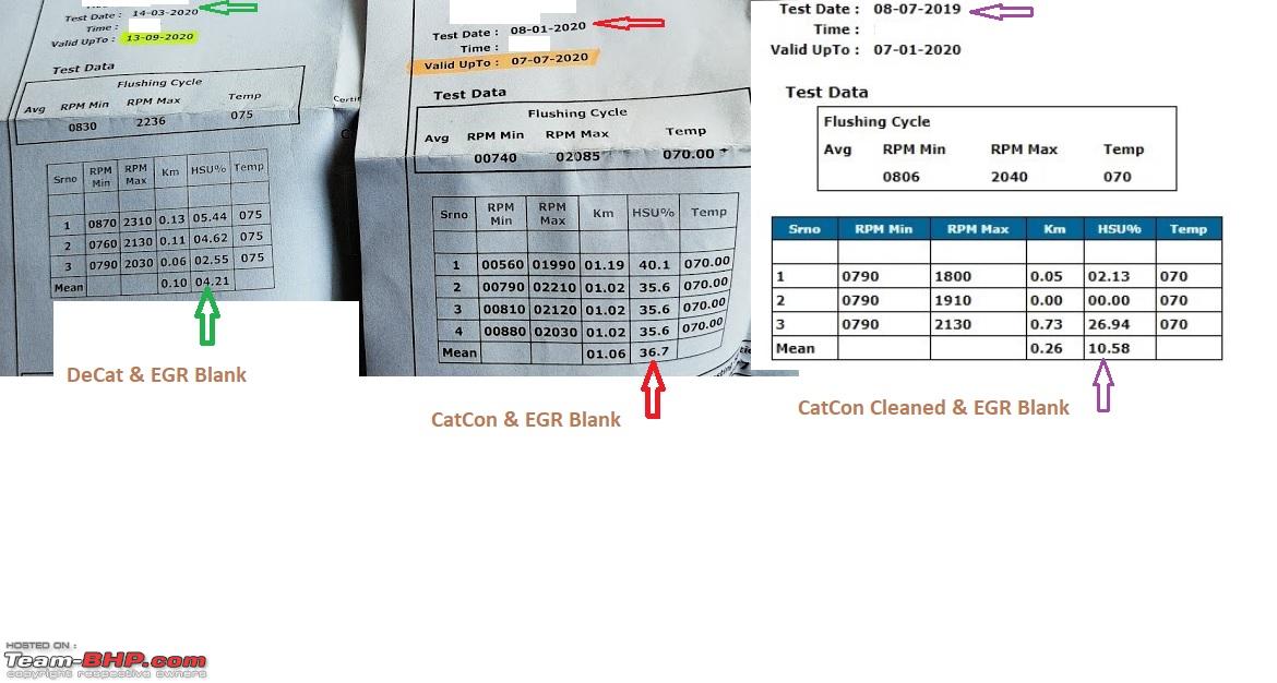

What does your 100-150Rs tell you and the government every 180 days? That you driving your car daily on public roads is equal to planting a sapling along the road side? Or that your car is within the stipulated pollutant limits & norms, provided is is tested in accordance to the procedures laid down by some department in the Honb'le Govt of your respective state or the overall National MVA?
I wonder what exactly is the engineering, policies, decisions behind the PUC shops, their machines, equipments, processes, etc etc. See my cars history of emission certs from last two times. (Third was taken recently to disprove Catcon is essential).
DIY: My experiments with DeCat, EGRs and PUC testing-compare-emissions1111.jpg
Case 1 - EGR bypassed, catcon was cleaned recently, PUC pass
Case 2 - EGR bypassed, catcon was driven 6 months, HSU% slightly on higherside
Case 3 - Decat (recently) - CLEANEST EMISSION CERT IN A LONG TIME
I was thinking to myself, "Who is making a bigger fool of whom here?"

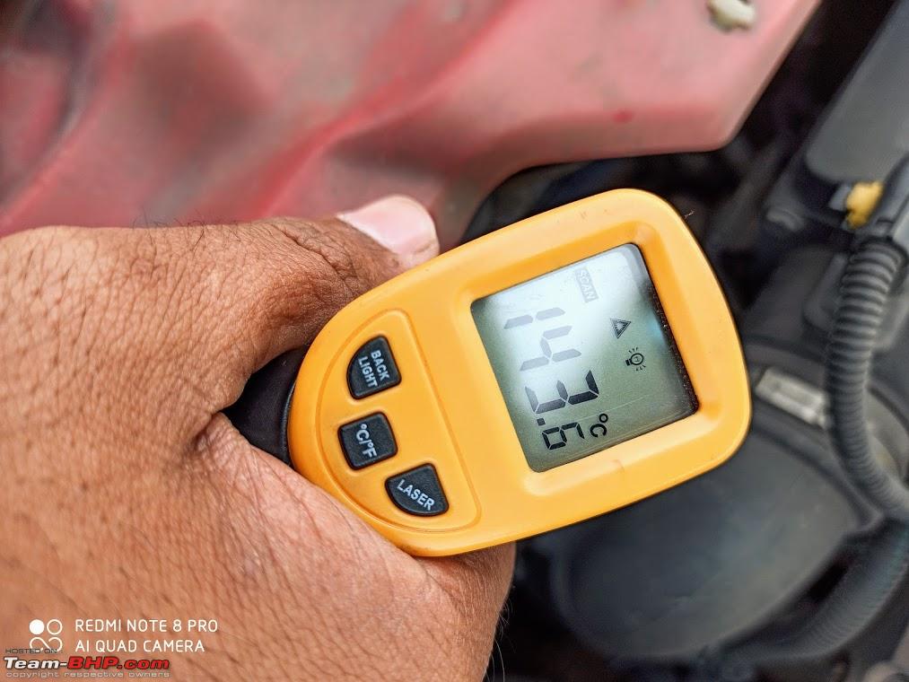

Before talking about pressure, let me share some basic observations made during the course of this experiment.
Catcon surface temp outside the fat bottle area, at full RPM (similar car, 1.3MJD Punto, similar age and odo)
DIY: My experiments with DeCat, EGRs and PUC testing-catcon-temperature.jpg
My Cars exhaust manifold junction (where the input turbo spools) at full RPM
DIY: My experiments with DeCat, EGRs and PUC testing-cast-temp-170c.jpg
Same time as above, full RPM, my Decat downpipe surface temp
DIY: My experiments with DeCat, EGRs and PUC testing-ss-temp-75c.jpg
One should know the Catcons 1st level filter in principle is a barrier to fluid flow (exhaust gases) and it creates a high pressure zone between the engine's manifold and catcons 1st filter.

PUC - Duh, its a Farce! I am on the lookout for a industrial gases testing lab, I am ready to volunteer my car for a 'real' test of effects of Decat on our environment. I am sure its belching out unacceptable level of heavy metals without being caught by the current PUC Standards.
Time to upgrade and overhaul our PUC industry inside out.

Indeed your test results are quite eye opening. A car without cat-con is giving the cleanest emission test result! Wicked. Not a huge surprise for me, looking at the devices being used since decades for these tests & the level to which our fellow Indians go to rig scanning devices / meters for commercial gains. I don't have a huge hope that the "online" PUC tests will make a big difference to this either.
Anyway - don't want to deviate too much from the main topic, there are other threads already discussing plenty about weak emission test practices in many parts of the country.
Thanks for posting the test results. Food for thought if taken in the right spirit indeed. (I don't personally agree with removing a cat-con from a vehicle of course.)
Actually you got me wrong here. I am saying that what the government is checking in the name of PUC (what ever that HSU% means) is actually cleaner without a Catcon. I know I may sound very stupid here, but my hunch is government is looking for the wrong component in emissions and I want this thread to be an eye opener. I can vouch for the 2 emission centers I frequent, they dont fudge as long as I know. But there is something very wrong that our current PUC norms are checking for.

The exhaust emission readings only show smoke measurements, not HC or CO. Maybe there would have been a difference if these, too, were measured before and after de-cat.
BTW, a known limitation of infrared thermometers is that they measure different temperatures depending on the reflectivity of the surface being measured. A highly reflective surface, such as polished stainless steel, will cause an IR thermometer to display a lower temperature. So this means that manifold temperature as seen in the photo cannot be trusted. The correct way to measure the temperature would be with a contact-type thermocouple.
