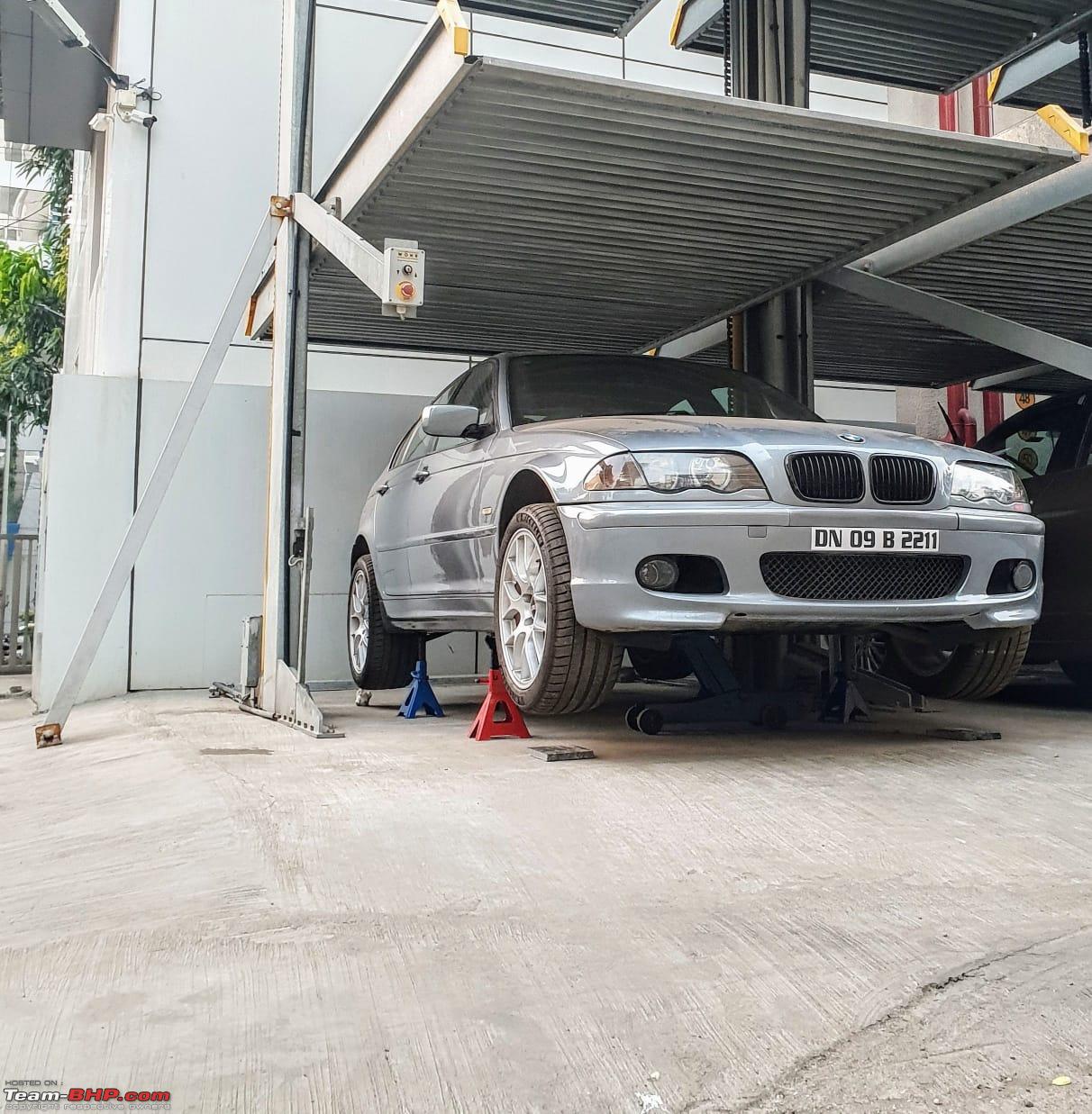

- Moto Heavy Jack;
This Jack makes life easy than the conventional Jack provided with the stepney/spare tyre.
- Jack Stands;
Total 4 Jack Stands with a capacity of 3MT each.

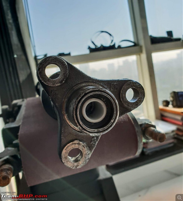

DIY Jobs Undertaken : CSB Replacement !

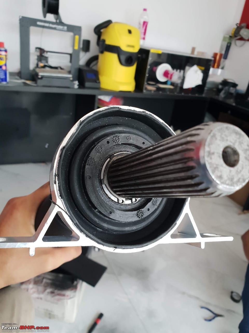

Driveshaft Centre Support Bearing Replacement;
This bearing supports the center section of the drive shaft.
The CSB required a full overhaul due to previous misalignment of driveshaft which was out of balance causing out of specification rotational stress on the CSB which is a delicate bushing that can rupture very easily.
The CSB jobs required exhaust removal, transmission and differential cross-member removal and finally removal of the flex-disc (Guibo) which was also replaced.
This was one of the most difficult jobs attempted as a DIY. IIRC the car was on jack stands for well over 24hrz;

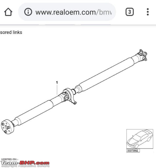

We took our own time to remove the driveshaft, bring it to one of our offices have a good look at whats going on;

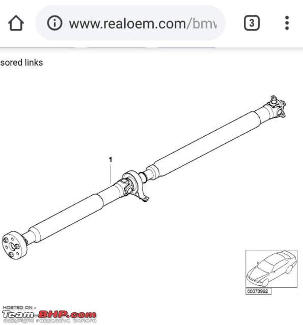

Referring to websites such as RealOEM helped a lot;

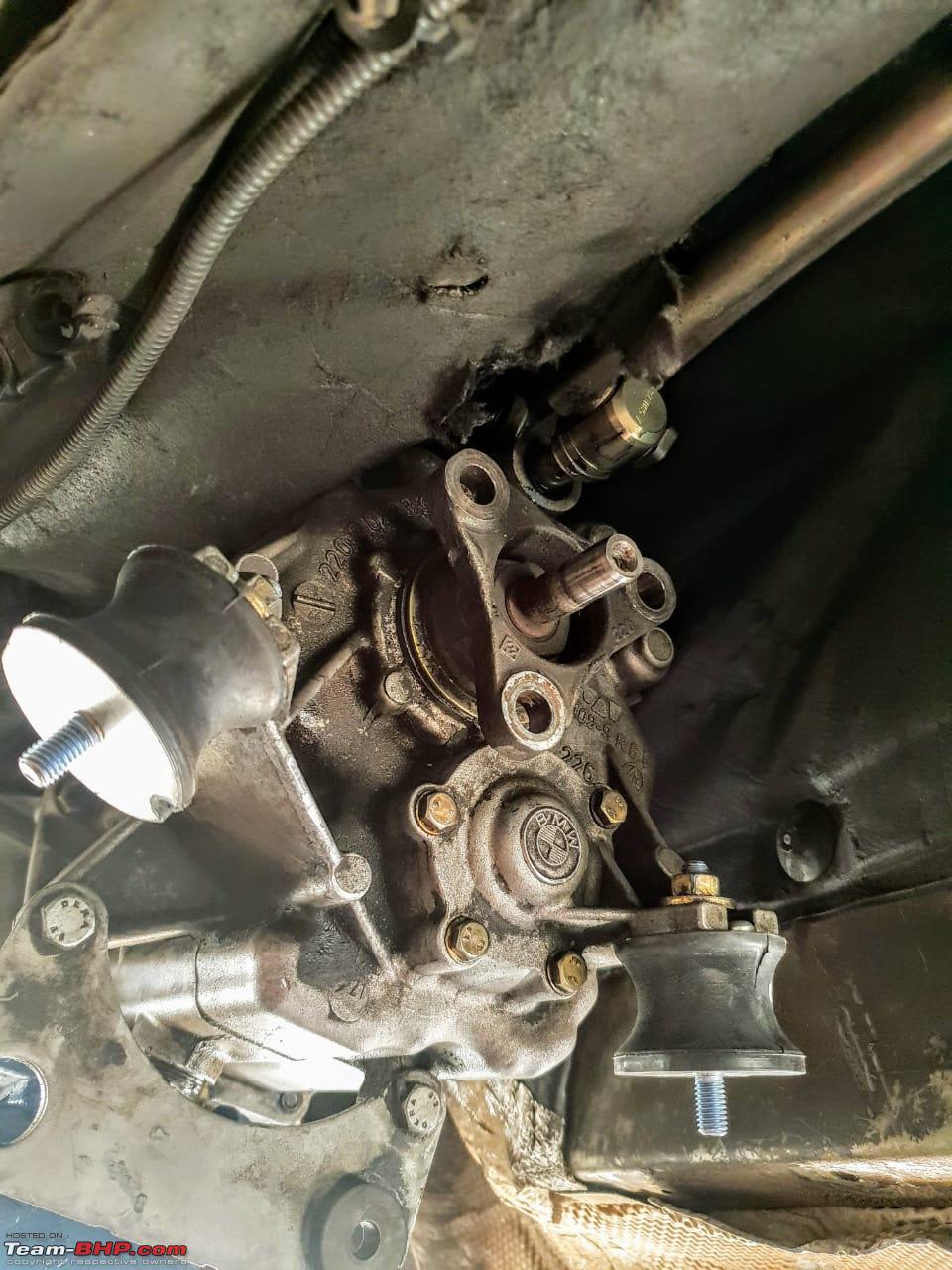

Gearbox Mounts Replacement;
During the CSB job (Described in Post #3), access to the transmission mounts was extremely simple and made sense to be replaced as well.
This is a very tricky job as the new bushings are not compressed and need external force to be compressed by using a jack for proper alignment.

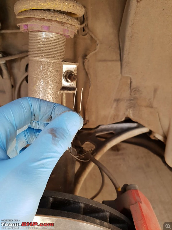

DIY Jobs Undertaken: Brake Pad Wear Sensor Short
Brake Pad Wear Sensor Light Solution;
This was a simple workaround to eliminate the brake pad light on the dash by shorting the wear sensors on the from left and rear right of the vehicle.

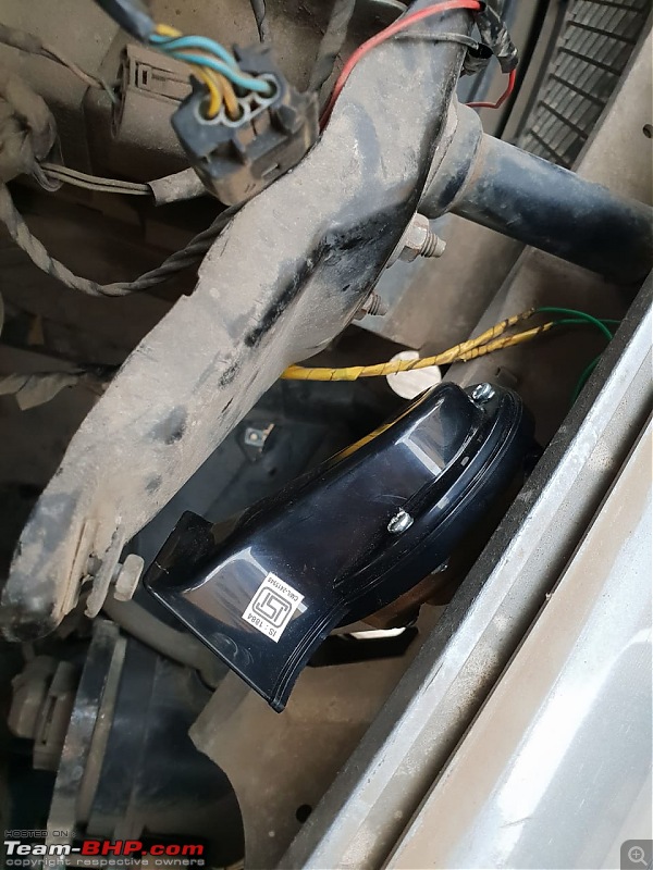

DIY Jobs Undertaken: New Horn
New Horn Install;
Was a relatively easy fix but the headlights & a few other components had to be removed to replace the horn.
The OE horn lasted till upto 2019 which is approx 18 years considering its a MY 2001 Car
A similarly German sounding horn by Roots was installed;

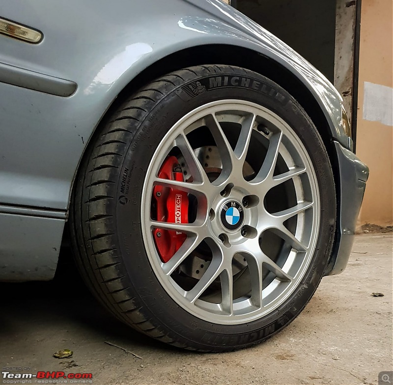

New Lug Bolts;
The E46 uses a 17mm lug dimension for the wheels;

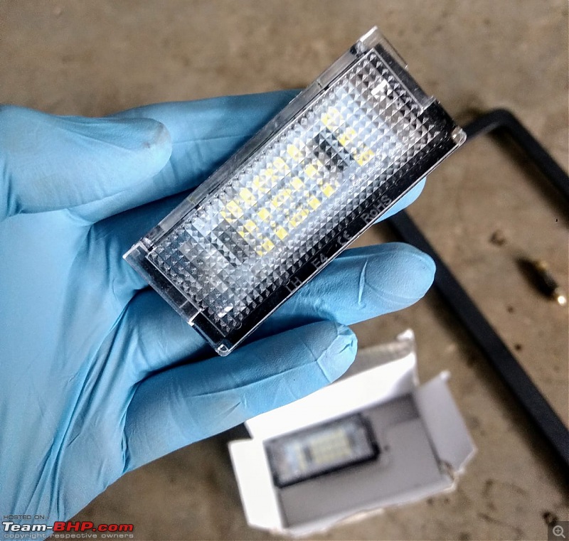

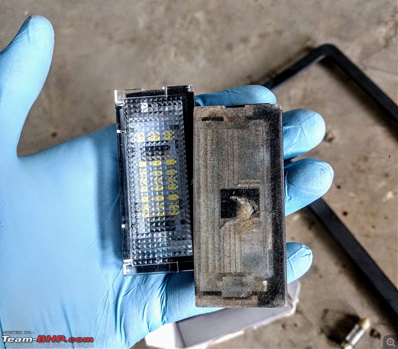

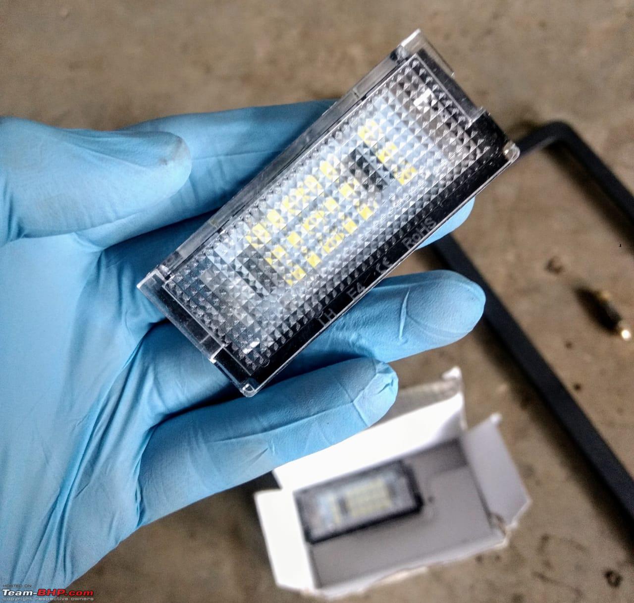

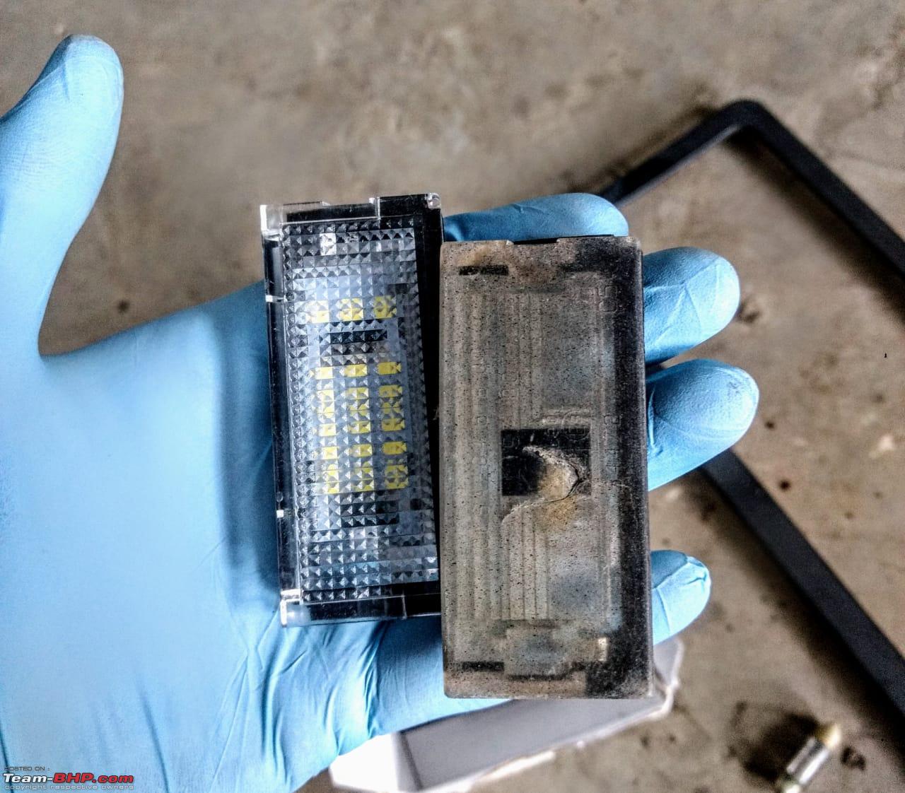

New Number Plate LED Lights;

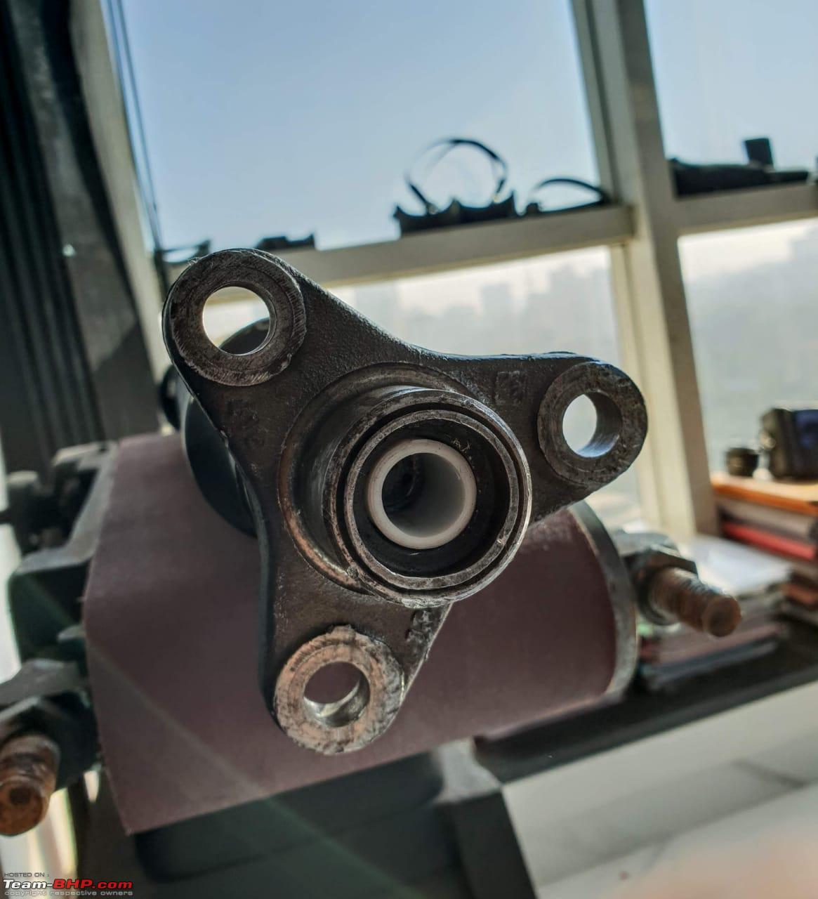

Role of My 3D Printer.
3D Printer;
The Role of a 3D printer was required on a few instances. Thankfully we have a few 3D printers readily available.
During the job (Post #3) of the Centre Support Bearing replacement we noticed a bushing between the output shaft of the transmission and the driveshaft had perished from polymer degradation.
So we custom made the same part in CAD & later 3D printed it;
^ The material used was TPU.
^ finally went in perfectly

If you need to compress the gearbox mounts to fit them - either your engine mounts have compressed due to age or if you had new engine mounts installed they stretched when you removed the transmission rear bracket and did not support the gearbox. I have done multiple transmission mounts on E46's and did not need to compress them in any car.
Also, these work very well: https://www.rogueengineering.com/Rog...nts_p_137.html
You're right, the engine mounts need a change.
