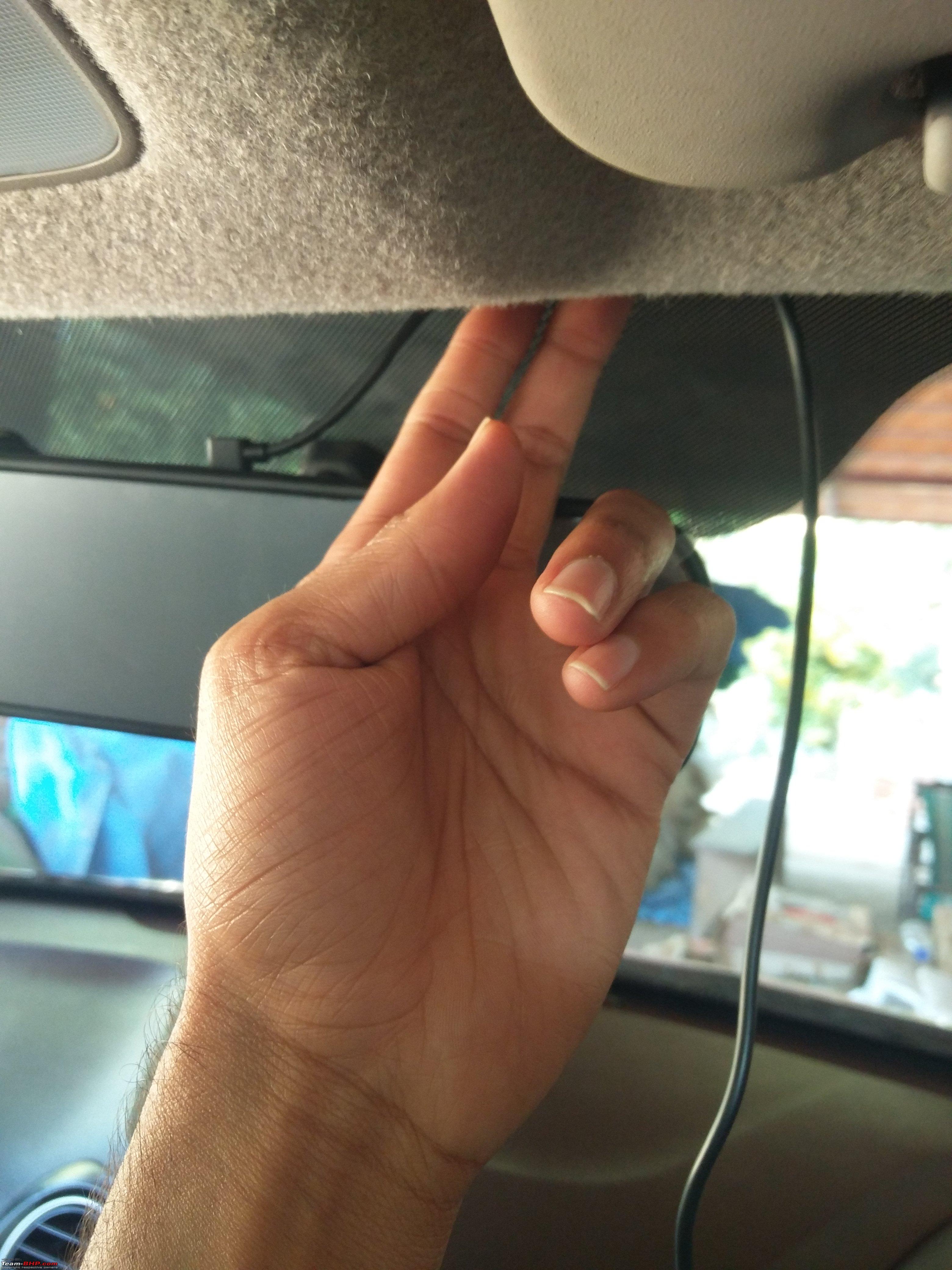

After installing the mirror, hide the power supply cable under the roof liner using the supplied pry tool.
70mai Rearview Mirror Dashcam - Installation and observations-pry_tool.jpg70mai Rearview Mirror Dashcam - Installation and observations-roof.jpg

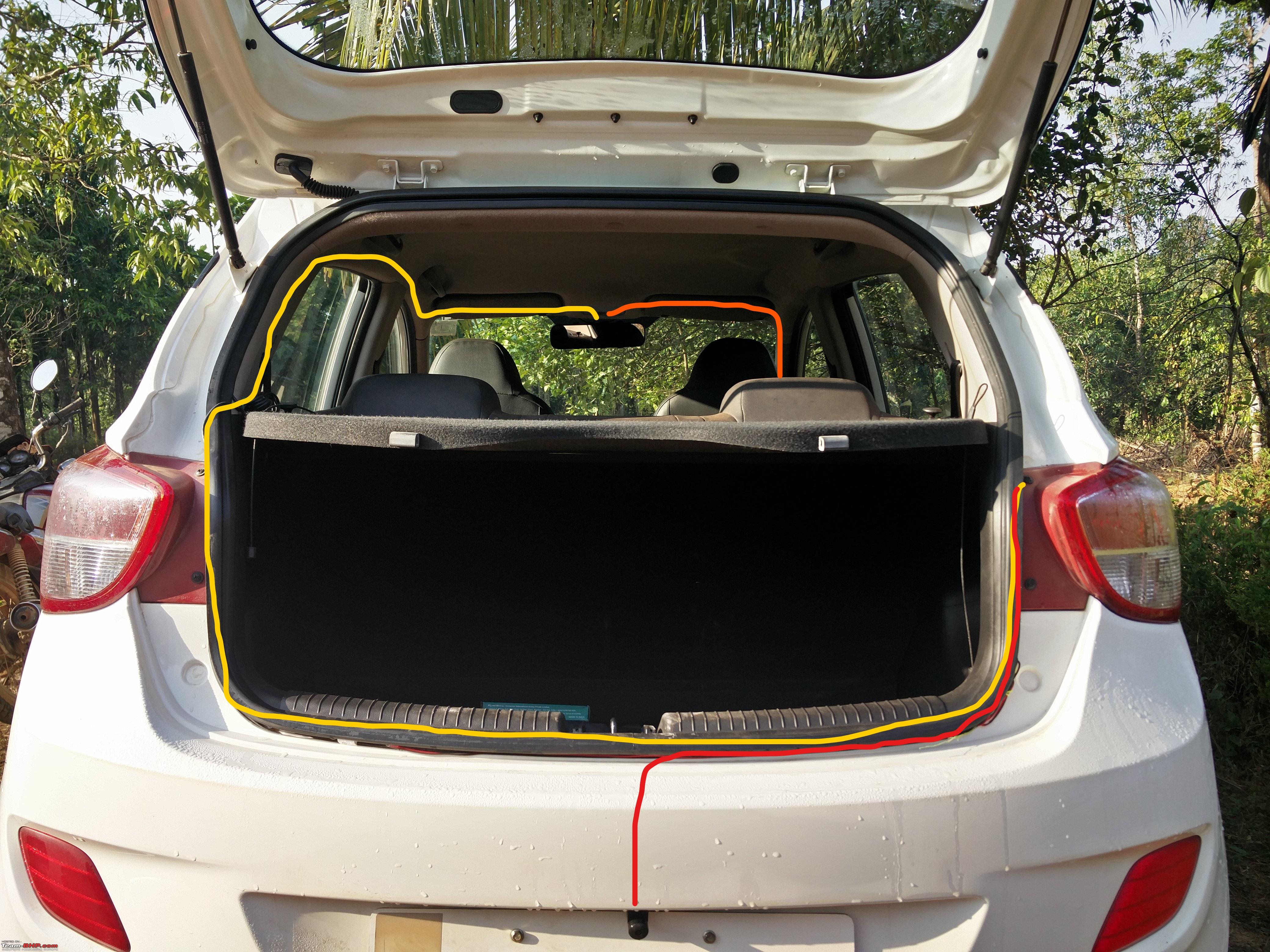

To install the rear camera module, plug the cable into the mirror and run the cable towards the back of the car.
70mai Rearview Mirror Dashcam - Installation and observations-img_20200201_105438.jpg
Connect the rear camera module to the reversing light. This powers the camera when reverse gear is engaged.

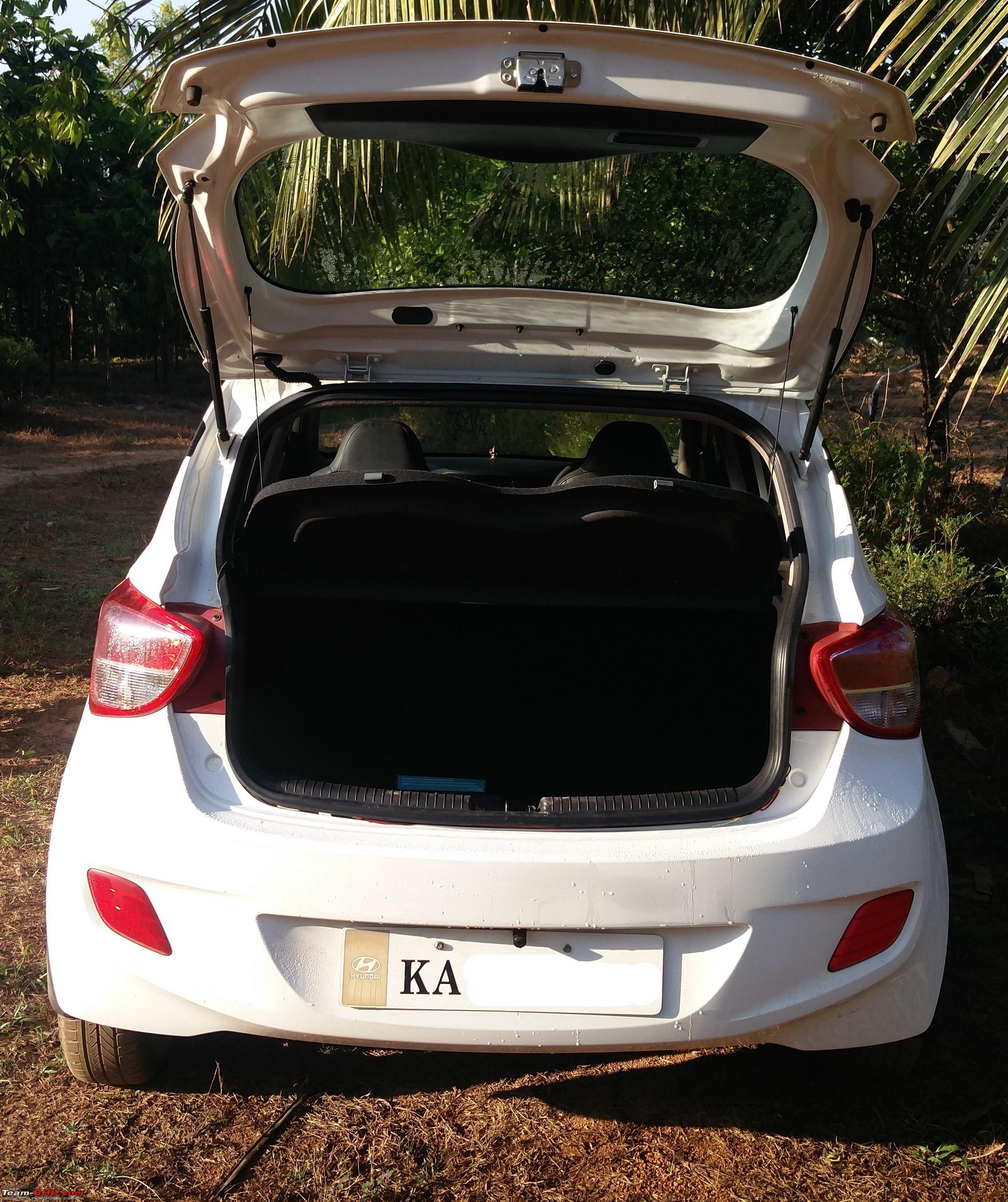

The reverse camera is mounted above the license plate. I found this spot to be ideal to provide a great rear view while reversing. The camera is waterproof and it is safe to place it here.
70mai Rearview Mirror Dashcam - Installation and observations-reverse_camera.jpg
The cable are concealed under the roof liner and trim pieces.
