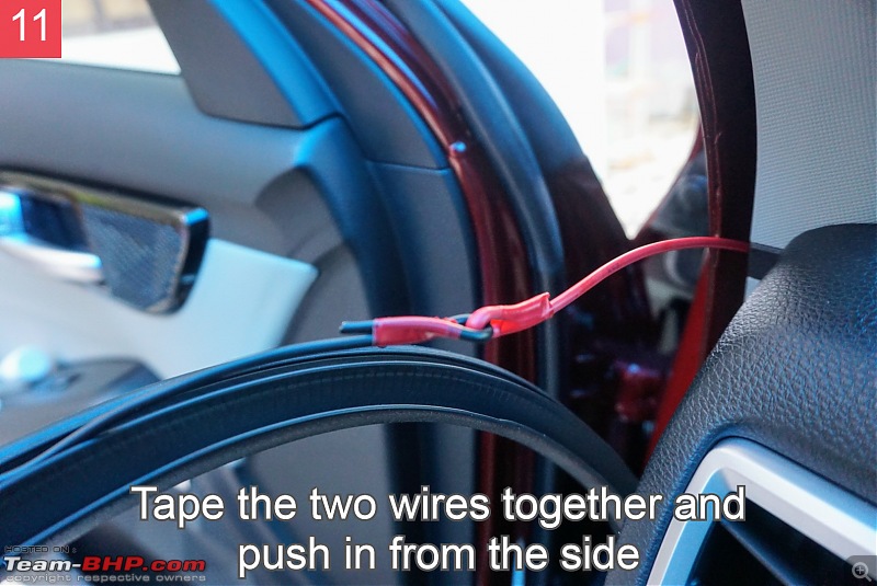

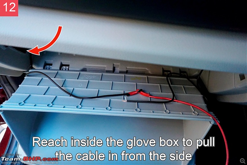

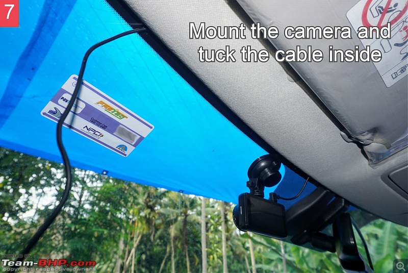

The installation process is as below
DIY: Kia Seltos Dash Cam Installation-3.jpg

Any specific reason to cut the cable?
At least in the few cars that I installed dash cams never faced any such issues.

The micro-usb plug was thick and L-shaped (second picture). I couldn't push it from under the glovebox. Could also have used the guide wire to pull it up. But, cutting it seemed to be the easier approach. Moreover, this doesn't have any warranty. And I was sure there would be only two wires inside.

Even I installed a dashcam in my seltos recently, I didn't have to cut any wires. I installed the 70mai pro.
One tip I would give you is install the camera closer to irvm and route the wire inside the irvm plastic holder. The plastic piece just pops off and clips back in with ease.

My power cable is directly connected to the cigarette lighter adapter. Other dashcams like 70mai have a USB A plug which could be disconnected from the adapter and wired without cutting.

Hi JothishX, was there any particular reason why you opened the rubber beading and tucked the wire under the A-Pillar instead of directly tucking the wire below the rubber beading itself?

I wanted a clean and concealed look as much as possible. With the wire under the beading, there is a chance of someone pulling out the cable accidentally where visible (especially my toddler). There was a slight bulge in the beading when tucked under it, could be an ocd though
