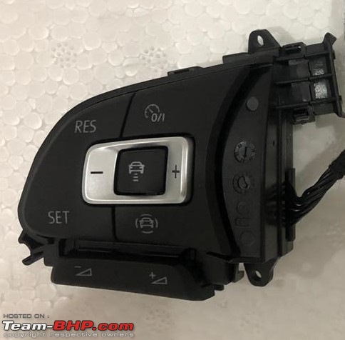

Originally Posted by viXit (Post 5012717)
Could you share pictures of these old and new buttons pls.
Your threads are always super fun to read!!
clap:
Hi Prithvi,
Here you go.
Old one:
DIY: Adaptive Cruise Control (ACC) retrofit on our VW Tiguan-oldctrl.jpg
New one (note the centre button, which is the difference):
DIY: Adaptive Cruise Control (ACC) retrofit on our VW Tiguan-newctrl.jpeg
