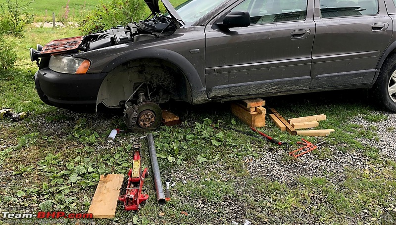

To jack up both rear wheels I place the jack under the tow hook. The jack is a proper Compac and welded together. Not the cheap ones from China made of profiled steel sheets. Spare parts are still available.
Good to be using a proper solid jack. But a jack is for jacking up a car, not for holding it up. No matter how solid, you really ought to be using axle stands and block the wheels (putting the car in gear is not sufficient either)
I did not use axle stands because I was never underneath the car and no heavy tools were used. The nuts were loosened with a tap of the hand and there was no rocking of the car.
I will not creep underneath the car even with axle stands. If I need to be under the car I will just go over to a friend and lift up the car.

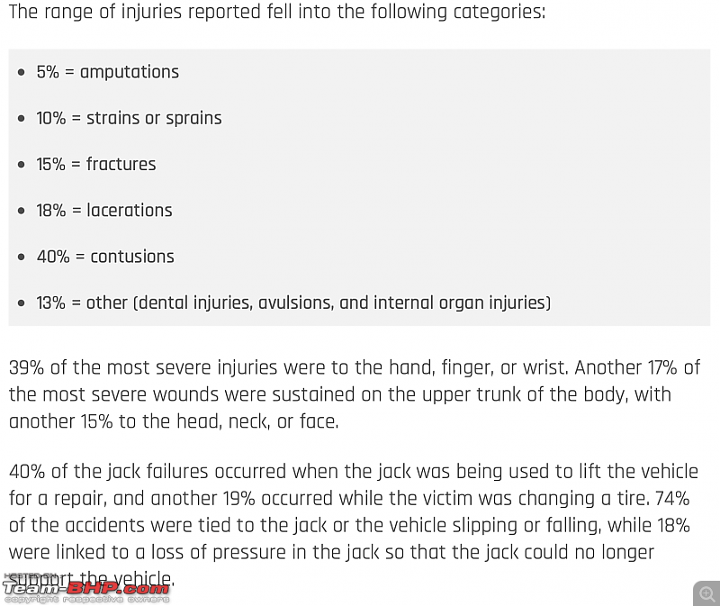

Unfortunately, all those lines have been used by people who thought just like you and ended up dead, or at least badly hurt.
Lets look at some sobering statistics, from the USA
The sample data was obtained from a specific group of hospitals. Our Houston jack failure accident lawyers point out that based upon the pattern of incidents, NEISS estimated that 4,822 people in the U.S. receive hospital emergency treatment in a single year for jack failure injuries. That’s almost 5,000 people injured by the simple act of jacking up a vehicle for repair.
DIY: Cleaning rusty brake discs, jugaad-style!-screenshot-20210421-7.45.24-am.png
Source: https://www.denenapoints.com/u-s-dat...ts-nationwide/
Interestingly some further research showed no women were involved at all. Whether this is due to the fact that women work less on cars, or are just smarter than men remains unknown. But my guess is both and they are often more risk averse.
Look at the injuries, the data suggest that most people were, just like you, not underneath the car, but next to it!

You and my friend made a common, yet very deadly mistake. When thinking about safety you approach it from what is unlikely to happen. Being safe is an attitude, a mind set where you try to minimise any potential mishaps or consequences of possible mishaps.
Almost 5000 people ended up in hospital in the USA alone. 40% related to doing some repair job. You know what, every single one of those guys used similar lines as you just did!

There was another case where a farmer hoisted the front of his car with a tractor and chain and the chain snapped while he was underneath. I dont know if he survived.
We wont agree so we have to agree to disagree. How many cars crash because of sandpaper on the pads and how many crash without? I always keep my distance of at least 3 seconds to the car in front when I drive. At least 5 in snow and more on ice. The last time I did an emergency braking was 4 years ago.
I must note that I am never alone when I have to use the jack.
When I replaced my front brakes in September, the old ones had lasted 110,000 km and about 5 mm remained of the old pads. This will give you a rough idea of my driving style and planning.
DIY: Cleaning rusty brake discs, jugaad-style!-ddsfall.jpg

Originally Posted by Indian2003 View Post
how cars crash because of sandpaper on the pads g.
You are making the same arguments. Safety is not about convincing yourself why something might not happen. Safety is about ensuring bad things don’t happen.
E.g. most of us will never ever super glue sandpaper to our brake pads. Hence, none of us will ever have an accident due to it.
Stay safe!
