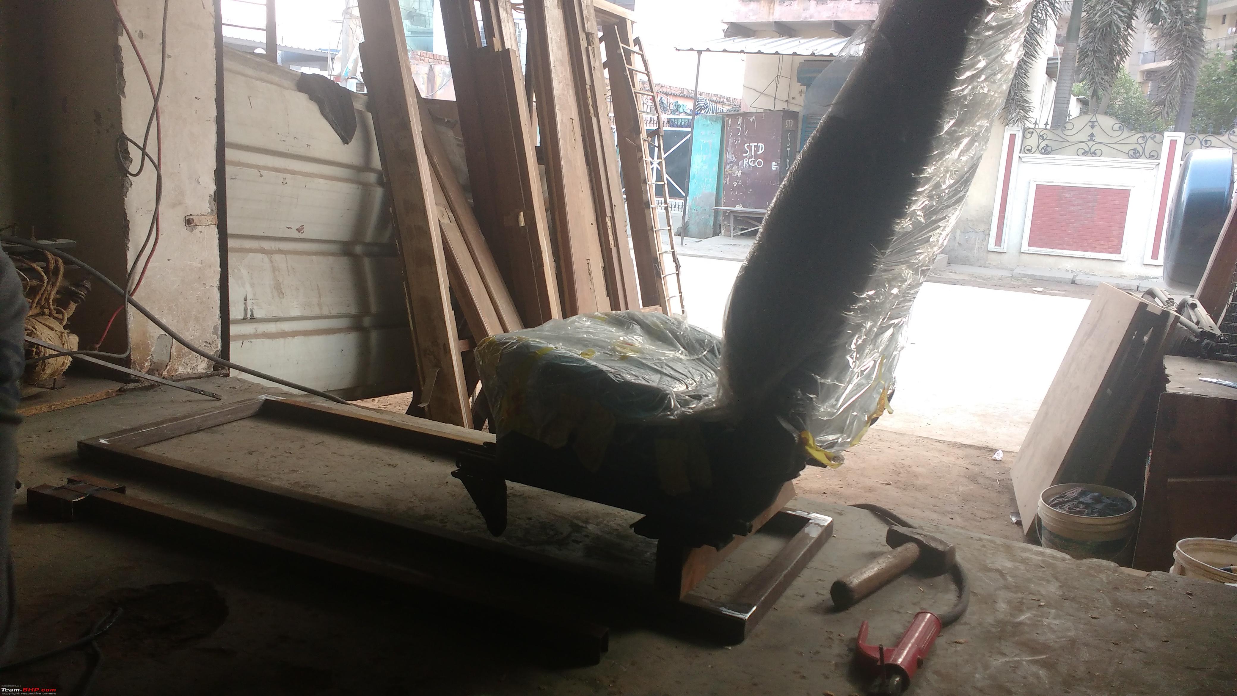

Post this procurement, the designing & fabrication of the body for the simulator started.
Firstly cut the dashboard in half in order to save space & make the setup compact
Secondly used a mild steel setup for the fabrication part & a checkered plate in the base (Pedal location)
Thirdly designed it in such a way so that the Screen can be swiveled 90 degrees so that it can be used other wise for playing other games as well when not on the seat.
DIY: My Racing Simulator Build-img_20180112_165348723.jpg
DIY: My Racing Simulator Build-img_20180112_202102388.jpg
DIY: My Racing Simulator Build-img_20180113_123232013_hdr.jpg
Post all the fabrication process, I gave it a good sanding & a spray of red oxide primer followed by black paint & clear coat.

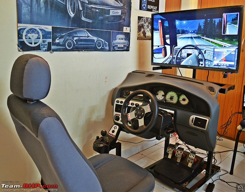

Installed a VU 32 Inch screen & connected the setup to my PS3 & Alienware
Also with help of a friend, connected the lights of the IC, Dashboard & the digital clock to a 12v adapter for better aesthetics.
Below are the pics of the completed project after installation in my room
DIY: My Racing Simulator Build-dsc_6240.jpg
DIY: My Racing Simulator Build-dsc_62433.jpg
DIY: My Racing Simulator Build-img_20180115_223732987.jpg
The ergonomics of the whole setup are definitely not the best (vs professional setups), but since it has been built as per my dimensions so I and even other friends of similar built are able to fit in easily & have a good experience overall & the best part I get to relive atleast some part of the old days of my Fiat Petra.

Total cost of the setup excluding the Play station & PC is around 75k

Unfortunately no, could only provide the backlighting as of now. I have seen a few people on international forums who have used CAN based VW speedos and made them work.
