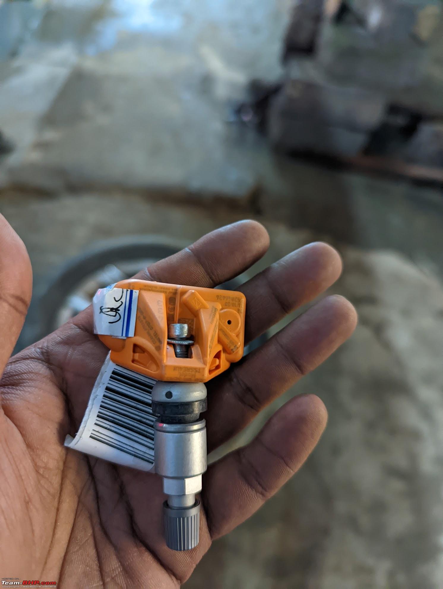

TPMS
This was by far the most time consuming and invasive process. [Not sure, if I will recommend, considering the vanity value]. It involved adding a new TPMS module under the boot, pulling the wires all the way to the cockpit and then connecting it. Then taking the car to a tyre shop and putting sensors on all 4 tyres, remembering the serials and coding the new sensors and setting desired pressure levels for different modes ( I chose 32, 34, 36, for Comfort, standard and full load).
VW Tiguan DIY | Adding Adaptive Cruise Control, Massaging, TPMS & Wireless Charging-tyre_old.jpg
VW Tiguan DIY | Adding Adaptive Cruise Control, Massaging, TPMS & Wireless Charging-tyre_new.jpg
VW Tiguan DIY | Adding Adaptive Cruise Control, Massaging, TPMS & Wireless Charging-tyre_cockpit.jpg
It took good half day to get done end to end, and after everything the pressures didn't update for a while, and realized it needs a few kms of drive to get calibrated.

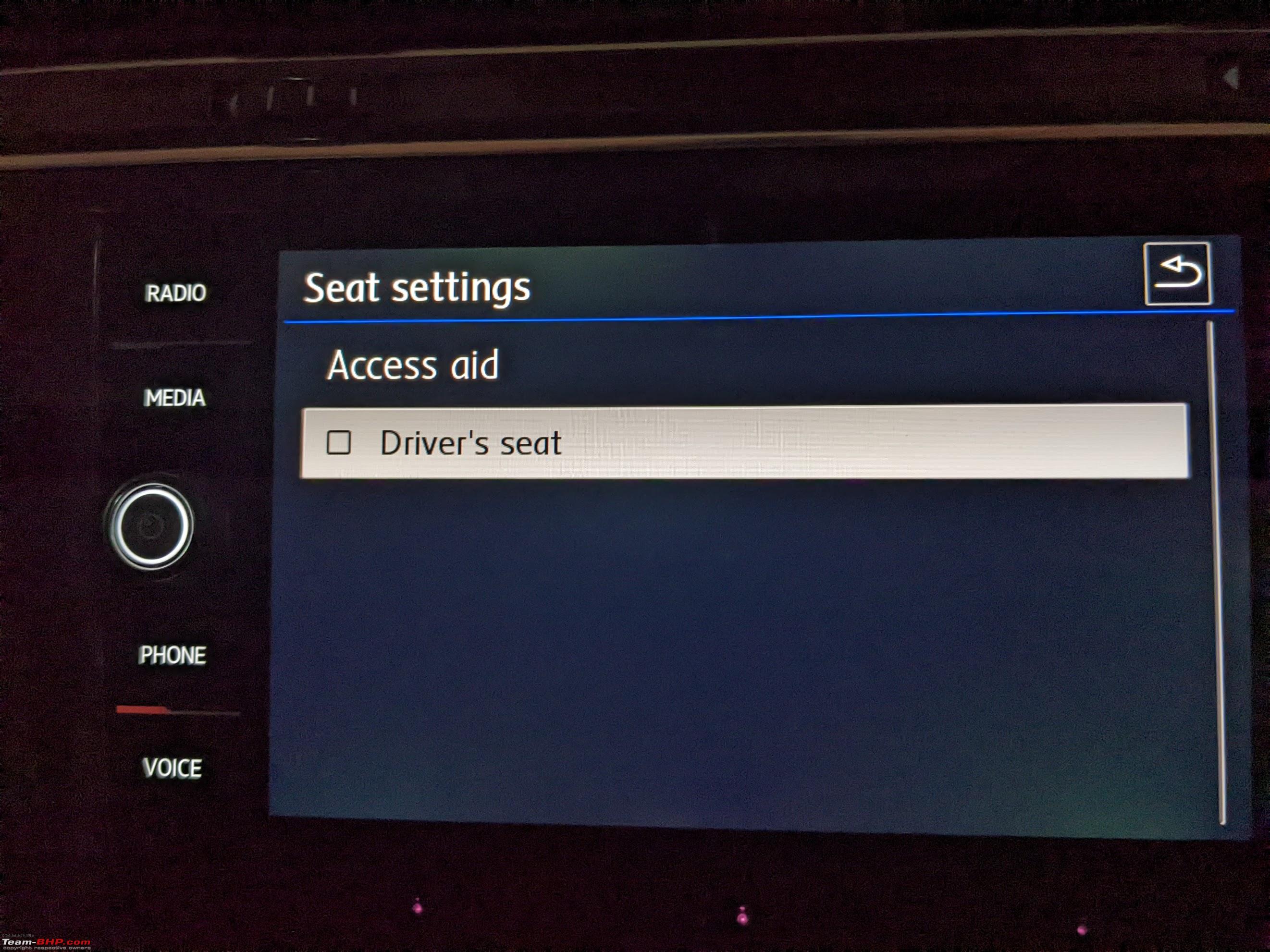

Massaging for drivers' seat
This was again a vanity, but something which makes the car really feel posh. I remember seeing this feature for the first time when a friend of my showed off this in his fancy high end BMW 2 seater. The process is simple, the car has electronic adjustment for lumbar support, you just swap out the controller, and then configure the 3rd seat preset button to activate massage. When triggered, it massages for 5 mins and then stops. Took 15 mins to swap the controller and add the coding.

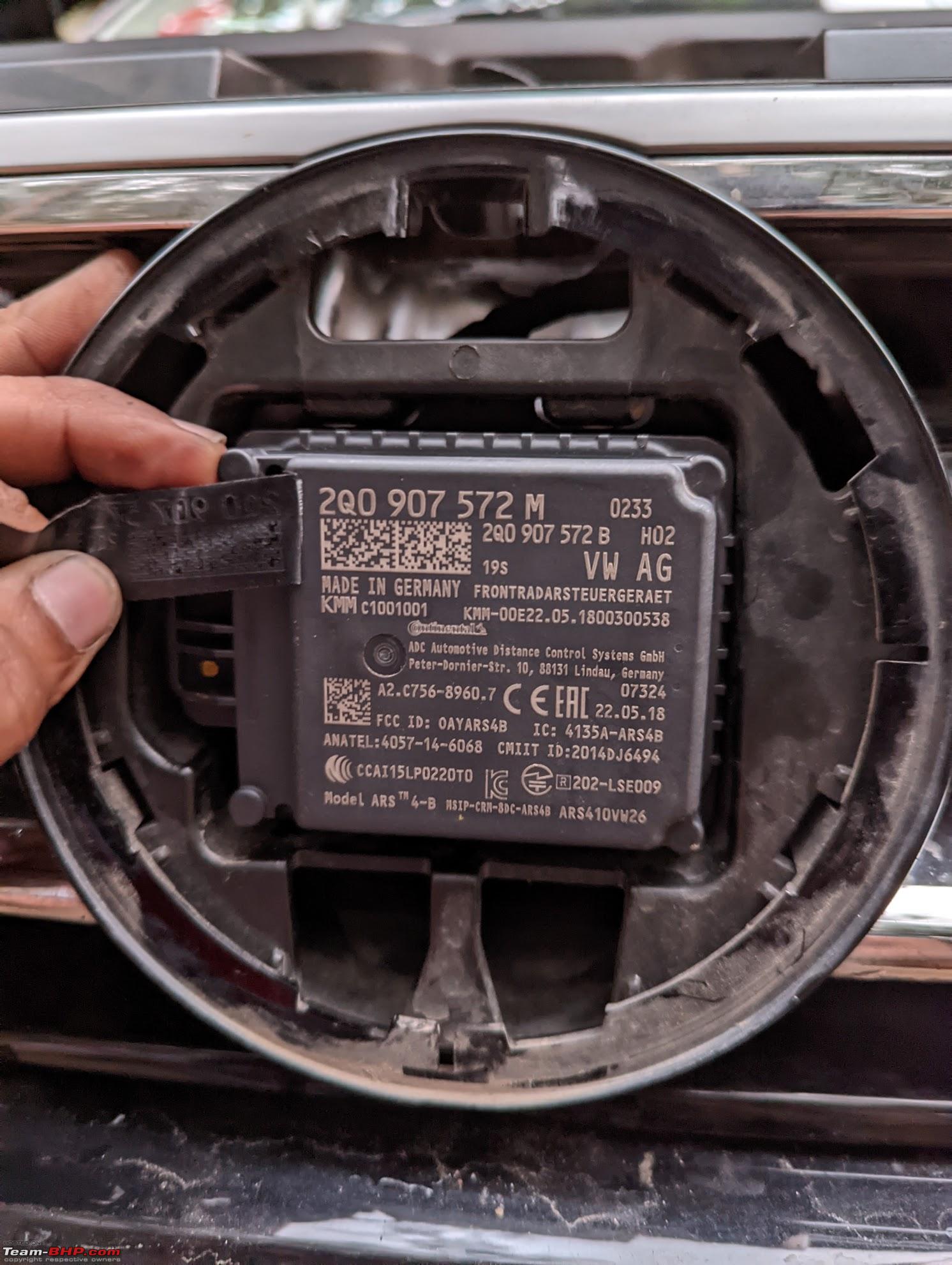

ADAPTIVE CRUISE CONTROL!!!
This was what it all started with. My quest for enabling ACC, which already has the necessary hardware. The modder gave me and option to switch to a new steering wheel (sporty VW) vs, swapping the ACC switch piece on my existing one. Considering the extra 40k price hit, I went for the switch swap. As he inspected the car, also suggested upgrading the radar module, the stock module could only support up to 150kmph, while the new one could do 220kmph. And since the 3rd generation Driving assist systems that Tiguan Allspace has comes with dynamic calibration, swapping out the radar won't create any issues. For the uninitiated the radar module hides behind the ceramic VW logo on the front grill.
VW Tiguan DIY | Adding Adaptive Cruise Control, Massaging, TPMS & Wireless Charging-old_radar.jpg
VW Tiguan DIY | Adding Adaptive Cruise Control, Massaging, TPMS & Wireless Charging-new_radar.jpg
This was the easy part. The next part involved opening the steering and swapping out the ACC buttons.
VW Tiguan DIY | Adding Adaptive Cruise Control, Massaging, TPMS & Wireless Charging-no_steering.jpg
VW Tiguan DIY | Adding Adaptive Cruise Control, Massaging, TPMS & Wireless Charging-open_steering.jpg
VW Tiguan DIY | Adding Adaptive Cruise Control, Massaging, TPMS & Wireless Charging-all_set_steering.jpg
This was a tricky process, unlocking the steering from the base, and then opening it, and swapping the switches. Was a nervous 90 mins or so. Once this was done, our guy plugged into the CAN port and starting coding, after another 60mins or so installed the license, calibrated everything and it was good to go.
VW Tiguan DIY | Adding Adaptive Cruise Control, Massaging, TPMS & Wireless Charging-acc_cockpit.jpg
VW Tiguan DIY | Adding Adaptive Cruise Control, Massaging, TPMS & Wireless Charging-acc_cmenu.jpg
[VW Tiguan DIY | Adding Adaptive Cruise Control, Massaging, TPMS & Wireless Charging-acc_menu.jpg
The whole mod affair took almost a full day, and mostly the delay was because of some lack of planning. The car was in our apartment basement, we needed to get it to a open, well lit place to be able to work on. Then we realized we needed a good internet connection and power point to connect the laptop. Downloading and backing up the entire firmware took a lot of time, with choppy mobile data and connection drop off. We started in the morning, but the car was ready to be coded only by 6pm. Eventually everything got done by 1am. Lesson learnt.

So, the whole crux of what I did was to get this one single feature. As soon as our car was ready (at 1am) we left to Chennai (from Bangalore), we were supposed to leave by evening, but since this all took time, we ended up leaving really late.
ACC took maybe around 30 mins to get used to, after that it was bliss!! It was almost surreal to the car working its way through the high way with ACC and lane assist. In the beginning your muscle memory does not let you let the car take control, but over a period you start trusting the car for slowing down and speeding up. [NEVER EVER took this lightly, was still alert all the time). From Chennai, next day we went to Trivandrum (another night drive). Along this 1000km+ in the 48 hours, we drove mostly using ACC, and maybe 2-3 times car switched to emergency braking instead of following the vehicle on front. I got a little scared, then realized, at night when there is a truck with no rear lights or even reflectors, car was not considering it as a vehicle but an obstacle (this is my inference).
The biggest change in the driving post ACC was, we did not drive beyond 90kmph, but still had a very high average speed (55-65). Overall, we were reaching destinations faster, even though overall drive was relaxed. I was told ACC would bring down mileage, but I attained never been seen mileage ranges post the mod.

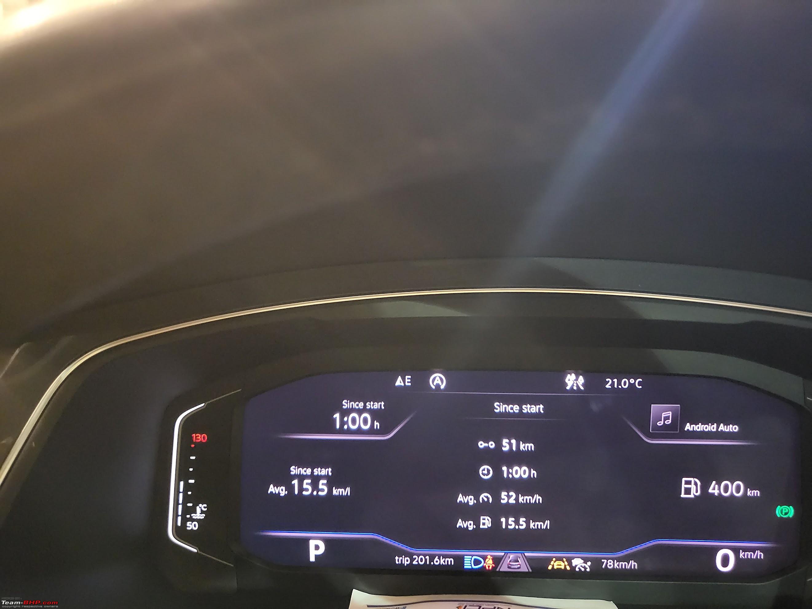

VW Tiguan DIY | Adding Adaptive Cruise Control, Massaging, TPMS & Wireless Charging-new_cockpit1.jpg
VW Tiguan DIY | Adding Adaptive Cruise Control, Massaging, TPMS & Wireless Charging-after_drive.jpg
After our 1000km+ drive.

What I couldn't figure out was, when I removed the original valve, it didn't have any sensors on it, so I am curious to know how it was detecting drop in pressures.
Think this is a TPMS that is similar to the one in my 2010 Superb - which used the ABS sensors to detect changes in rotational dimension and then give a warning asking you to check air pressure. After getting used to a proper TPMS which shows pressures in my X3, I must say this is the feature I miss the most - even if I would never go through all the pain you went through to retrofit this. I believe there are some third party solutions which replace just the valves and link through Bluetooth with a phone app - not sure if anyone has tried that option. That may be a superior solution to this one.
