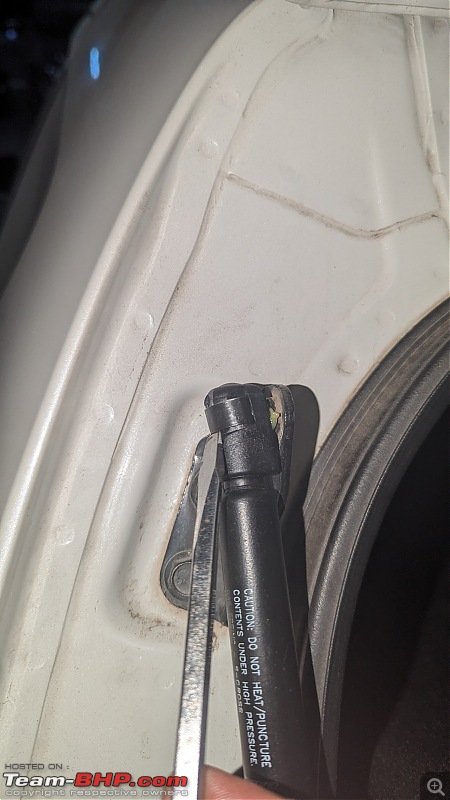

  3. Using a flathead screwdriver, pry open the locking clips on one side of the strut.
  4. Pull the strut out from its ball joint. (Note: The moment you do this, the tailgate is free and the weight is supported by your friend)

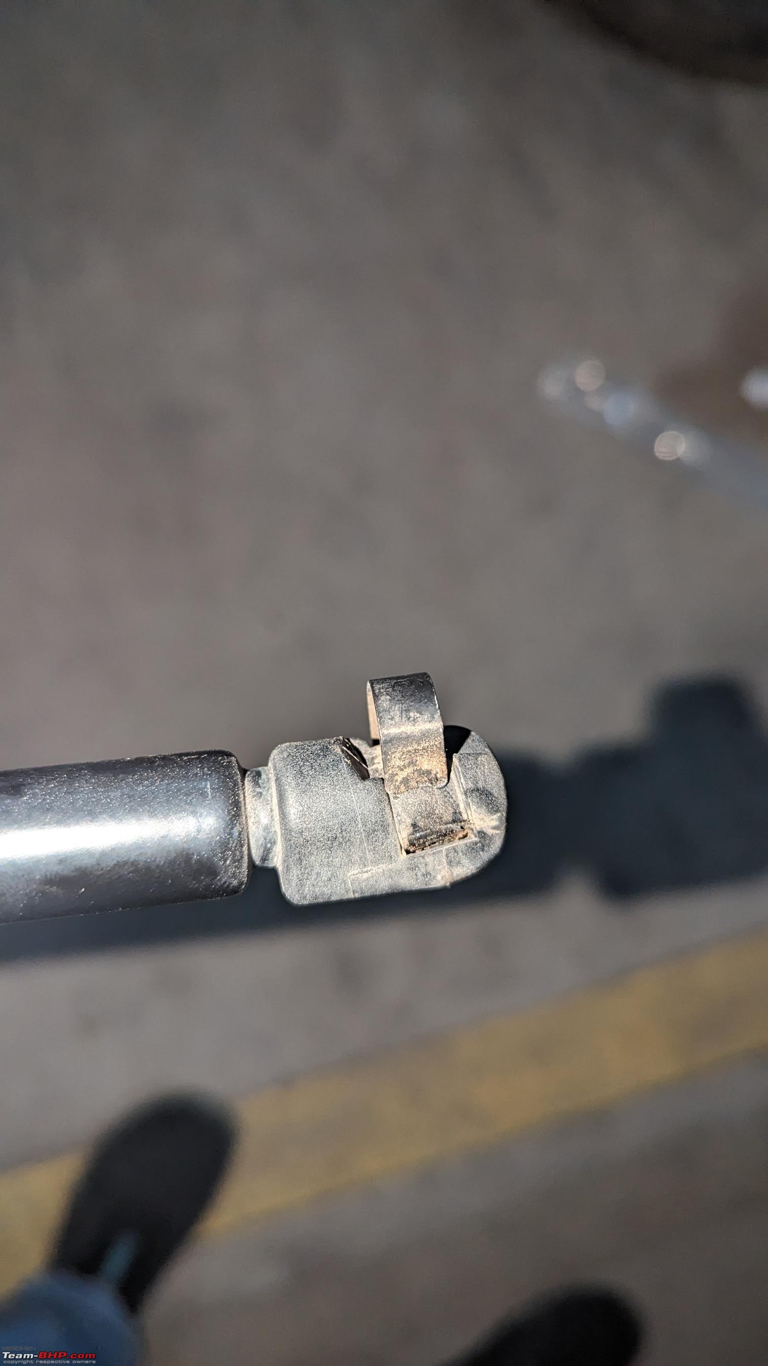

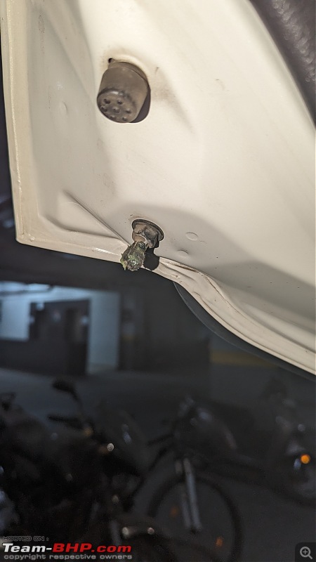

  5. Clean and grease a bit for smooth operation.
  6. Open the new gas strut and push insert the side that corresponds to the side you just removed. This is important. You should not interchange the sides.

DIY: Replacing the gas struts of the rear hatch / tail-gate-prying.jpg
DIY: Replacing the gas struts of the rear hatch / tail-gate-struthead.jpg
DIY: Replacing the gas struts of the rear hatch / tail-gate-pxl_20230402_085327844.jpg
