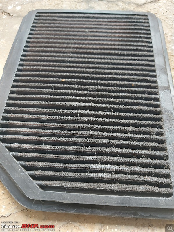

The dirty inlet side of the dirty filter - note more clogging towards the taper end
DIY: K&N Filter Cleaning-kn_filterinlet1_dirty.jpg
DIY: K&N Filter Cleaning-kn_filterinlet2_dirty.jpg

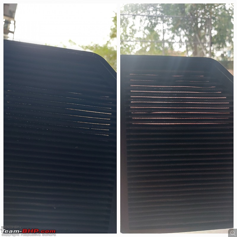

Clean filter against light
DIY: K&N Filter Cleaning-cleanfilter_againstlight.jpg
Before vs After - at the same place against same light
DIY: K&N Filter Cleaning-knfilter_before-n-aftercleaning.jpg
Summing it up
1. Based on driving conditions, the filter would need cleaning anywhere between 12,000 and 20,000kms.The first tell tale sign is a drop in pick up and an increase in fuel consumption
2. Personally, I think I did a more thorough job this time than last time. The filter wicks showed so.
3. The process of cleaning and oiling is quite a pain - takes close to 1.5 hours to clean, overnight to 24 hours to dry, and another about an hour to oil. But this task forces one to squat, and helps in getting one's joints oiled.
