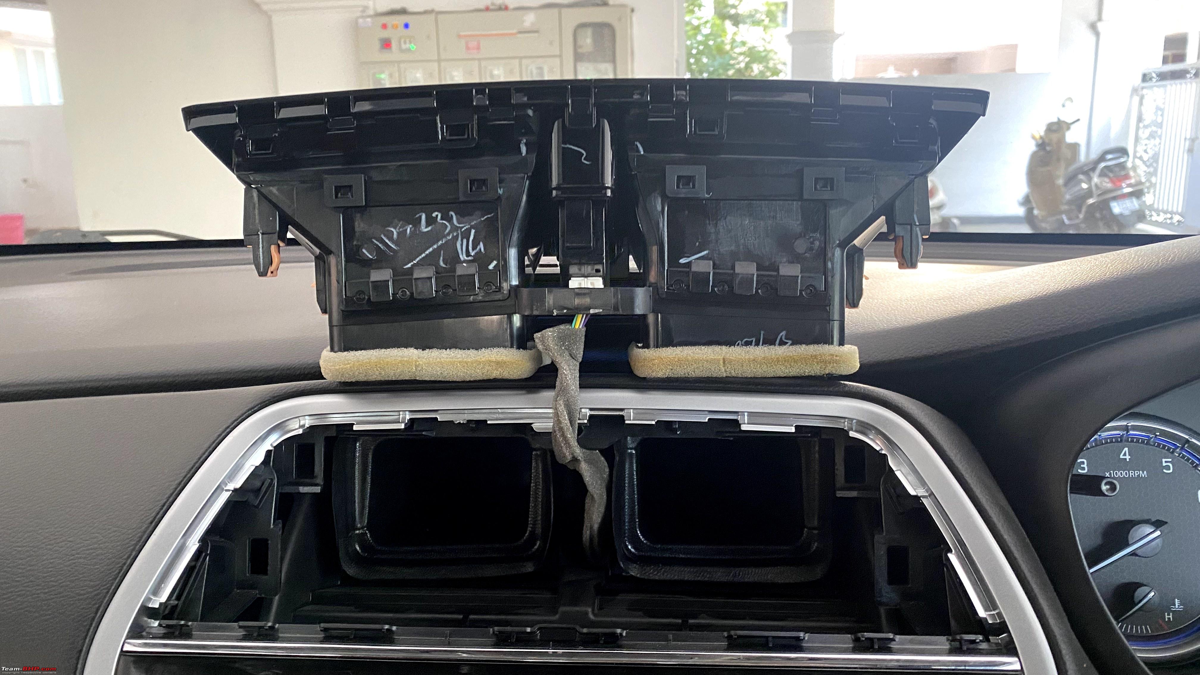

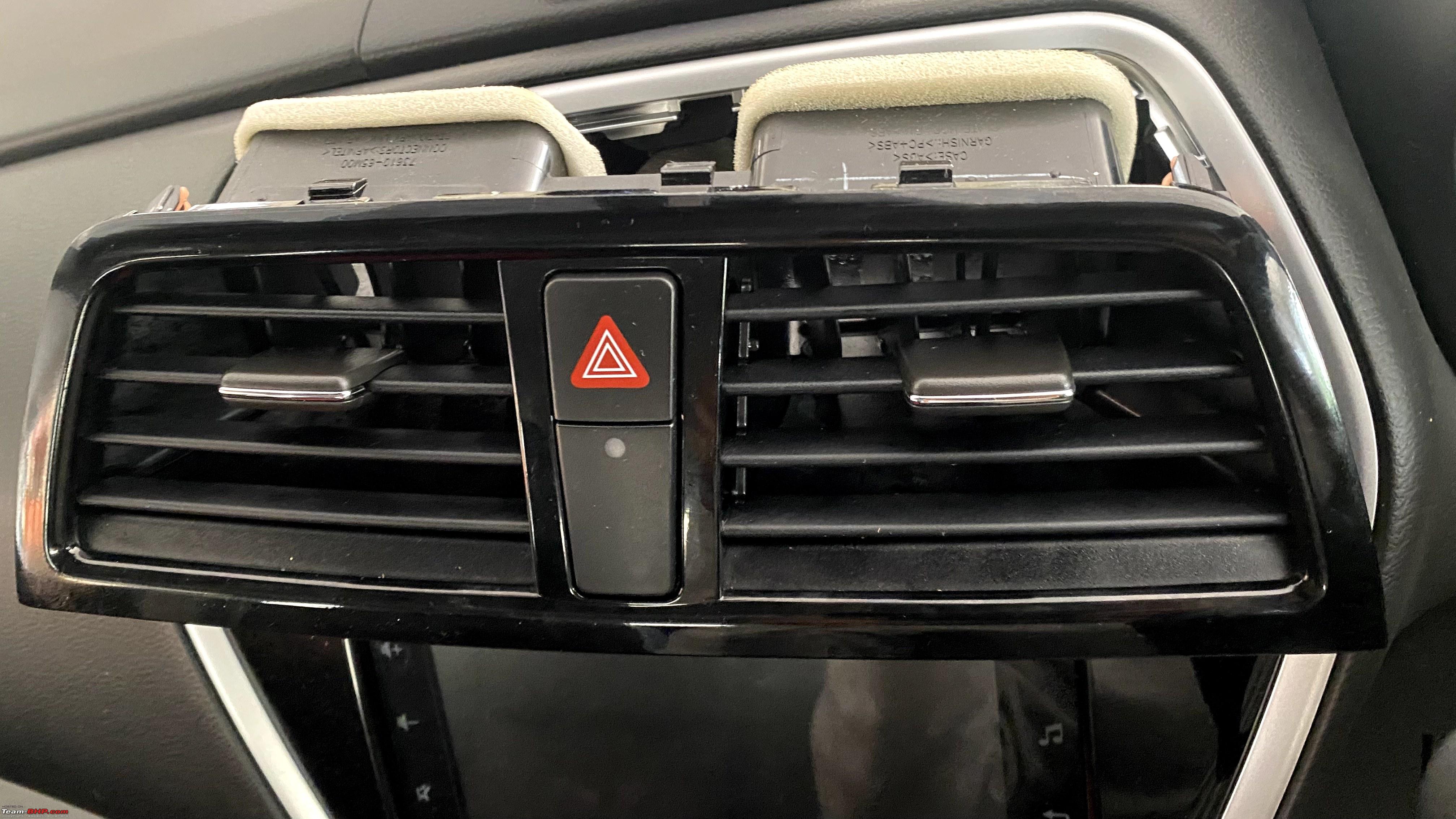

Sharing few images of the work below -
DIY: Stopped the AC vent rattling noise in my Maruti S-Cross-acventopen.jpg
DIY: Stopped the AC vent rattling noise in my Maruti S-Cross-acventopen2.jpg
After the vents were opened
DIY: Stopped the AC vent rattling noise in my Maruti S-Cross-opnvent.jpg
DIY: Stopped the AC vent rattling noise in my Maruti S-Cross-opnevent2.jpg
DIY: Stopped the AC vent rattling noise in my Maruti S-Cross-fram.jpg
After opening i was searching to see any hanging coupler which was making sound or any frame but everything looked good. On a sad note I was about to repack everything then I saw the AC vent section. I tried to shake the left one, there was no sound; it had a good space to avoid hitting the surrounding portion.
I tried the same approach on the right one, BINGO I have the culprit !!
DIY: Stopped the AC vent rattling noise in my Maruti S-Cross-culprit.jpg
Same sound when you shake the right one. It was hitting the dashboard when I was shaking it.
DIY: Stopped the AC vent rattling noise in my Maruti S-Cross-closerlook.jpg

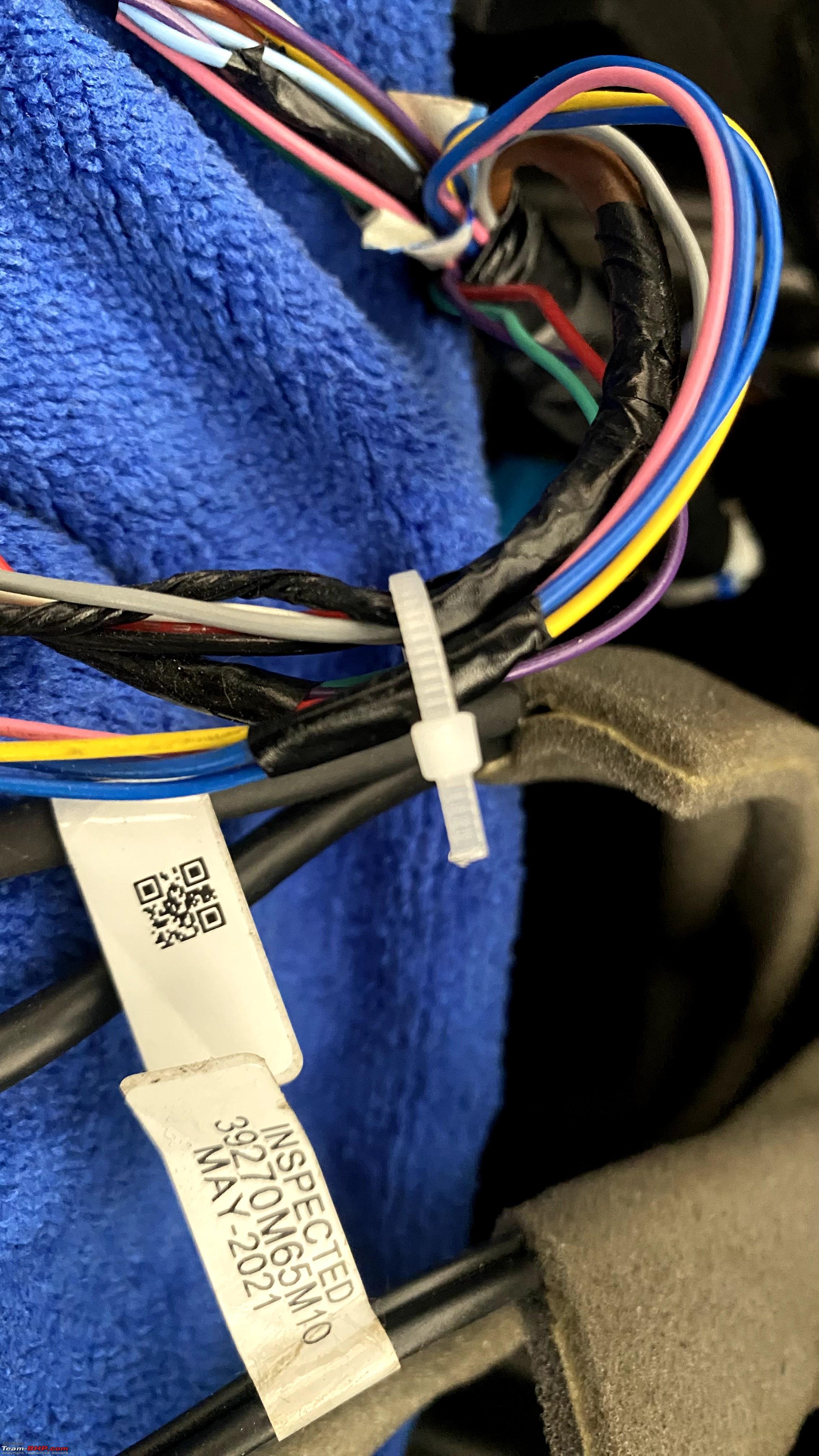

I added extra foams around all the sections of the vent and re-packed everything. I wrapped paper tape on all the locks and tied up some wires to avoid future rattling.
DIY: Stopped the AC vent rattling noise in my Maruti S-Cross-finalpacking.jpg
DIY: Stopped the AC vent rattling noise in my Maruti S-Cross-papertape.jpg
DIY: Stopped the AC vent rattling noise in my Maruti S-Cross-tie.jpg

1 week observation - No sounds on all the three conditions observed above. So far so good.
Note - Re-packing of AC vents needs a bit of trick and hard. Be careful around it.
