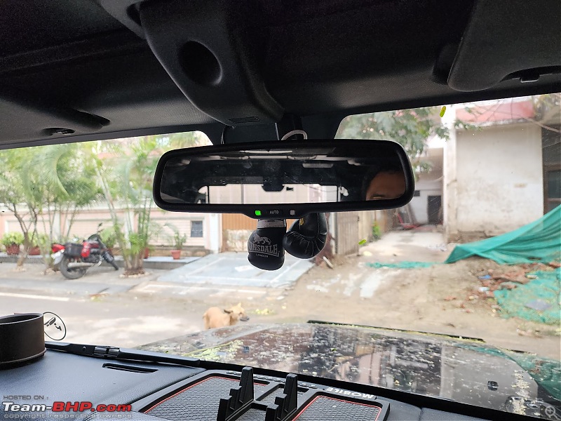

Fed up with the vibrations and the off-angle for the IRVM when one toggles between day and night modes (which somehow every other OEM has mastered, right from my humble Santro Xing of yesteryear), I decided to overhaul the OE mirror and go with a Maruti automatic day/night IRVM.
DIY: Fitting an auto-dimming IRVM in a Mahindra Thar-close-up-.jpg
DIY: Fitting an auto-dimming IRVM in a Mahindra Thar-wide-.jpg
The culprit - a shaky OE mount system with no way for one to tighten the socket. Other brands may either have a self-fastening solution or one with a screw.

Project costs - 4k mirror + 100 mirror cover + 350 wiring harness + some coffee (optional)
The results are pretty OK for a cold-hands attempt (NOIDA- it just rained today, and it's a cold and windy Winter) with eye-balled measurements to trim the upper mirror cap (hides the harness.)

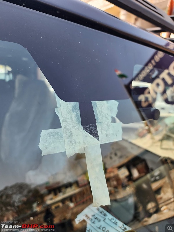

1. Day 1 - Placed a sourced mirror mount with urethane on the windshield. Covered the gap with some extra to give a smooth OE look. Sadly, I had to undo all the excess adhesive later since the mirror didn't fit neatly. However, better planning and 5 minutes of effort later this could have looked better! There was a choice of taking off the OE mount but the risk outweighed the benefits. I decided to place the new mount next to the OE mount at the advice of the windshield professional. Some masking tape kept it against the glass. I read that curing time can go up to a week during the cold. I do not dispute it at all.
