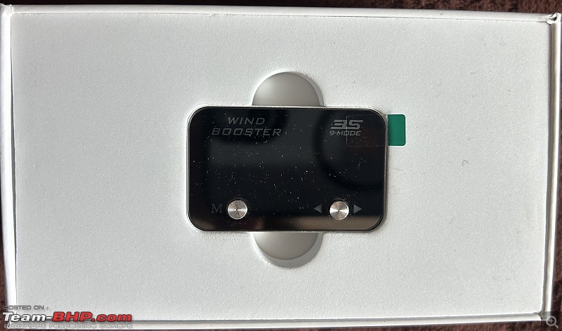

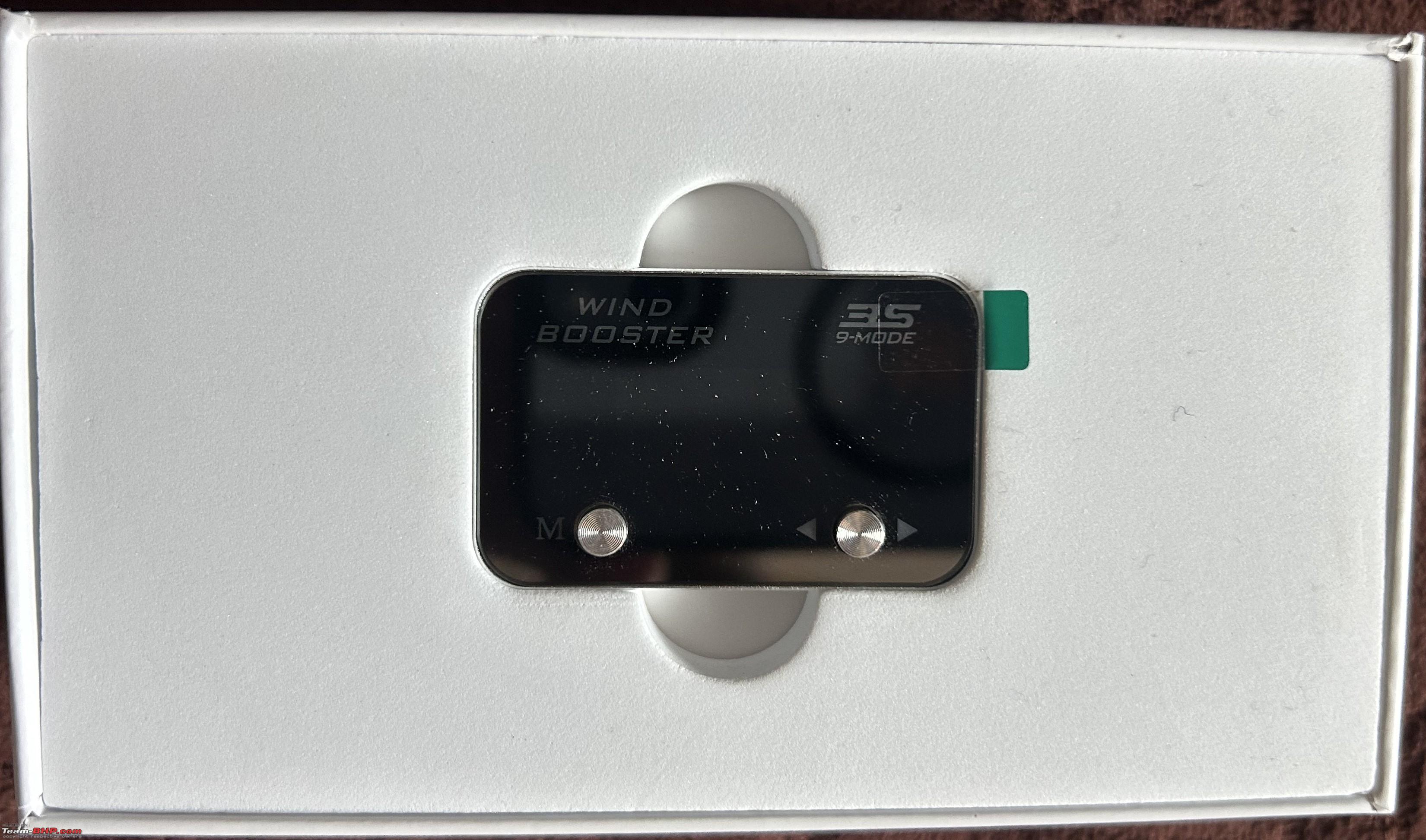

Windbooster Models: This was a bit confusing, and I wasn’t sure. Windbooster Throttle Controllers are available for different make/model of cars. There are at least 5 different models to choose for my Fortuner, starting with 7-mode entry level model, 5-Mode model, 3S model with 6 modes, 4S model, and their top-of-the-line GT model (with mobile App and BT connectivity). I was curious about their GT / 4S models having Throttle Lock, but with unknown potential complexities decided against it.
Finally went with the mid variant option of 3S model, and the specific version for my Fortuner make/model (IB3S161L). 3S comes with 6 different modes – Normal, Eco, Sport, Sport+, Race, i-Auto. 10 levels of Throttle Adjustability are available for Economy, Sport, Sport+ and Race modes.
Buying Experience: During the research, I saw couple of options available across India, Delhi and Tamil Nadu dealing with Windbooster Throttle Controller. They varied with their prices and warranty offers. Prices varied from 17.5K INR to 27K INR, with 5 years or 2 years warranty. Some of them also offer 15 days trial periods and return in case we don’t like the product.
Their website (https://windbooster.com.au) was running 50% sale during October 2024, so we decided to go with this option as this will work out cheaper compared to the dealership prices. Duty amount on the purchase was unknown at that time, and even with 100% duty, it would work out less than these dealership prices.
Purchase (14K INR): Windbooster Australia Website discounted price was 124.5 AUD. Shipping via UPS cost 27 AUD. Including Conversion charges, Duty and Disbursement fees I spent approx. 14K INR. Entire order, shipping, tracking, delivery process was smooth. During the Duty processing I would have missed their calls assuming them to be Scam/spam calls from courier guys, but later received their email for KYC processing and confirmation.
