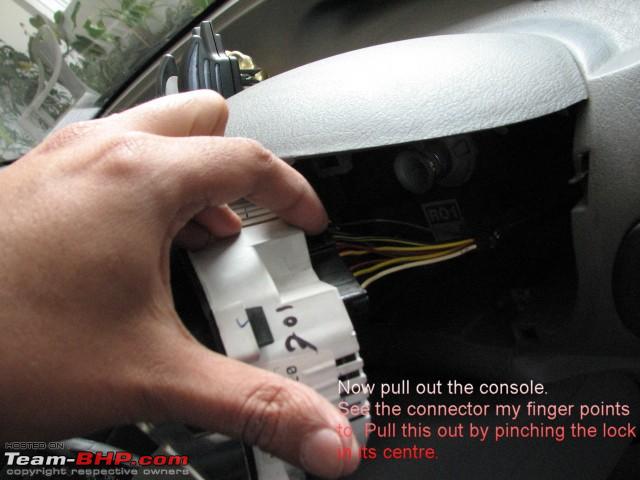

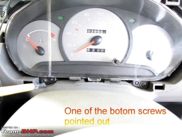

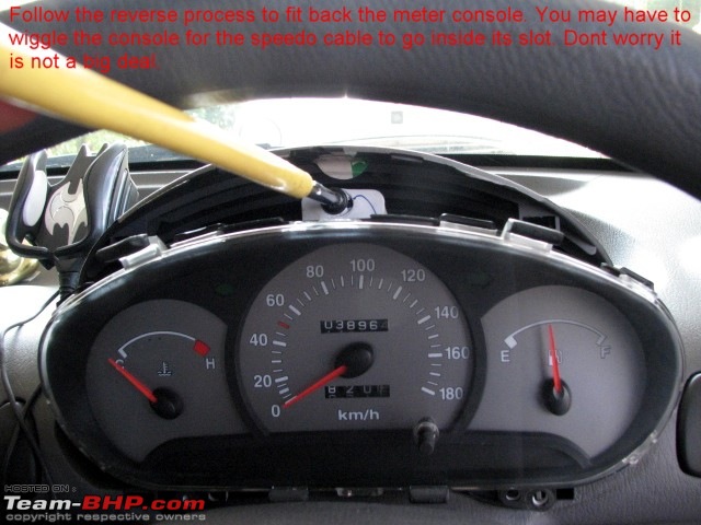

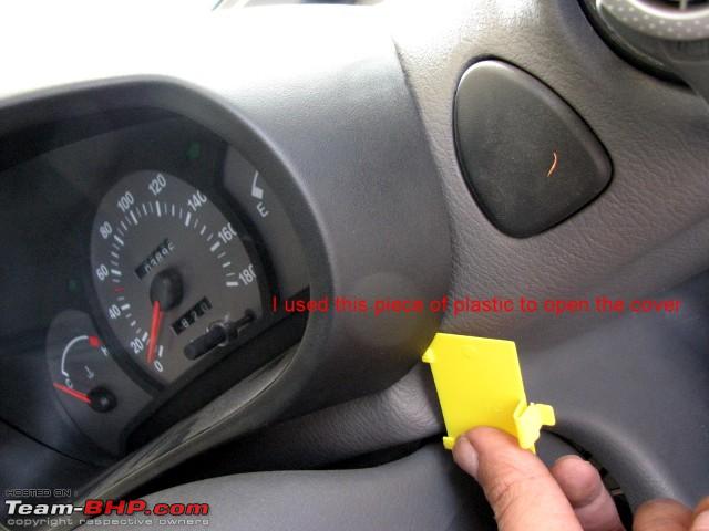

Ok Guys Here are the pics
Hey guys seeing your enthusiasm, I got myself free early today and am posting the pics. Please bear with me in the matter of narration and tagging of the pictures. Special credit goes to akshay who kept egging me with a lot of PMs. Here you go. If you would like to thank me do so by changing your console's colour and post the pics
cheers
Lifewater
