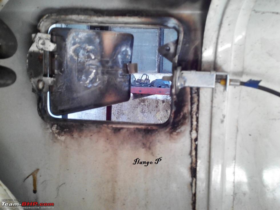

Remote Fuel Lid Release for 118 NE
As the car is in the paint shop, thought it was high time to get the remote fuel lid mechanism installed. The fuel tank was already removed, which gave better accessibility for working.
Things I purchased
1. Maruti Esteem Fuel lid - Rs100/-
2. Indica Fuel lid locking mechanism - Rs 50/- (used piece)
I had already laid the cable for the opening mechanism while the boot release was done. The cable was from a Maruti Esteem.
A small DIY was involved in bringing a spring release for the lid to flip open upon pulling the cable.
Let the pictures explain the rest.
Oops!! Forgot to mention what the hair clutches are doing here. They both were cannibalized for the springs . I am yet to inform my wife about this.
