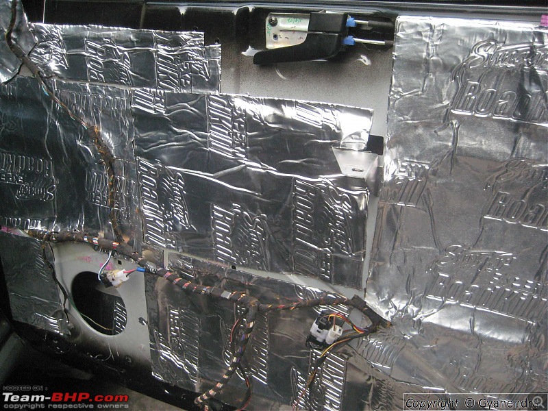

Finally I did it on doors and speakers at the back. Below are few pics depicting the work done.
I am pretty satisfied with the result as the wind noise has almost gone. Cabin is much more silent than before. I still have some noisekill pads left, may be i will get them on engine firewall.
I have used a noise kill on doors, Some yogamat on the plastics to reduce gaps and white tape on window beading along with the sewing machine oil. Also to note I covered the hole of side mirror from inside. All this together has almost killed the noise. (ofcourse engine noise is still there).

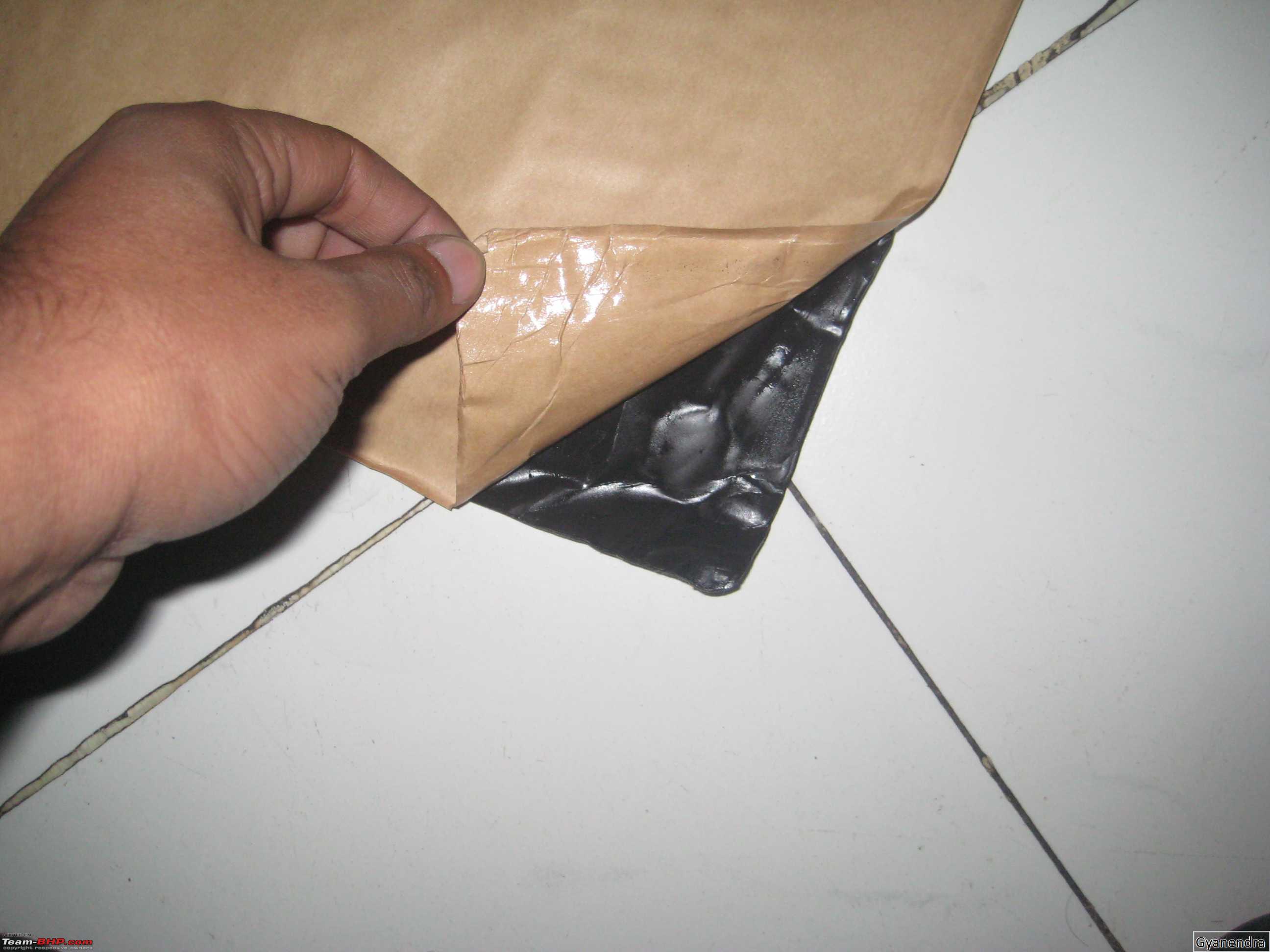

Yes, this has an adhesive like rubber component on the other side followed by thin aluminum foil. It can easily be cut into desired size
