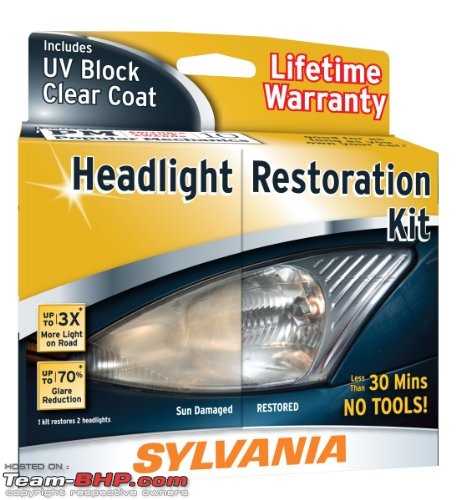

Will click and post later. Untill then, this pic (left) describes the condition of my headlight the best. It's the lens which is cloudy.
DIY Guide : How to get the sparkle back in your old (dull) headlights!-51tyglwjhml.jpg

Nishant that means that your headlamps are burnt and faded from the inside due to the high wattage.
The restoration kits work for outside fading like driving on sandy roads which is like sand blasting or parked in sun for long time.
Not much can be done for inside damage.
Even the mothers require a drill or powerball as they call it.
These can be applied by hand but they require a hell lot of manual labour in buffing. They work best with the drill as it is easier.

Feel the outside surface of headlamp. If it appears rough & uneven instead of glossy. Then, it is probably dust that has got embedded in the outer layer of plastic due to heat facilitated 'diffusion'. Try a 100-150 rupee liquid rubbing compound from 3M ,manually. If it responds well, go to a bodyshop & ask them to buff it up using the liquid rubbing compound. They have a similar attachment for polishing cars. Be sure to remove the headlight from the vehicle & also, ask them to select a low rpm so that the lens does not crack.
The 3M product is compatible with machine application also.

Yes, the outside surface of the headlamp feels rough/coarse. It is most definitely from the outside.
