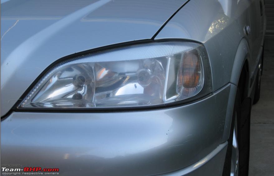

When compound disappears, wipe the surface with dry cotton cloth and its time to use the plastic polish. I took a big dollop from the bottle and rubbed it till it disappeared. Now buff it with a clean cotton cloth to get that sheen that you've been missing for long.
Final results on my car
DIY Guide : How to get the sparkle back in your old (dull) headlights!-tbhp-4.jpg
I am happy with the results as car look has improved allot but still there is room for improvement. I'll give it another shot with 1500 grit and see if gets any better.
After this I gave my car a good wash and some polish. ladies and gents behold my 10 years old beauty

Thanks for appreciation guys, head lights on my car are plastic and this practice is very much safe. As mine were not too deteriorated, I used 2000 grit sand paper. Its very fine sand paper, upon touching you don't feel the rough surface much. I would'nt recommend it on glass as I haven't tried it and don't know what the results would be. For those who are iffy about doing it on plastic, guys give it a try its safe and results will definitely please you. But make sure you are doing it right, somethings to be careful about (I know I am repeating these but just to clear you doubts):
  • Good quality wet and dry sandpaper with no less than 1000 grit.
  • 2000 grit for little scratches and just blurry headlights, 1000/1500 grit only if headlights are nearly opaque and have deep accidental scratches.
  • keep spraying water on surface and sandpaper. Its the dry rubbing that'll damage the plastic headlights.
  • Do not do it in circular motions. Only horizontal and/or vertical motions.
  • Get a good quality plastic polish (I believe hardware stores are places to procure it or try ebay for Maguire's, Autoglyme or Chemical brother's headlight polish. These are good brands. I used Maguire's). Do test the polish first if its not specifically for headlights.
Happy D.I.Ying
