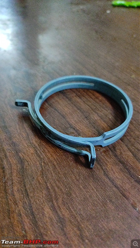

Please suggest the correct tool for this clamp. The opening between the legs is 80 mm. I tried looking for a monkey plier, but none of them open this wide.
These type of clamps are sometimes referred to as equal pressure clamps. They are supposed to clamp the hose better and more evenly along the complete circumference. Can’t say zo have noticed the difference. My Jeep is knitted out with these, but none of my other cars are.

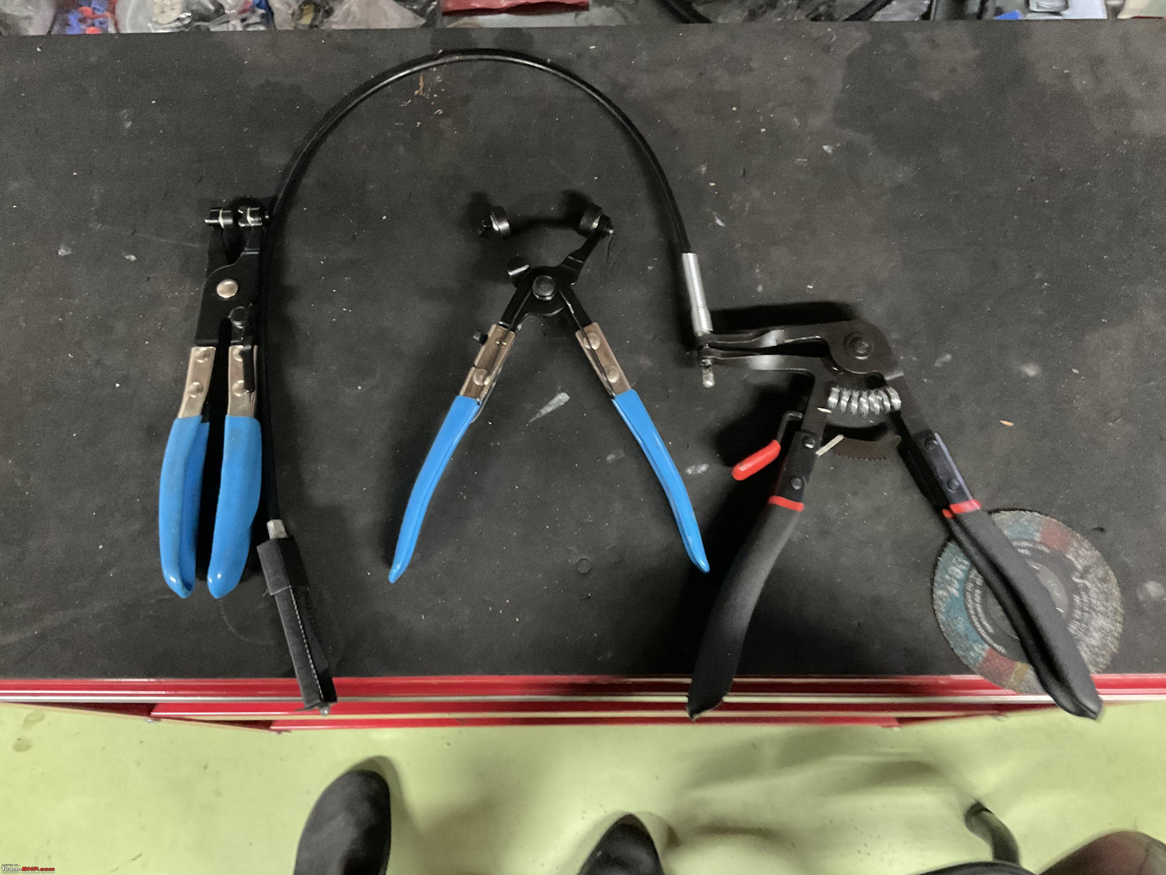

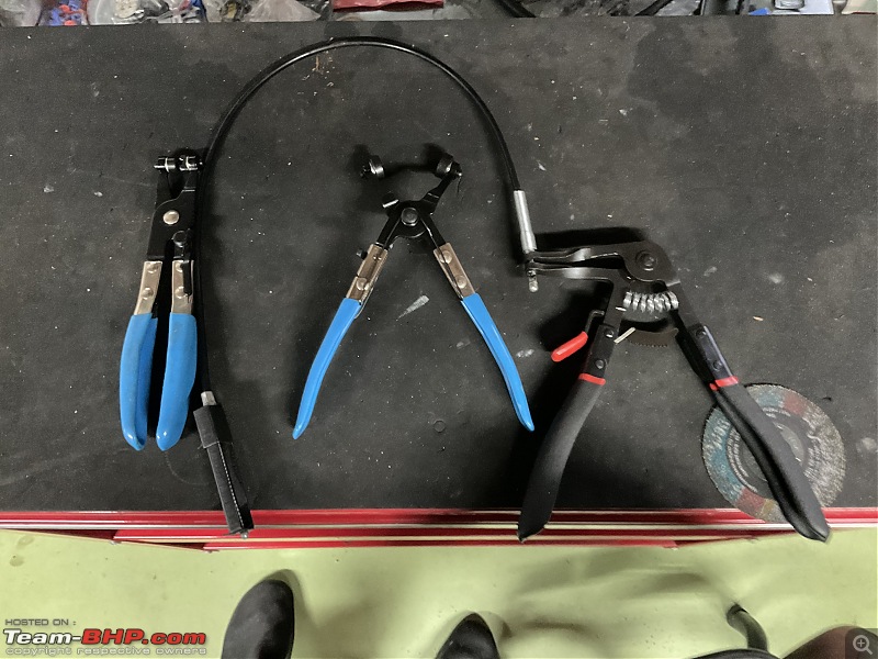

I got myself three special pliers
One has a remote beak, so you can get into small spaces. Very useful on the Jeep radiator hoses.
They all have this ratchet mechanism, so you squeeze it down, which opens the hose clamp, the ratchet holds it opened, in place so you easily remove or install the clamp from/over the hose.

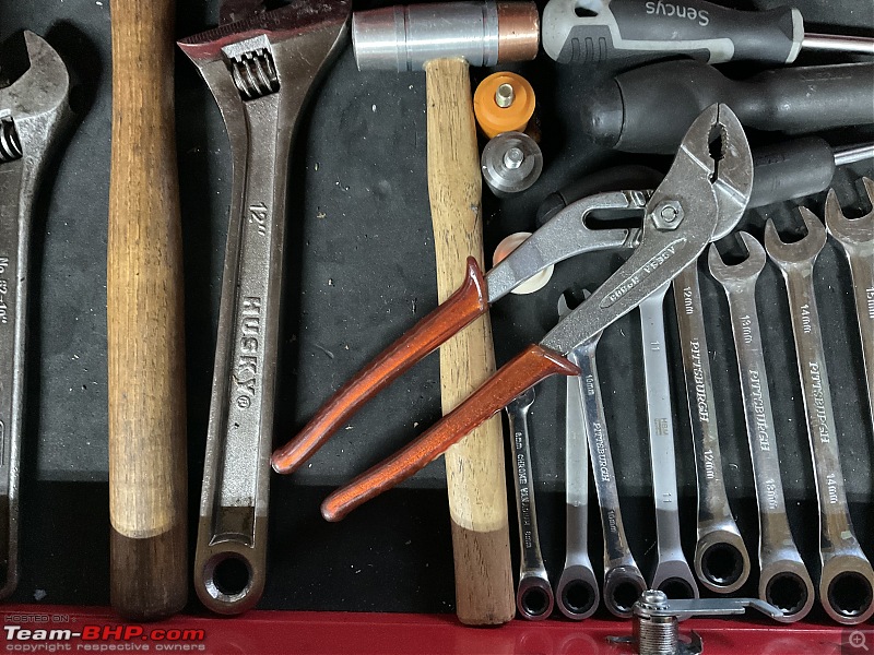

If you can’t get these use one of these, you just need to get the right size. This is my medium one, I have one considerable larger and one much smaller.
