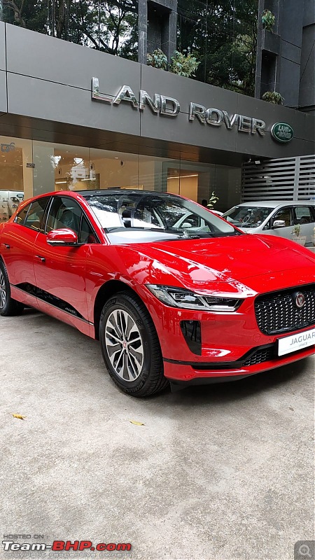

All this started with my deciding to buy a Jaguar IPace. I was blown away when I drove it. I saw this in the showroom. I took the same with a ivory interiors. The test drive and experience is another story.

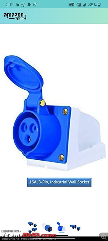

Once I reached home, I figured out that the charger provided had an industrial plug. So I could not charge at home, and I had 80 km remaining.

With sufficient battery in place, I got my electrician the next day to find an adaptor for the industrial plug, and he also got me a 20 meters power cable to full from the AC socket in my living room.
I took 35 hrs to charge. Then I decided to fix the charger in Thrissur. The next day I went to KSEB to get the load enhanced; they said I needed to fix the wiring and charger before they came for inspection. So I called up the Tata guys, and they came a few weeks later and fixed it. I could not find the 10mm XLPE cable that KSEB asked for, so I bought a 25 mm ABC cable. The cable cost me around 175rs per meter. Then since the load went beyond 10KW, I had to pay another 18k to KSEB. And since the porch was 27 meters away, I had to pay an additional 12k to Tata power for the extra 17 meters. Still good, approximately around 40k.

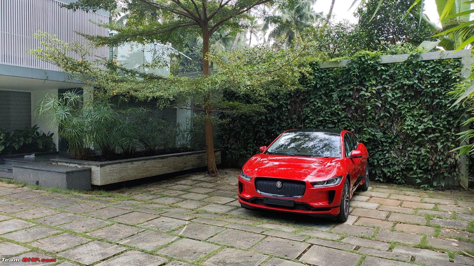

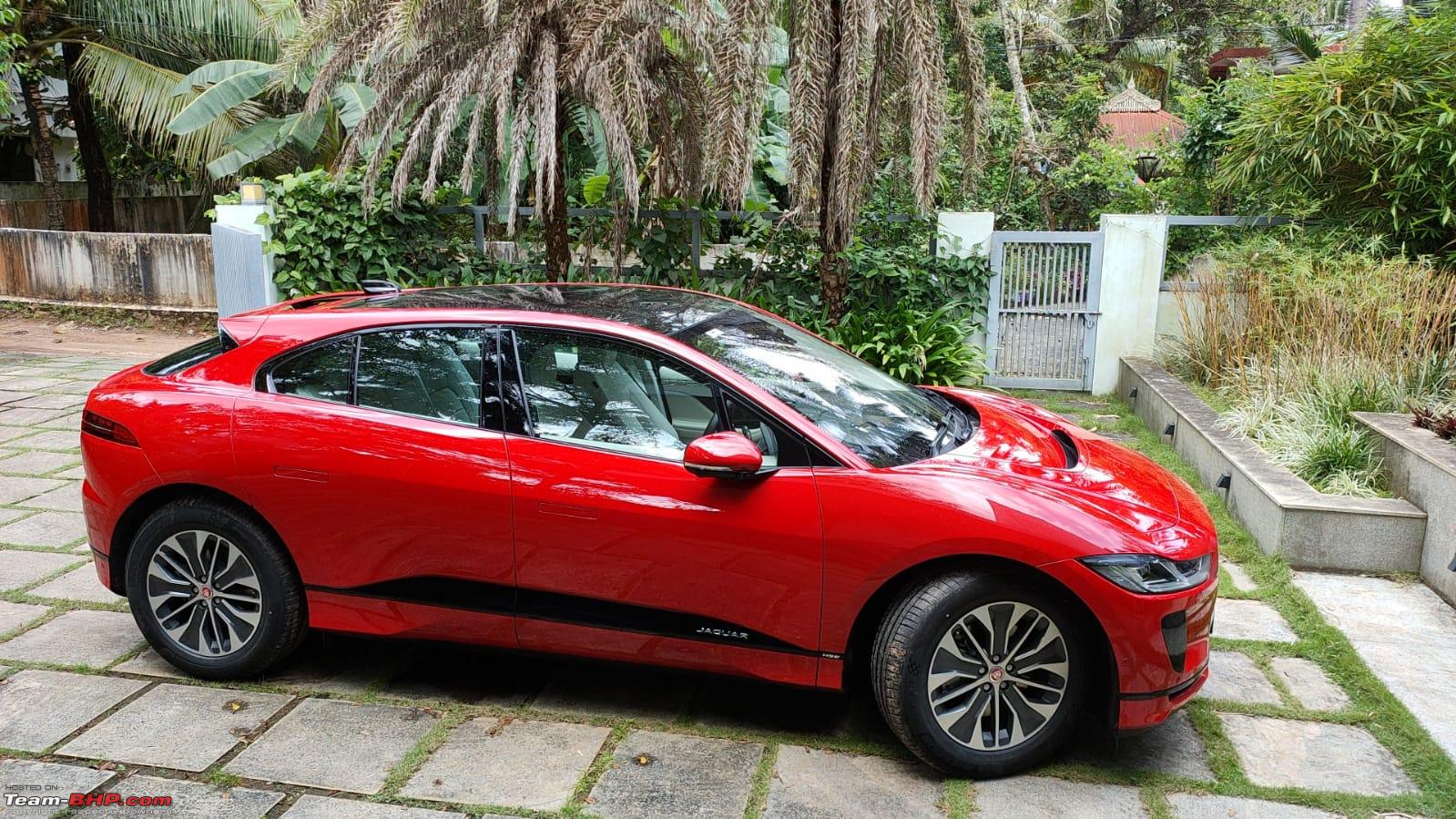

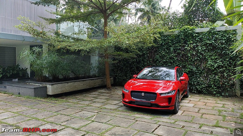

Now you will think, was it worth all this trouble to get an electric car? Believe me, this was the best thing that ever happened. You need to drive an IPace to feel the G force, the SUV that behaves like a sports car. More about that later.
