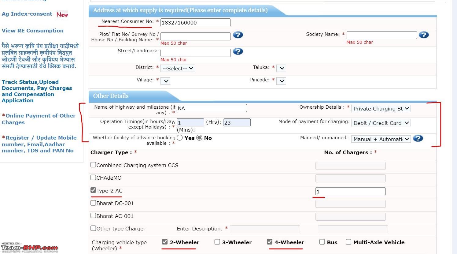

  4. Select the below options carefully.
    Step-by-Step Guide: Dedicated EV Charger Connection in MSEDCL, Maharashtra-portal1.jpg
    Step-by-Step Guide: Dedicated EV Charger Connection in MSEDCL, Maharashtra-portal2.jpg
    Step-by-Step Guide: Dedicated EV Charger Connection in MSEDCL, Maharashtra-portal3.jpg
    I am mentioning essential options here. The rest of the options are self-explanatory.
    Consumer Category - 1-LT-SUPPLY
    Supply Type - SINGLE-SINGLE PHASE
    Requested Load -7.5 KW
    Nearest Consumer No - It should be your existing residential MSEB connection number.
    Name of Highway and milestone (if any) - NA
    Ownership Details - Private Charging Station
    Operation Timings(in hours/Day, except Holidays) - 1 (Mins) 23 (hours)
    Mode of payment for charging - Debit / Credit Card
    Whether facility of advance booking available - No
    Manned/ unmanned - Manual + Automatic
    Charger Type - Type-2 AC
    No. of Chargers - 1
    Charging vehicle type (Wheeler) - 2-Wheeler 4-Wheeler
    Is Multiparty/Triparty Secondary Consumers - No
    Please select option for payment - Provisional Estimate alongwith Processing Fees

2. In the meter picture from your R/Residential meter to EV meter, the connecting wire looks thin, though it could be an illusion. What is the gauge of this wire? I was under the impression 7.5KW charger needs 10mm square wires. (That's the wire guage used for 7.5KW chargers by Tata Power electricians installing chargers for Tata Motors EV customers.)
3. I assume the process is the same if we are getting a dedicated EV meter for 16amp plug/ 3.3KW charger. Would the installation charges or the monthly fixed charged be different?
On Connection charges - Honestly, I did not get into detail about why two services are shown in the calculation. I contacted a few people with EV meters, and all confirmed the exact charges.
Wiring - You are spot on with the observation. I also questioned the MSEB electrician on whether this wire would sustain a 7.5 KW load, and he was very sure. Wire does not have specifications. In the next few weeks, I will be having a charger installation. If the installation team advises, I will replace this wire with a better one. I will update here on the outcome.
On charges - The process to get an EV connection for a 16amp plug/ 3.3KW charger would be the same, and the charges will also be the same.
