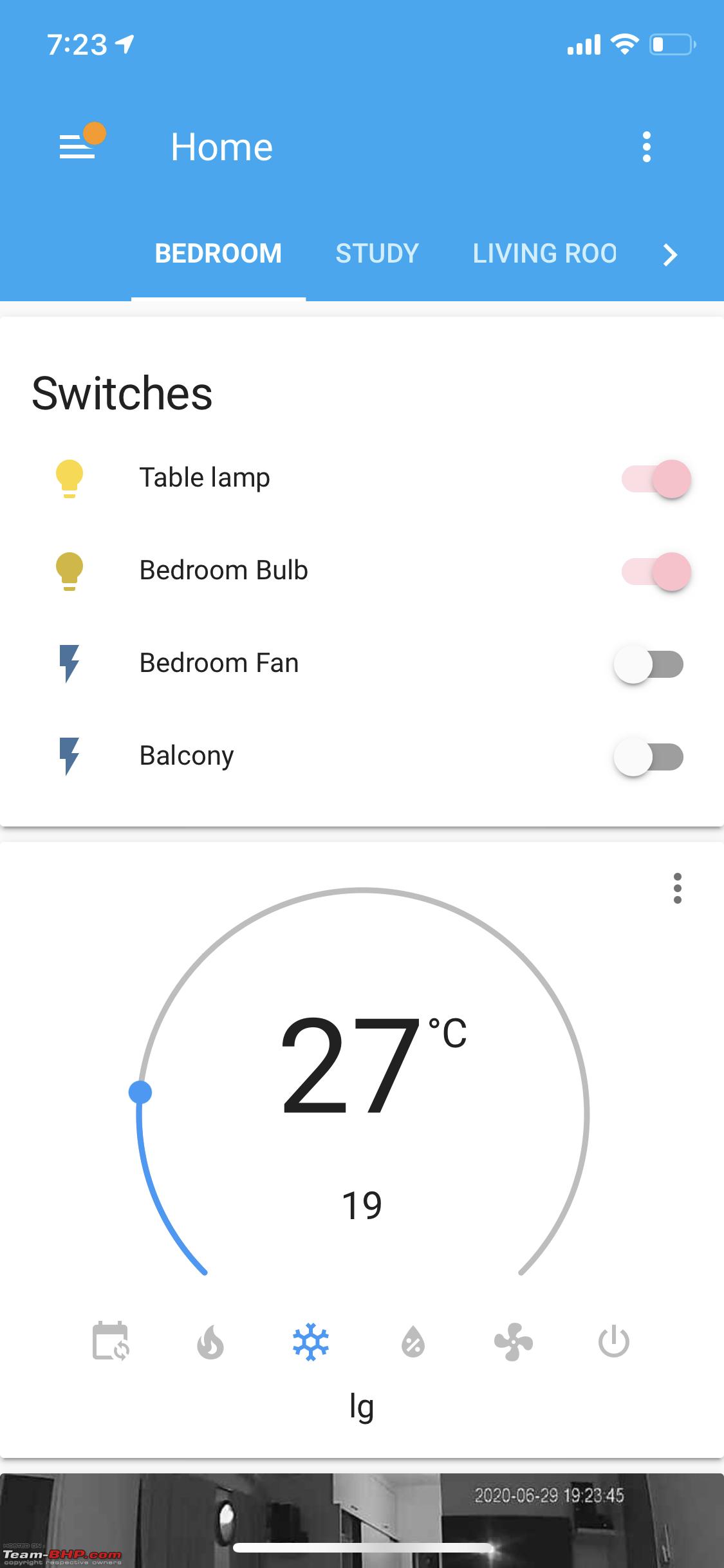

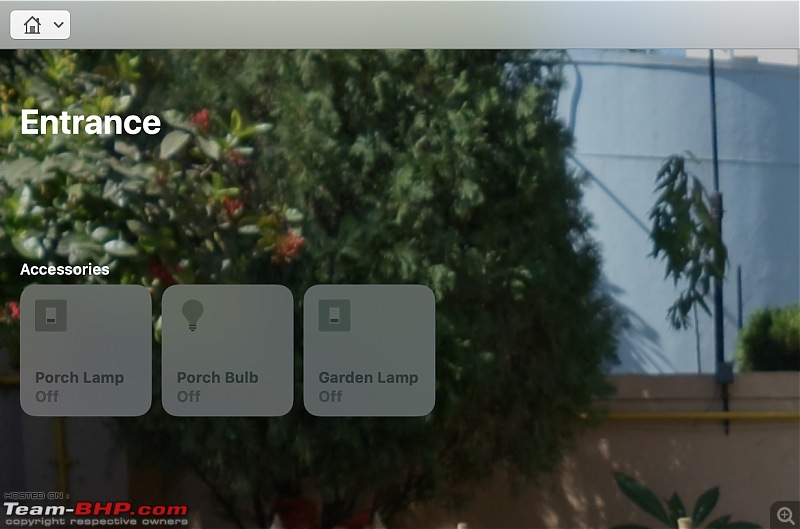

Summary on Home App
My Home Automation with 75+ devices - From Domoticz to Home Assistant-homekit.jpg

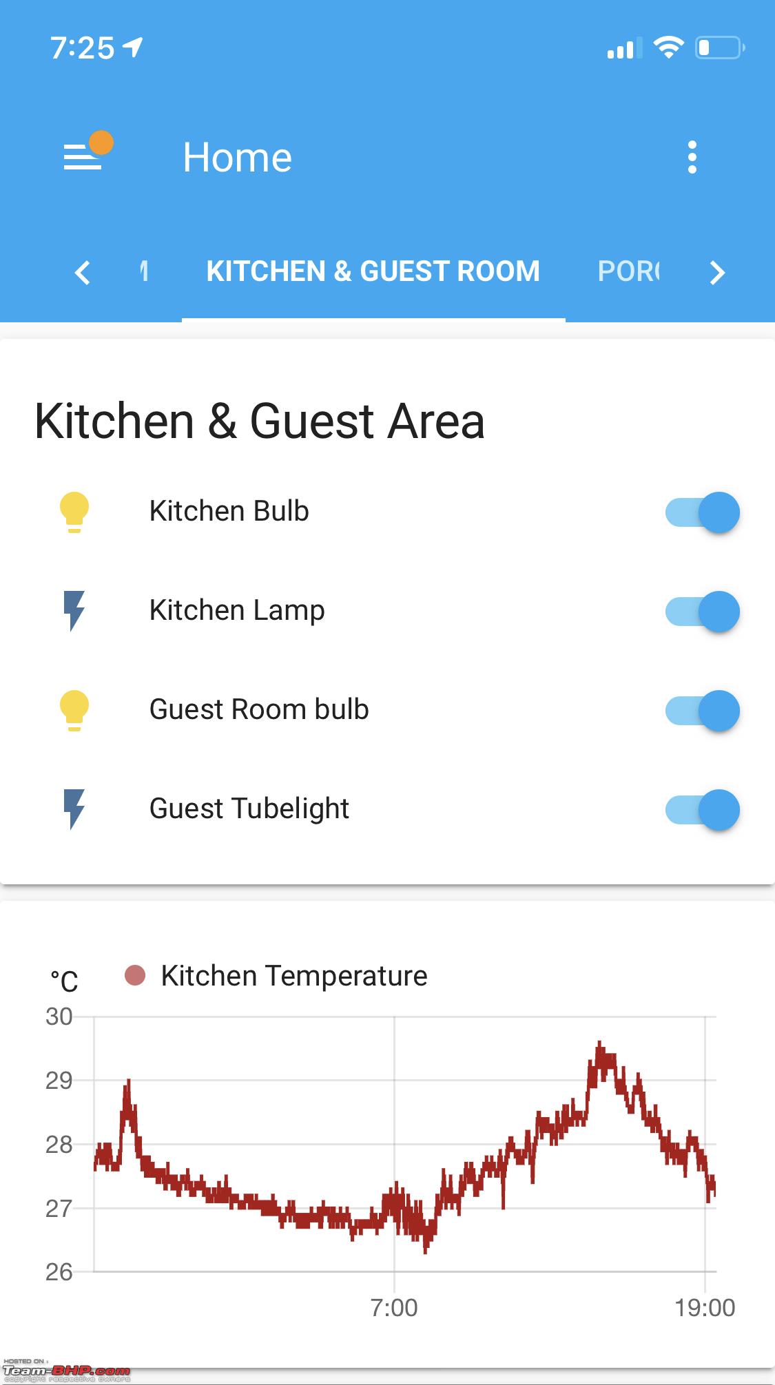

Kitchen
My Home Automation with 75+ devices - From Domoticz to Home Assistant-kitchen.jpeg

HVAC Control
My Home Automation with 75+ devices - From Domoticz to Home Assistant-br.jpg

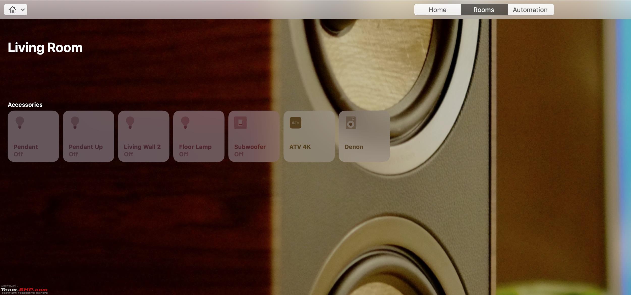

Living Room
My Home Automation with 75+ devices - From Domoticz to Home Assistant-living.jpeg

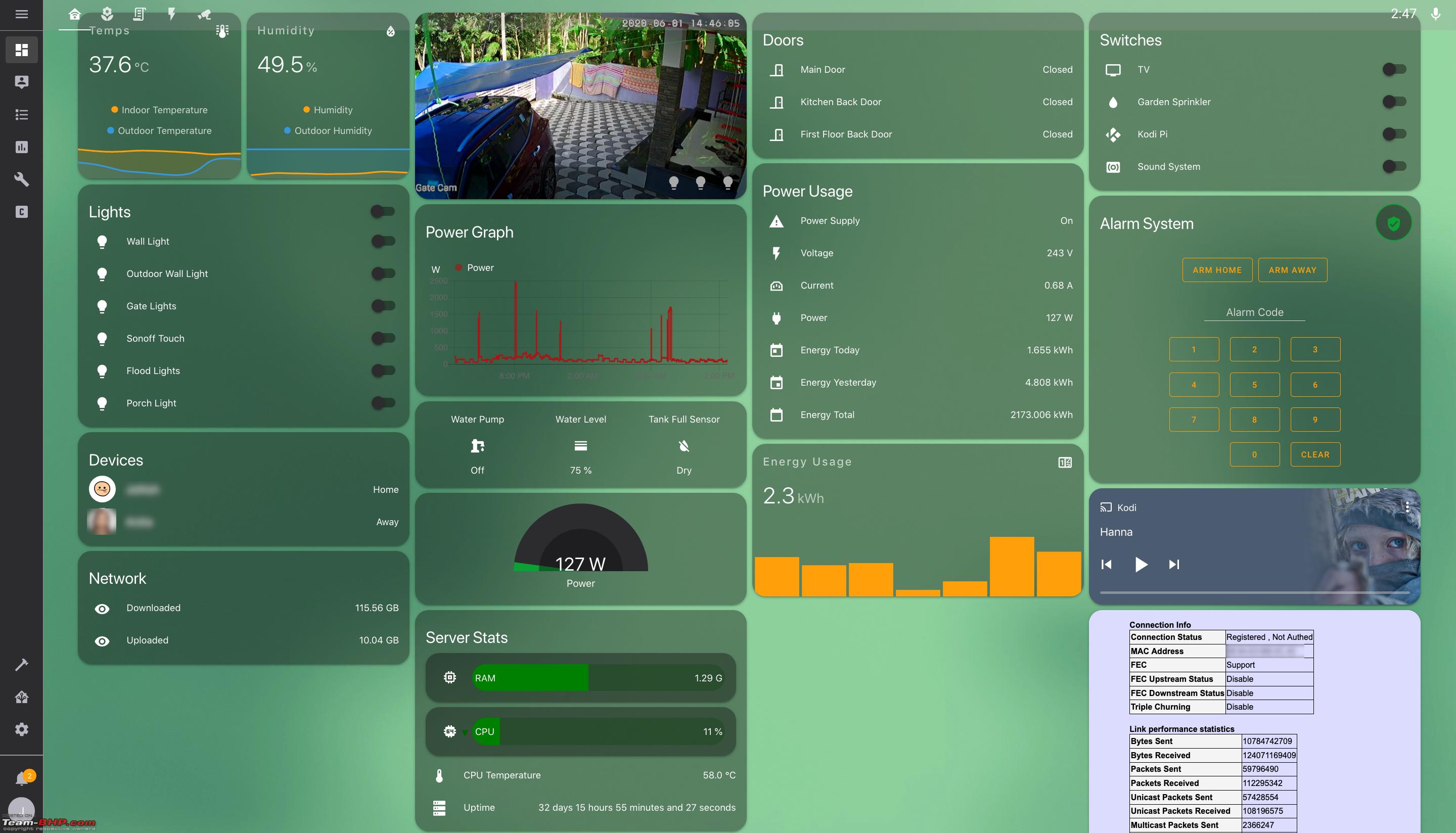

My Home Automation with 75+ devices - From Domoticz to Home Assistant-screenshot-20200703-1.12.44-pm.png
What is left out are my Dyson air purifiers, Sensibo air conditioner controllers, oater switches etc.
I had to switch to echo/Alexa to have a single assistant that could deal with everything. Had to buy an echo device for each room ! :deadhorse

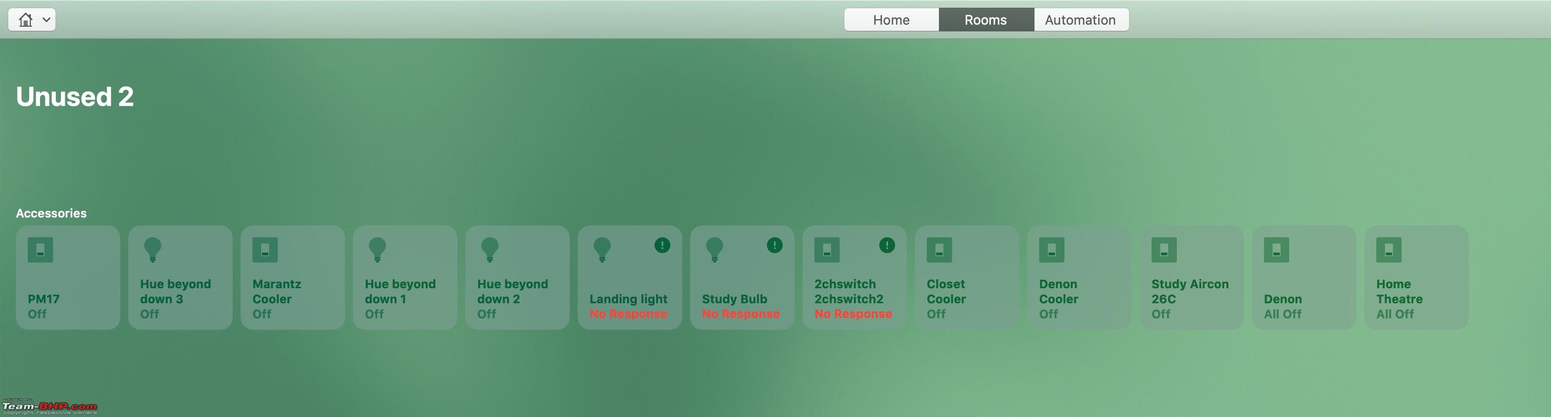

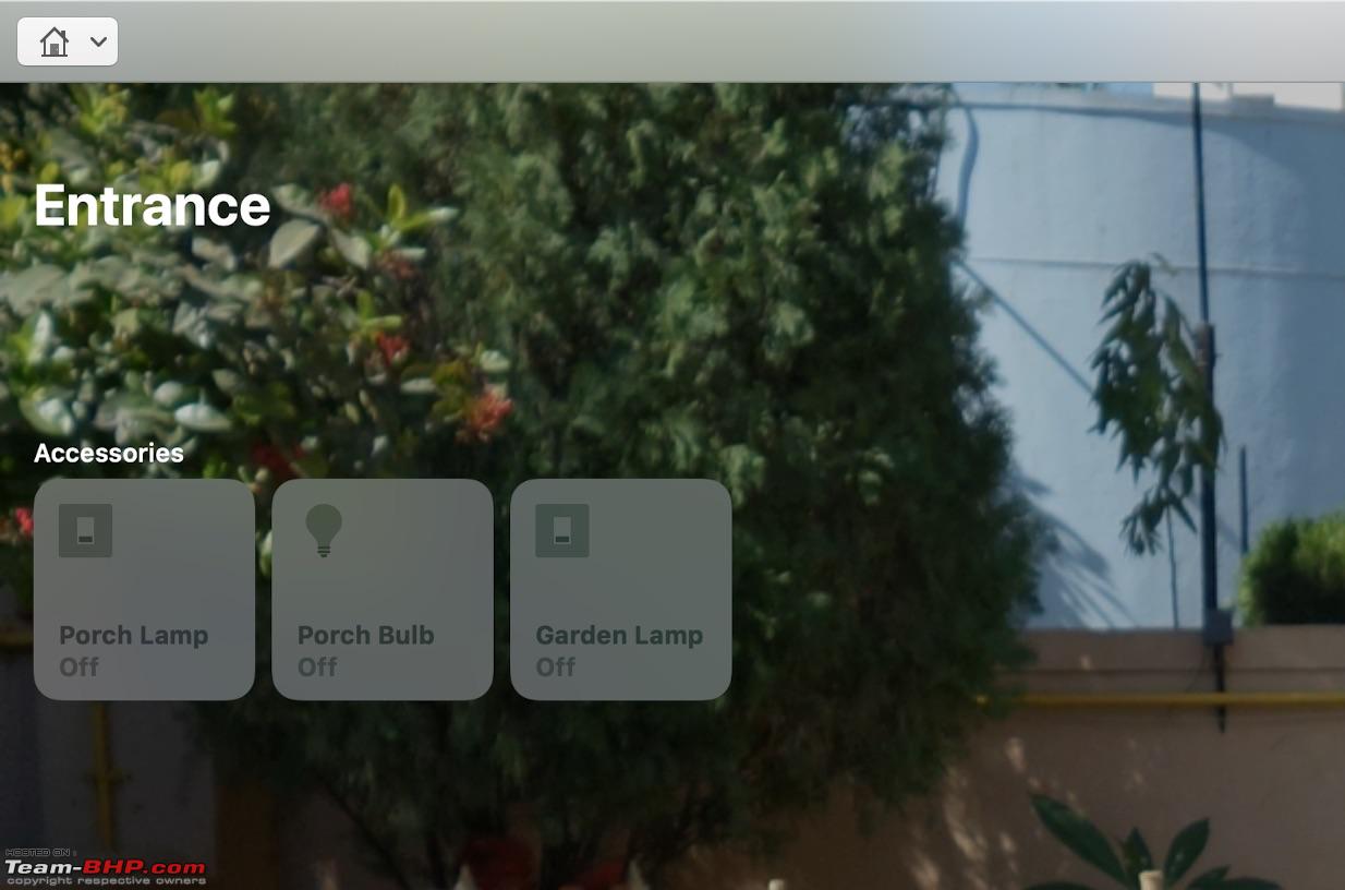

My setup also has very disparate end points of which only 10% would show up under homekit
But with an independent core, I can get all the required end-points into whichever front end I want
So e.g. I too use Alexa + Siri
But for Alexa, rather than relying on the high latency cloud servers from the manufacturer (which causes a delay between a voice command and and actual action), all devices get bridged directly on the LAN leading to much faster response
As for homepod/ homekit, I can add any of my devices into it and segregate them by room
e.g.
Summary

Area 1
My Home Automation with 75+ devices - From Domoticz to Home Assistant-porch.jpg

Room 4
My Home Automation with 75+ devices - From Domoticz to Home Assistant-living.jpg

Area 5
My Home Automation with 75+ devices - From Domoticz to Home Assistant-unused.jpg
