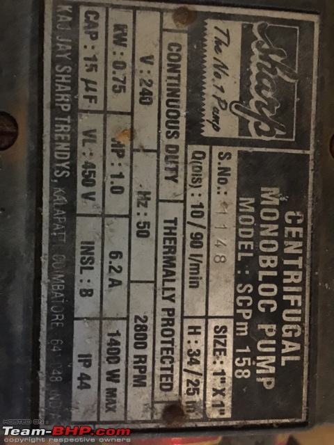

Originally Posted by archat68 (Post 3791902)
I'd suggest to connect the motor directly to the switch omitting the plug in between.
Sir to achieve this and eliminate the plug do I need a 3 pole mcb like this
Save yourself some money and just buy a 6 A MCB ( assuming that you connect a 1 HP motor ) and use a connector to connect the neutral line.
Thanks, I was considering the same after reading up more this morning. I assume I will do the connector thing for the earth line as well? Yes it is a 1HP motor.
Connecting neutral through MCB has its own problems. If the neutral gets disconnected some how (has happened in quite a few cases that I know of, where the MCB misbehaved) and the live phase is connected, then the live phase may float as high as 400V.
6A for a motor? I thought 6amps was for light stuff like, err... lights?
Ours (only 0.5hp, I think) has a 20amp breaker.
My motor is rated 6.2amps and guess the 6A breaker is safe considering the burn outs I am witnessing
You may have nuisance tripping if the running current itself is 6 A or thereabouts. You will need the next higher rating - may be 10 A. Make sure that the wires feeding the mcb from the mains point and to the motor are rated adequately. Since it feeds high current load (1 HP or above motors, 1 ton AC or above) you will need 7/20 wires. This will prevent your wires/cables from getting heated up and introduce unwanted impedance. Smaller gauge will cause lower supply voltage at the motor end which may result in premature failure of start/running capacitors apart from the possibility of motor winding failure. I have given large margin as safety rating for the wiring. Usually for your load 3/20 wires may be adequate.
Your 20 A Circuit breaker will not protect your motor. It is like using a 20 A fuse to protect a circuit which draws 3 A. Generally fuses/mcbs are rated at 100-125 % of the devices they are intended to protect. Motors draw a high transient current when they start. So some margin is allowed to prevent nuisance tripping, but it surely can't be 6 times.
Well. I actually never looked before. A number of things have led me to believe that the people who rewired our house were incompetent --- and now I have yet another :Frustrati
diyguy, thanks for the photo of the plate. I can't argue with that, although I wonder what the starting load is.
Guys... I've seen special switches for motors. Anybody know what I mean? What do they do? Are they recommended?
Attachment 1410457
6A is the running current. The starting current can be three times as much. If you fit a 6A circuit breaker, check the specifications for short term (less than 1 sec) load rating. MCB come in various versions with the basic say 6A rating for sustained load and 10, 15, 20 and 25A for starting load.
Go through these links for further clarifications
http://www.portexindia.com/technical...rcuit-breaker/
https://www.tlc-direct.co.uk/Technic...bution/Mcb.htm
http://www.khaitan.com/bcp_dir/mcb.htm
