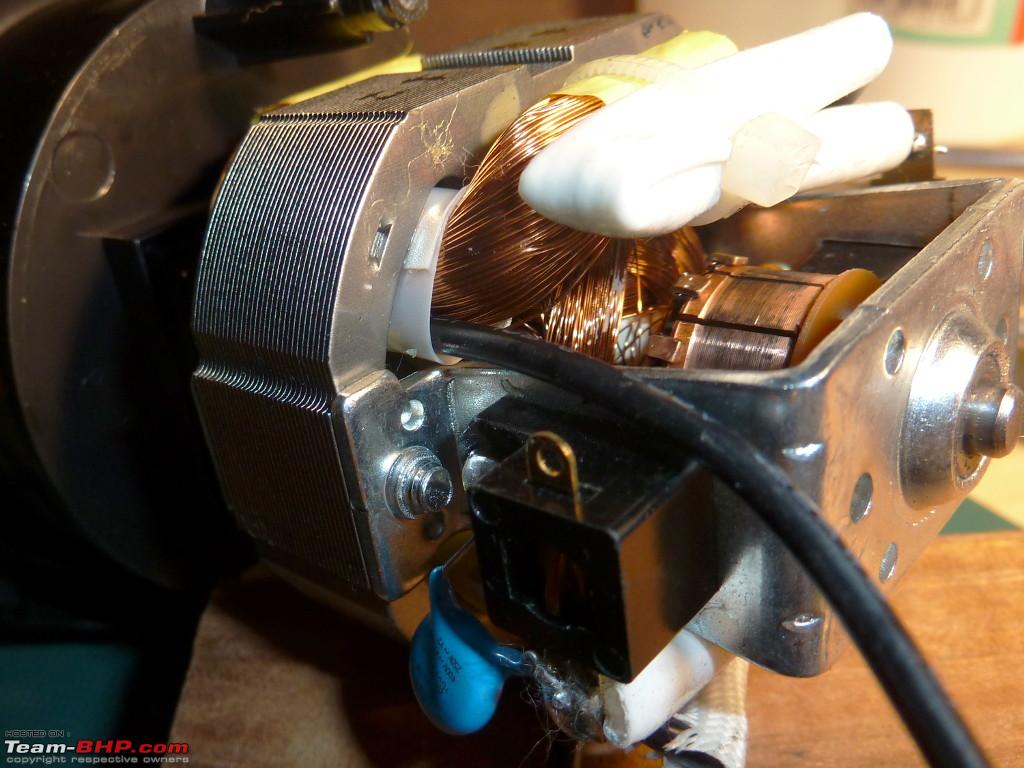

It looks like this
I see two "ends," Should they be there? There is no sign that there were ever joined.
(spot the useless-at-graphics-with-a-mouse marker)

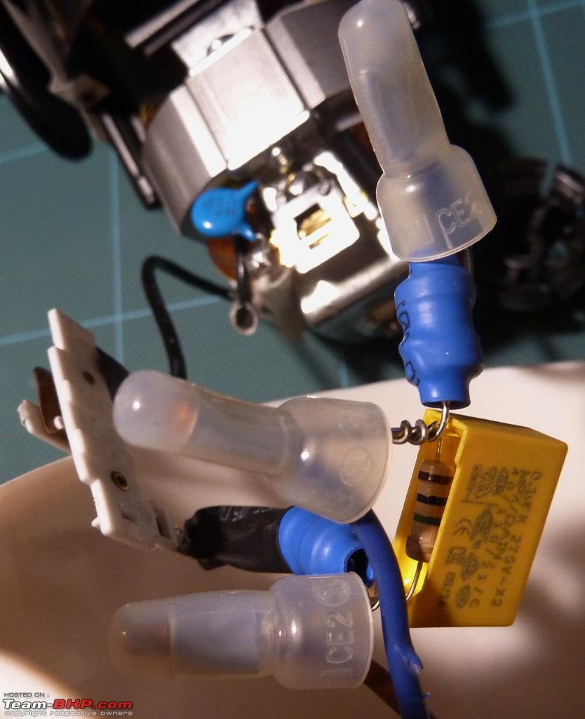

Here are the anciliary electrics and switch

See the photos above. I notice marks on the commutator. The brushes cannot easily be removed, due to that soldered capacitor on each one. The brush holder, to which it attached, is not screwed but riveted to the motor body.
Is it tight? It is not free-spinning loose, but I don't think it ever was.

It is a 'universal' motor and by the looks of it the winding is not too difficult to rewind. It can be done at less than Rs.1000/- not far from your home. :)
If it has shorted windings, you should not run that for long. Probably just long enough to check for overheating winding which will confirm the shorted winding diagnosis. This kind of motors don't have start/running capacitors (which fail over a period of time) like the induction motors (they do service in pumps, fans, compressors etc). But then Thad - you know all these already.
