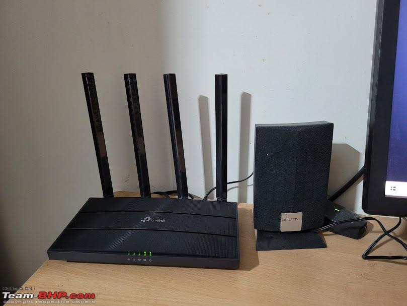

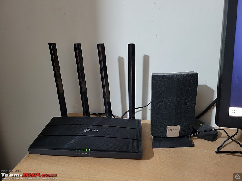

- Ditch the old cheap Mi router and go for TP-Link Archer C6 router (price Rs. 2,600) in Room 1:
What is your home Wifi download speed & what steps have you taken to improve it?-20231228_180814.jpg
This room has a desktop with no internal Wifi antenna & was receiving wifi signals with an old USB Wifi adapter. Technician asked me to go for TP-Link Dual Band USB Adapter (price: Rs 1,200):

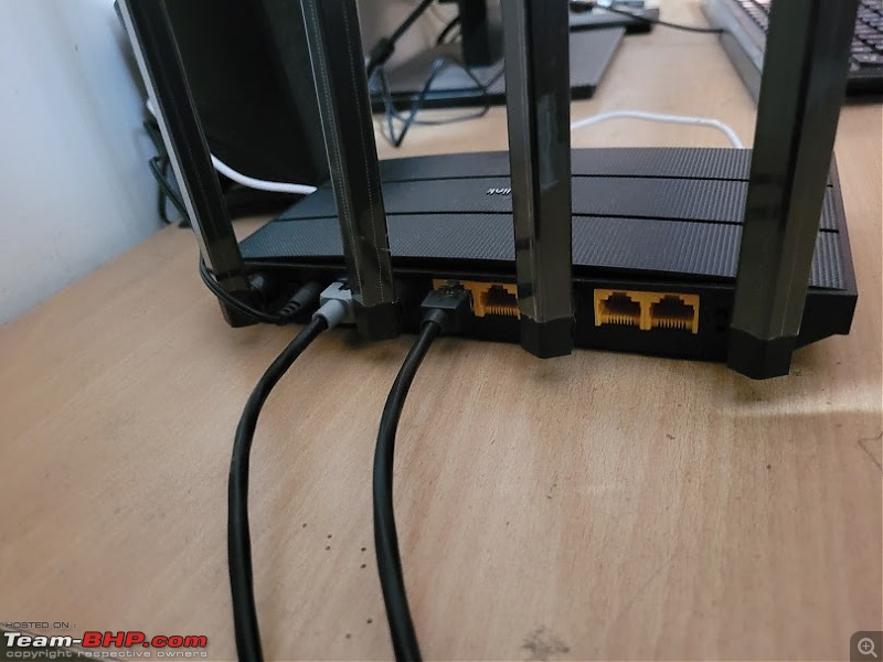

For Room 2, the technician suggested that we connect two routers (in Room 1 & 2) together with a 50 or 60 ft long ethernet cable (Rs. 2,500) pulled from outside the home. Note: I don't have much knowledge about routers/networks. That's what I think he told me. Please do correct me if I'm wrong.

The TP Link Archer C6 is an excellent choice to start with - the four external antennas definitely help with range and having AC1200 Dual-Band Wi-Fi with MU-MIMO technology definitely helps with fairly good data speeds across multiple connected devices.

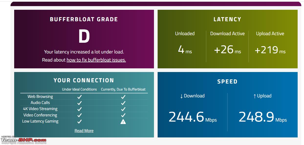

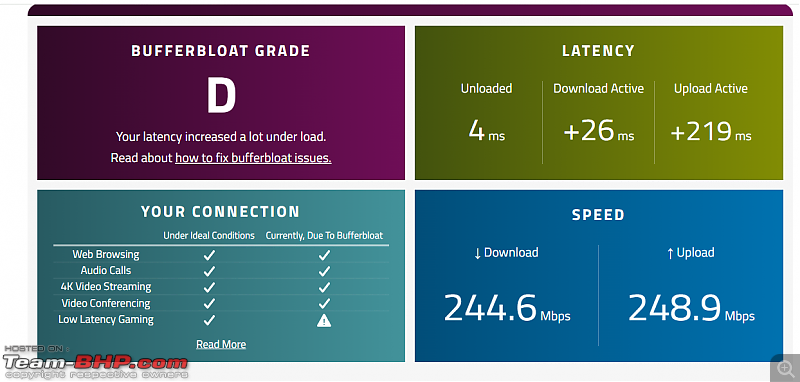

Waveform gives my connection a 'D' grade for Bufferbloat and that I might face intermittent issues with "low latency gaming"

Strange! It is recommended that other devices are disconnected from the network when performing this test. Might have occurred if someone in your house was using the internet when performing the tests.
Nonetheless, I would head into QoS enable bandwidth limiter to 60% - which for you would be 180/180 download/upload and perform these tests again. Worth a shot, here’s more on bufferboat and how it impacts your experience.
Or leave the settings as is, since only low latency gaming is impacted!

Before you do that check your second routers specs. It might just have 100Mbps ports. In that case you might need to change the second router as well. Ive seen routers with 2 output ports one having 1Gbps and other 100Mbps.
