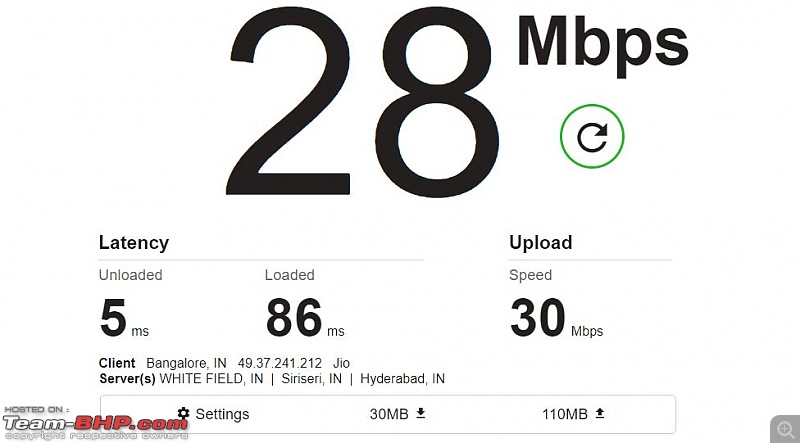

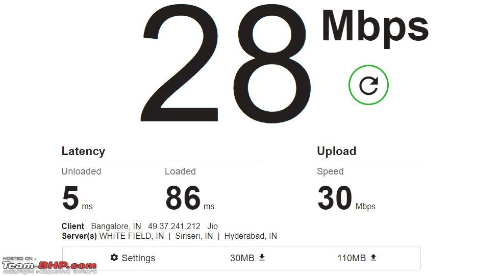

Waveform gives my connection a 'D' grade for Bufferbloat and that I might face intermittent issues with "low latency gaming"
What is your home Wifi download speed & what steps have you taken to improve it?-screenshot_3.png
Meanwhile, cloudflare says All Izz Well.
What is your home Wifi download speed & what steps have you taken to improve it?-screenshot_2.png

Strange! It is recommended that other devices are disconnected from the network when performing this test. Might have occurred if someone in your house was using the internet when performing the tests.
Nonetheless, I would head into QoS enable bandwidth limiter to 60% - which for you would be 180/180 download/upload and perform these tests again. Worth a shot, here’s more on bufferboat and how it impacts your experience.
Or leave the settings as is, since only low latency gaming is impacted!
