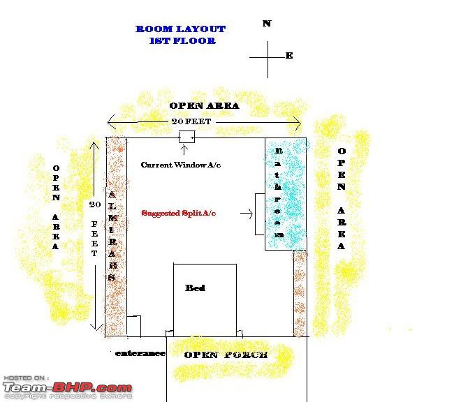

We have a 2 ton Carrier window a/c that has lasted us more than 8 years now. The compressor was changed 3 years back but the ac has started us giving us problems. I presume the problem is due to compressor overheating and switching off till it cool downs.
I presume the overheating is happening because the heat exchange is not happening properly from the front and the back. It appears that the radiator like thing with cooling coils in it with sharp edges ( dont know the technical name) seems to be blocked. So am I right in my understanding so far??
After washing the front and the rear with water the A/C functions properly for 15 days but starts giving problem again.
Now the thing is that we have decided to buy a new A/C. If we buy a window it will most probably a 2.0 Ton O-General A/c and If we buy a Split it will most probably be a 2.0 Ton Daikin A/C
Point to be noted is that my room is on the 1st floor. My room Lay out is attached
The home / office air-conditioner thread-room.jpg
Now The questions are
1. Considering the fact that my room is subjected to sunlight from all 3 sides plus the roof (we dont have false ceiling nor roof treatment) is 2.0 ton a/c sufficient?
2. Is it true that a 2 ton spit performance is better than a 2.0 ton window?? I doubt it but will still ask. I really dont care about the difference in noise level.
3. We have space for a window a/c so is it better to utilise that or close the gap and install a split?
4. Is split more prone to getting spoilt than a window, as it has 2 units to be serviced?
5. Are the choice of brands for window i.e General and spilt i.e Daikin a good choice in terms of reliability?
6. Is it true that a 2.0 ton General performance will be better than a 2 ton carrier performance?
7. If we go in for a split, is the suggested positioning of the split ok? will we get air throw on the bed considering that it will be on the side?
8. Any other suggestions??
Thanks and regards
I presume the overheating is happening because the heat exchange is not happening properly from the front and the back. It appears that the radiator like thing with cooling coils in it with sharp edges ( don't know the technical name) seems to be blocked. So am I right in my understanding so far??
Attachment 553996
Thanks and regards
Your problem is similar to mine. The outdoor heat exchanger is getting clogged very fast. There are two reasons. One there is a lot of dust and along with moisture it creates a chocking mud. Two, to increase the thermal efficiency, the fins are spaced very close, hence they get choked faster. I suggest that instead of replacing the AC, you wash the rear condenser every week, using a pipe connected to a tap. That is if your condenser can be easily accessed. The indoor unit does not clog that easily, and can be washed twice a season. As you are on 1st floor, you can invest in a bamboo ladder and one roll of water pipe. I got these for around 300 for bamboo ladder and 400 for the pipe (cheaper than calling the AC service man every now and then!)
Now your questions.
1. If you current AC is cooling (after cleaning), then 2 tons is sufficient
2. In my experience, window type AC rarely give sustained cooling, primarily due to their cramped design. Hence a 2 ton unit will give any where between 1.5 and 2 tons. In a split unit both the heat exchangers are bigger, thus giving better efficiency, hence cooling.
3. Get a Split and close the window (better still close it with a thin wall and use the space for shelves)
4. Split and window type have same rate of failure. If the unit is good, then both last 5-10 years without any problem. If not then both can be a hell to maintain.
5. Daikin is considered to be the best in its range, provided you get it installed by Daikin Engineers and not by the dealer's mechanics.
6. No idea.
7. I keep the AC as high as possible (near the ceiling), that ensures that all the air gets cooled. Avoid direct blast of an AC, as it will chill you when the compressor is on and then be uncomfortable when it is off. We direct the air up and use the ceiling fan at its lowest setting to circulate the air.
8. In case you have 3 phase supply, why not explore a 2.5-3 ton 3-phase unit. These are more efficient. I have seen these units advertised on both Hitachi and LG sites.

1. You do not need a high pressure hose, normal water pressure will do if you are cleaning it every week or so.
2. 3 phase motors are more efficient compared to single phase motors, hence most of the high power devices use a 3 phase motor. It is also simpler in design (no starting or running capacitor), and more robust, so motor burn outs are less. An inverter unit does not need 3 phase as the motor is a DC motor (so that its speed can be easily controlled), but again for higher power a 3 phase inverter is more efficient.
A 2.5-3 ton unit will give you faster cooling in the 45+ degree summer. In my rule of thumb calculation a 400 sqf. room needs 2 tons for the room and 1/2 ton for 2 persons, if you want the temparature to be in the region of 25 degrees, and 4 tons if you want cooling of 18 degrees. My bedroom (16x12.5 ~ 200 sqf. has sun coming on two sides and there is the roof. Our 1.6 ton unit barely cools it to 25 degrees in peak summer. In the evenings it cools, but if there are more than 4 person, then it does not. So even we are thinking of getting a 2 ton unit. One trick I use is to spray water on the indoor condenser every week and clean the muck using a tooth brush, that keeps the indoor coil clean and efficient.
The present machine is on the North wall. Jaipur gets winds mostly from the North Northwesterly direction and your aircon is directly in the path of the dust that comes along.
see my jottings in bold within the remainder of your post below.
Just about there.
Yes
Close or convert to a window etc.
No.
I would go with the Hitachi Star with a 2.2 ton scroll compressor as the first choice and the Generals two ton machine as the second choice.
I will discount the Daikins as they seem to be putting out slightly derated machines on account of the new gas.
http://www.hitachi-hli.com/pdfs/Hita...cification.pdf
In case you wish to go for a 3 phase machine then look at Hitachi Atom XL. It is a 3.5 ton machine and runs on three phase supply. Equipped with a twin rotary compressor it will keep you super cool but is slightly over capacity.
It is on a completely different level.
No neither is the positioning OK nor will you get any throw.
Mount the IDU on the South wall, offset from your bed. Preferably on the side away from the door.
1. Here you can direct the vents to give you a throw if you so desire.
2. This is the coolest wall of the room so IDU will be happy and will keep you happier.
3. The ODU can be located just behind the IDU thereby
3.a. Keeping the piping to a minimum thus reducing the load on the machine
3.b. Being on the porch the ODU will be easily accessible for cleaning etc.
3.c. It will always be in a shade again making life easier.
4. The IDU in this position will cool the area of primary use first and faster.
5. This position will make your room near perfect in terms of Vaastu.
Thanks and regards
