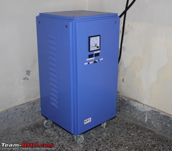

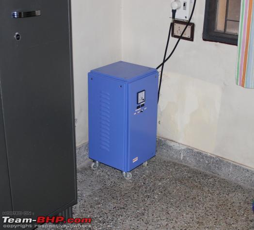

Finally, my AC is working fine now. Installed a 7.5 KVA custom ordered SERVO stabilizer!:D
My ex-neighbor is a UPS / Servo manufacturer and I asked him to suggest me a proper capacity servo to run a 1.5 ton AC. He was first surprised, thinking that I had no idea about the cost of a SERVO stabilizer. He said that SERVO stabilizers usually start from 4 KVA range, and for a 1.5 tonnage AC, it would require more than 7 KVA, costing a bomb. He suggested me to go for triple booster electronic stabilizer.
After making him realize that I had my fair share of poor performances with double boosters, and I am dead serious about a industrial SERVO, he agreed to build one 7.5 KVA servo stabilizer for me. After placing the order, it took 15 days to reach my house.
The baby arrived one fine evening around 9, and all the setup was finished within 20 mins. The volt meter showed the input to be 190 volt and output to be 230 volts. and switched on the AC. WHOA! after so many months, my AC kicked off like a EVO-X, in the night time! I could instantly feel the chillness followed by a wide grin on my face!
To give a brief history, chennai's epic voltage fluctuation (in my street it is like 140volts in the nights) made my previous single-booster stabilizer a no-show! My AC would re-start frequently. After upgrading to a double booster (Rs.3600), the AC would start, but non-frequent and un-predictable chilling was the result. Myself and my wife had many sleepless nights. Many nights we had switched off the AC and opened the windows. To add more "chilli" to the situation, the ceiling fan will rotate slowly. Courtesy - the low-voltage.
Finally the SERVO baby arrived and my LG AC suddenly turned into EVO-X, making us sleep peacefully and smilingly. I did not mind spending Rs.15,000 for the servo. I know it is kind of overkill. But for me, it is all about the peaceful sleep, in a humid city like Chennai. Chennaites know what I mean!
The servo is rock-solid, industrial grade, and beats the fluctuations and low-voltages like anything. Always 230V on the output! Rocks! Worth Rs.15k!
The home / office air-conditioner thread-servo1.jpg
The home / office air-conditioner thread-servo2.jpg
Wow, that's quite something to put in the corner of your room! Is it noisy?
One thing I can say for our Samsung ACs is they handle the low voltage (with ordinary electronic stabiliser) very well indeed. Our LG microwave oven doesn't: thinking of double-boost for that.
:D Haha.. roughly two-and-a-half feet tall. No it is not noisy. After a few initial days, we got used to the "trrr trrrrr" sound when the servo rotates the coil during fluctuations. We dont find that uncomfortable now. Infact, our ceiling fan makes more noise than that. LOL.
That is a neat looking piece and half a step in the right direction. A full step would be to install a servo stabilizer on to the house's mains so that all of the electrical/electronics in the house would benefit from stable input voltage. Just my thoughts.
That looks really good and much needed in chennai. But installing one for the whole house is legal? I am not sure but when i was exploring that option, i was told it is not legal and will also increase your electric bills. I did not dig much into that though. can anyone shed more light on this?..
As I had posted earlier on this thread it is very common in NCR and pretty much legal. It is connected to internal main wiring of your house and all you are doing is stabilizing the incoming voltage not stealing anything. There would be a minimal increase in the consumption on account of the servo.
