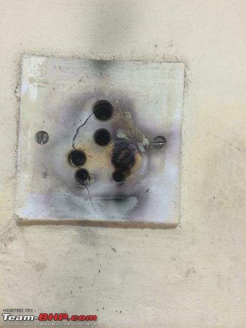

My electricity woes are back. Our 3KW V Guard storage water heater just burnt the socket and plug.
The home / office air-conditioner thread-imageuploadedbyteambhp1421576831.920954.jpg
The home / office air-conditioner thread-imageuploadedbyteambhp1421576853.055329.jpg
We have a DB board with MCBs and recently I installed overload protection. It is a rented house. Should I install local protection at the Geyser line level so that this melting of wires and sockets can be avoided? Do I need a RCCB or RCD device at full house level to prevent this? I don't know why the heat in the line didn't trip the MCB on the DB or whether it is even actually meant to?
The problem is the socket/plug interface. If it is slightly loose, sparks will cause the damage you see. See if you can install the Compton-Greaves metal socket/plug set. That is what we use for all our AC's.

@diyguy; @Aroy is correct. There are many plugs in the market with single piece pins (Northwest & Crabtree to name a couple) of brass. These do not have this problem. I never faced this once I switched to NorthWest. The common ones have two pice pins which screw into one another. Incidentally, NW also have 25A plugs and sockets. The matrix is identical to the 16A but the pins are longer. For the past decade I have not used any plugs except for these two (90%NW) in my house, other than premoulded ones of course.
@sgiitk and @Aroy, thanks for the responses. Is such a device a deterrent and can it prevent loose contact based sparking and potential damage/hazard?
http://www.nfpa.org/safety-informati...t-interrupters

What happens the pin and the inside part which are screwed into one another become loose, and then sparking leads to what you have witnessed. Of course with a one piece pin this does not happen and this guards against a lot of problems. As I said since I switched to NW or Crabtree I have had to plug (or socket) failures.
