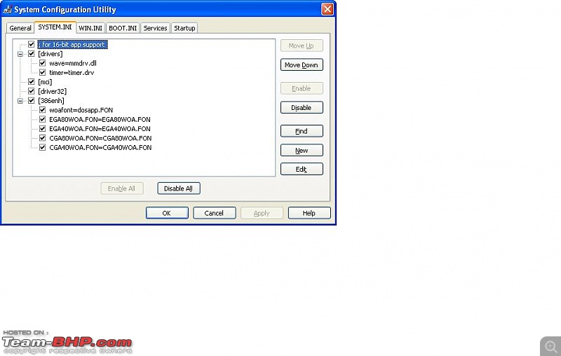

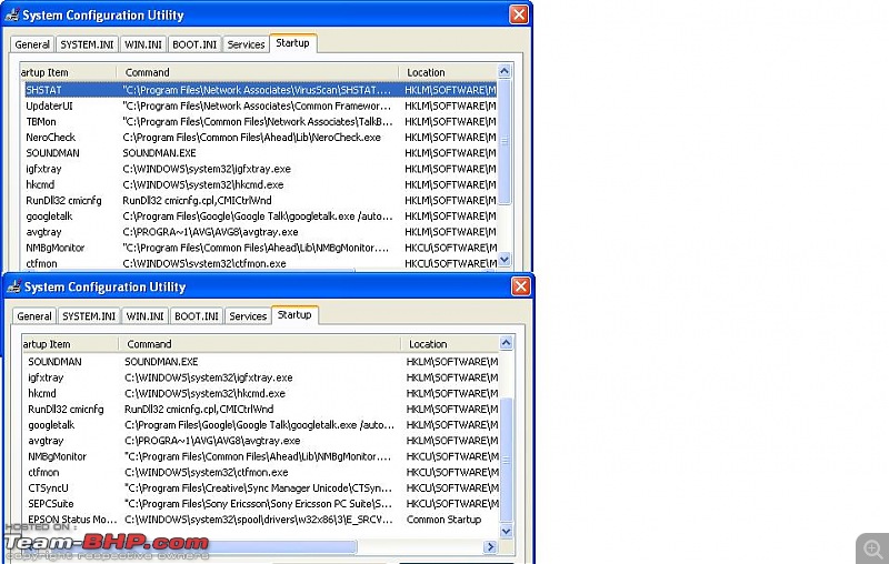

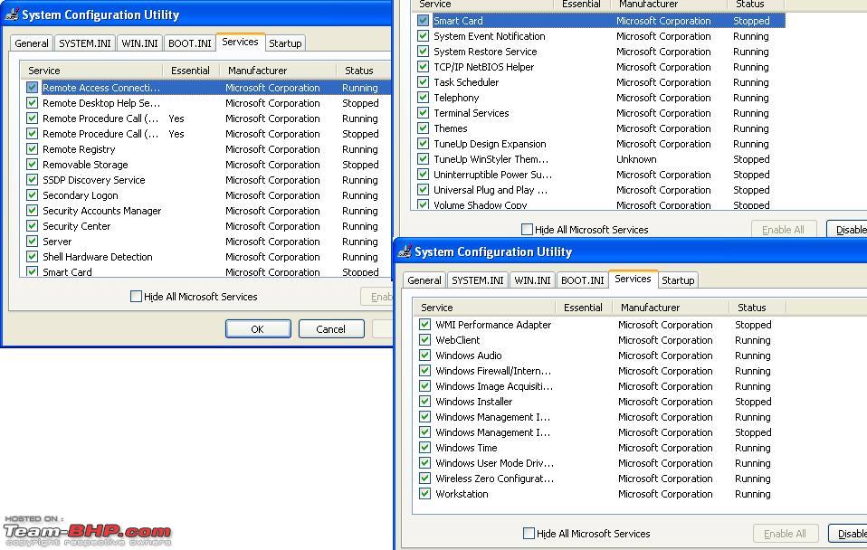

@toiingg - Hi. Here are the screen shots of the current status.
Do you see anything wrong.
I am still getting a few pop ups b AVG on some minor virus threats.
I did a McAfee check on C drive and it found a virus but was unable to clean, delete or move it!!!! Will try running a new scan by AVG again.
I have a feeling that AVG has cleared most of the virus. However I am not expert and this is just a feeling.
Most Important: thanks to all for the advice.

I can't see anything wrong in this. Msconfig is not good enough to show everything.

RAC
In the 1st pic which you have posted just now,see the 8th file rundll....this is a virus,it has been renamed due to its coding.Dont trust AVG free a.v,it has a habit to show min.of 4-5 virus when you scan it for the 1st time,try this.
Download Spybot-search & Destroy,update it and scan your p.c,it is not a.v but antispyware but try it and I am 100% sure that you will able to clean your system,post your comments after doing scan.Good luck to you.

Originally Posted by ECM View Post
RAC
Right! it is a virus, you can try to uncheck it in safe mode.

1) you can't see it in your screenshot as the scrollbar is slightly towards the right. The checkbox is always there, just scroll left.

@RAC,
Do not bother about RunDll32, it is a valid file for the C-Media (sound) card. Now, unless you do not have a C-Media sound card, this is not a virus. A Google gave this info and I believe it.
