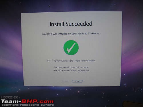

d. On the Install Succeeded screen, before the timer reaches zero, open up Disk Utility again from Utility menu. Click on the OSX partition and click on "Repair Disk Permissions". Then close Disk Utility and let the laptop reboot.
After this i had to go to bios and change back the SATA setting from ATA to AHCI.
