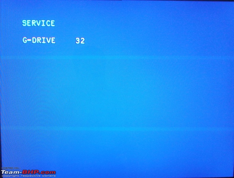

Anyone Owning ONIDA Oxygen Thunder 29 - Need Service settings
Anyone owning a Onida Oxygen Thunder 29 inch, please acknowledge.
I need the service settings of this model, I will tell you how to goto Service Mode and then either manually record or take pictures of the screen with the setting.
To goto Service Mode, take the remote and press "Disp" key (marked alternatively as "C" on it) and "Zoom/R+" key (marked alternatively as "VSM" on it), press both keys together for 2 seconds, you will see "Service" menu with GTV1000 written on the screen.
Now press the "UP" arrow button above the "OK/menu" button to browse through the Service settings one-by-one.
Do not use any other key since you dont want to change anything. Just keep pressing "UP" key and either manually write down the values against each settings or better just take a photograph of the screen(its less tedious). You can move to AV mode before for clarity of the display.
Keep scrolling up the screen, till you get to the GTV1000 line written. You have reached the top of the menu screen and to exit just switch off TV by using the power button.
Let me thank you for the effort and it might take your few minutes of time. Just hoping someone owns it here.
PS. Use only the "UP" arrow key to scroll the menu, dont use any other key lest you accidently change any setting and if unsure just switch OFF and switch ON again.

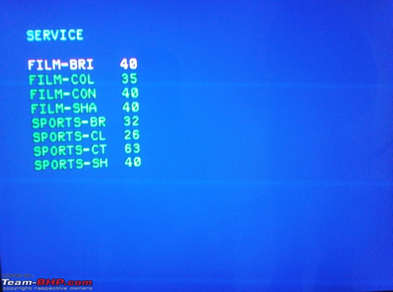

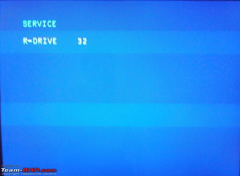

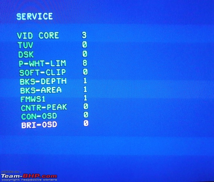

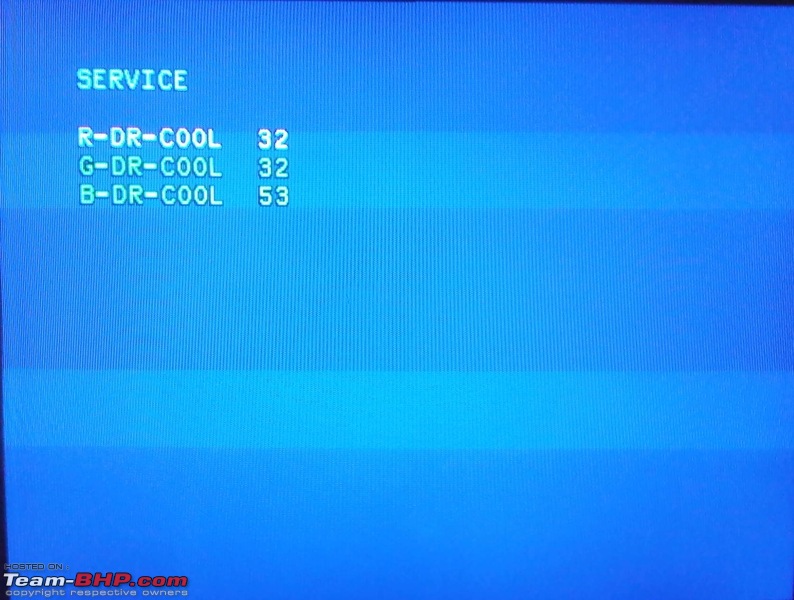

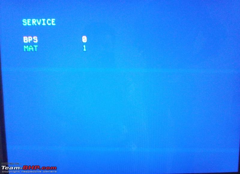

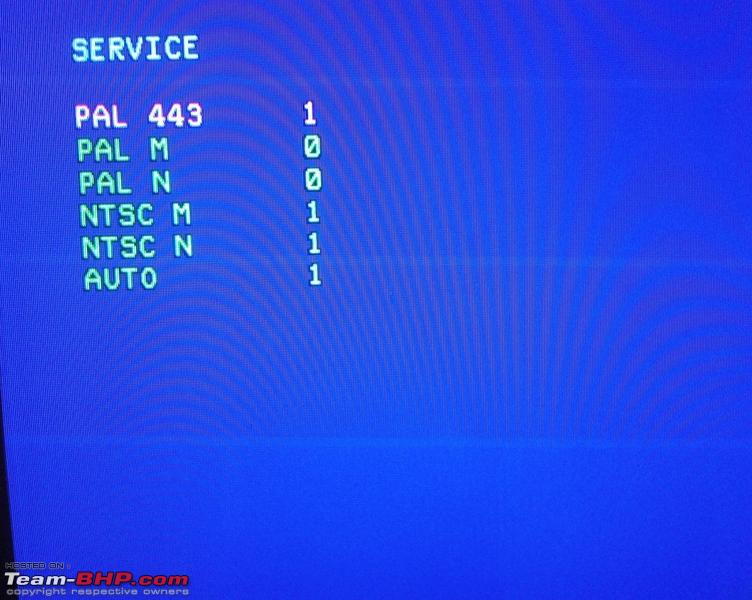

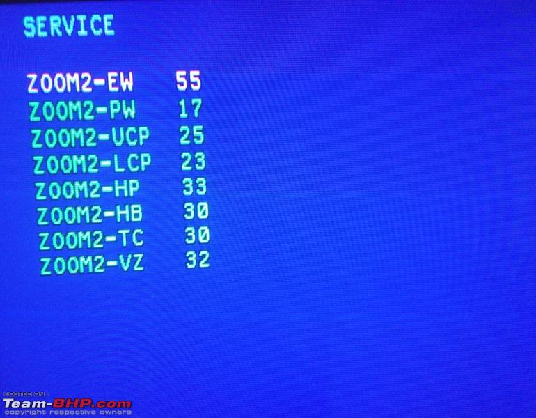

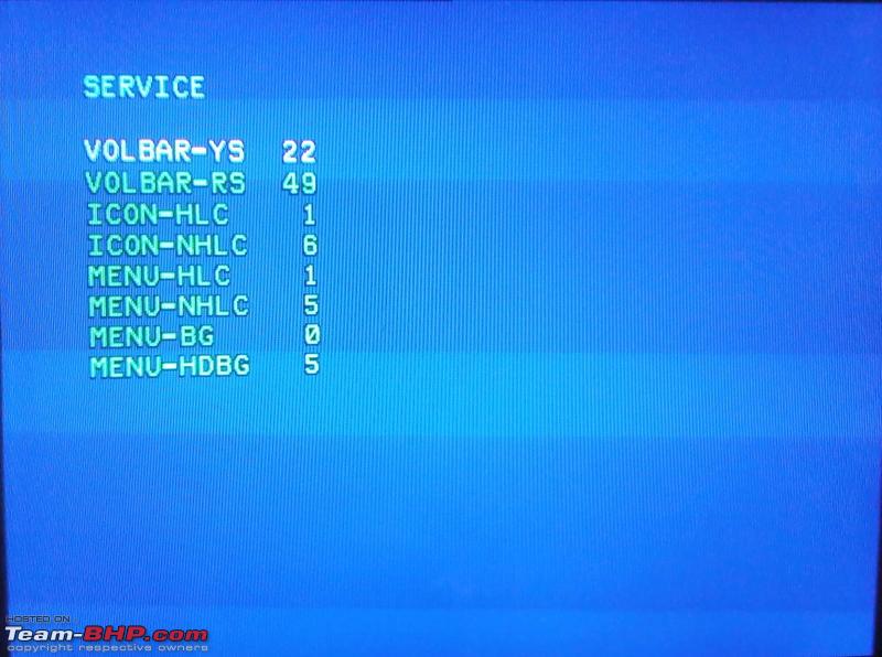

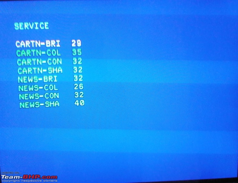

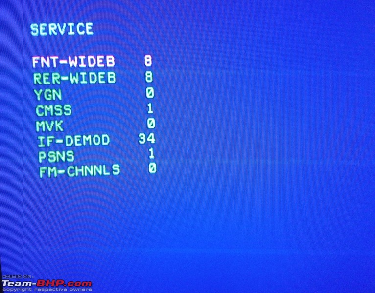

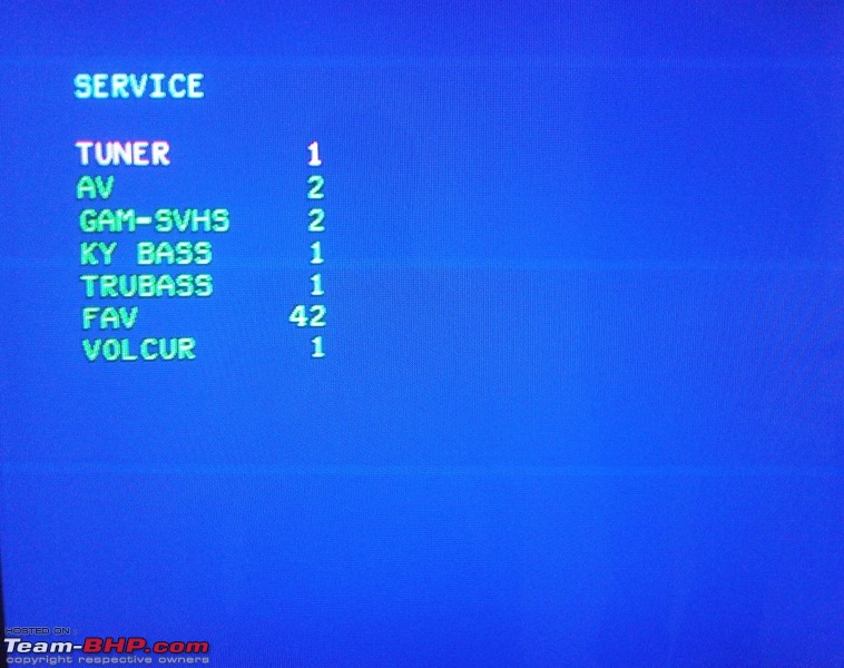

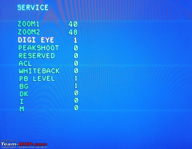

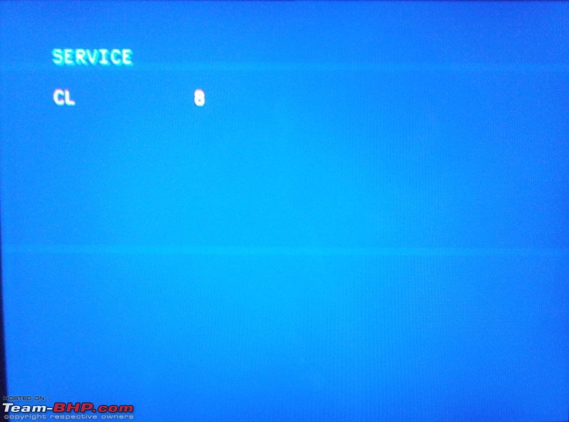

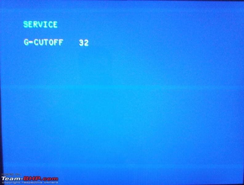

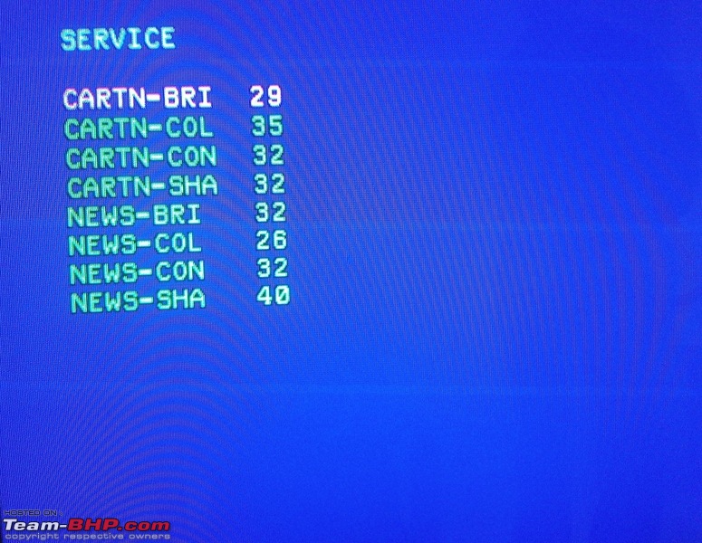

Finally the solution
Spitfire nice talking to you yesterday, unfortunately we couldnt invoke the service menu and thanks lolithrao, Sajo for your inputs.
I found someone owning similar model and upon inpection of the menu found it was the same. but there also couldnt invoke the Service menu from his remote.
Activated Plan B : Bring my own remote and vola here is the factory Setting for Onida 29" models using the GTV1000 firmware.
So here we are:
To be contd...
dadu is offline
Old 7th May 2010, 16:24   #15
Posts: 3,803
Thanked: 463 Times
Even though you use these ones, it cannot be a perfect match as its a magnetic field you are trying to configure and might need minor adjustments here and there yourself.
Also you might not get all the values in your sets Service Menu even though its the GTV1000 firmware used in most Onida models 2006 onwards, as they keep upgrading the features too, so just use the ones that match.
