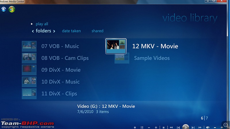

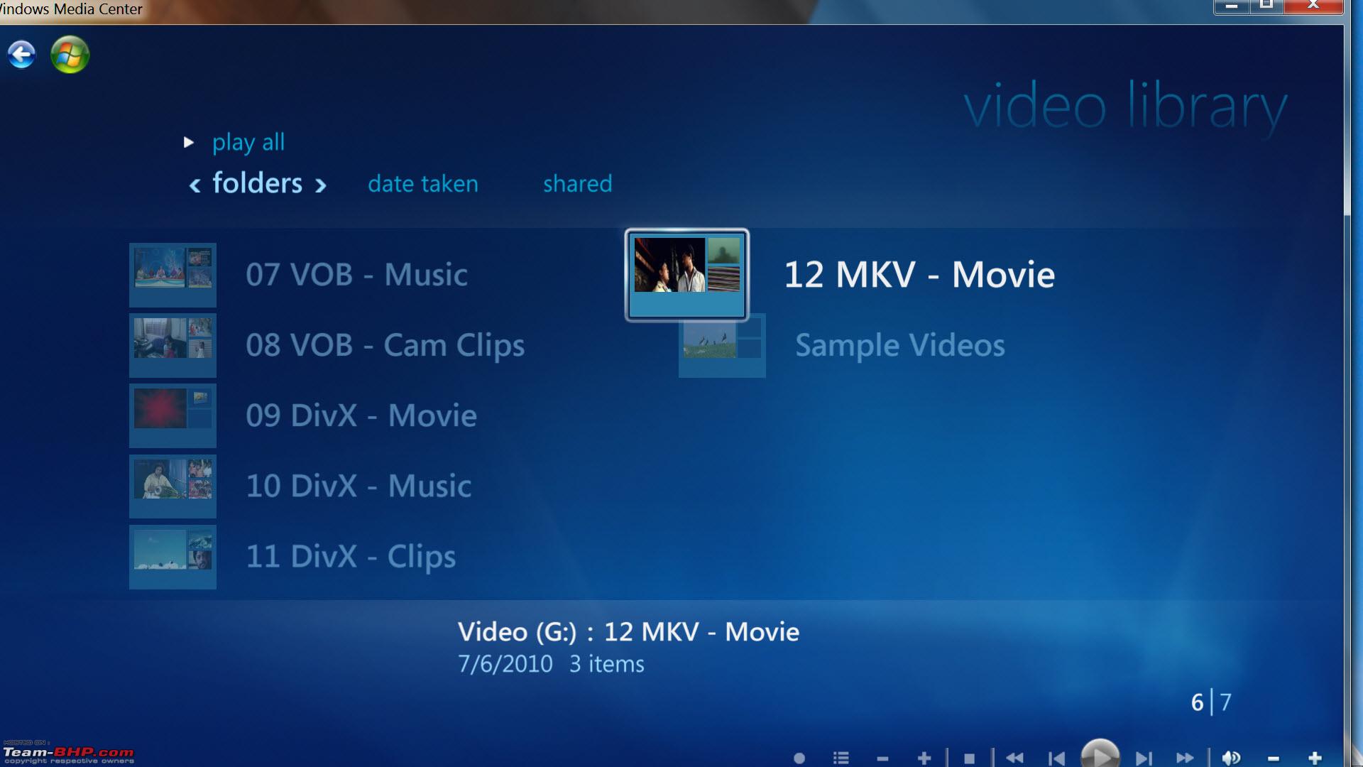

That said, Windows 7 does not provide native support to .mkv files - and many other formats. That is where the Swiss Army Knife of codec pack, the Shark 007 Windows7 codec pack comes in. Please see my post #14 in this thread.
The movie image is a .mkv file being played (though not HD) with Shark007 Codec pack installed. The only settings I changed in the Audio tab to get 5.1 channel SPDIF output is also shown there.
Add your .mkv folder to the Video Library in 7MC. You will be ready to go roaring.
