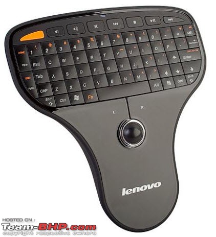

I missed a key peripheral that will go with the system.
Lenovo Multimedia Remote with Keyboard - USD 59.99 from Lenovo Direct, U.S.A (not yet available in India; bought and brought by a friend a month ago) - will be reviewed alongwith the completed system.

the keyboard image you uploaded look interesting.
i am not sure about the use-ability of that in a living room application.

A mini wireless KB with trackball mouse with good range is absolutely essential for a living room PC. The HTPC can also be used as a normal PC. One has to increase the font size, icon size, etc., in Windows Appearance
for the large size TV/monitor and then you can operate comfortably from your TV viewing distance. Short of typing long texts, you can do all other tasks that you normally do on a desktop and that includes web browsing. I have increased the zoom level in IE to 150% for viewing on my 42" LCD TV. Coventional large wireless keyboard/mouse occupy a large space on your coffee table and out of place there. Further the limited range forces one to get out of his seat and move nearer to the HTPC for it to capture the key strokes. I have experienced these problems practically before calling upon my friend in U.S.A to bring the Lenova Remote KB. I shall post the real pictures that will reveal its mini size.

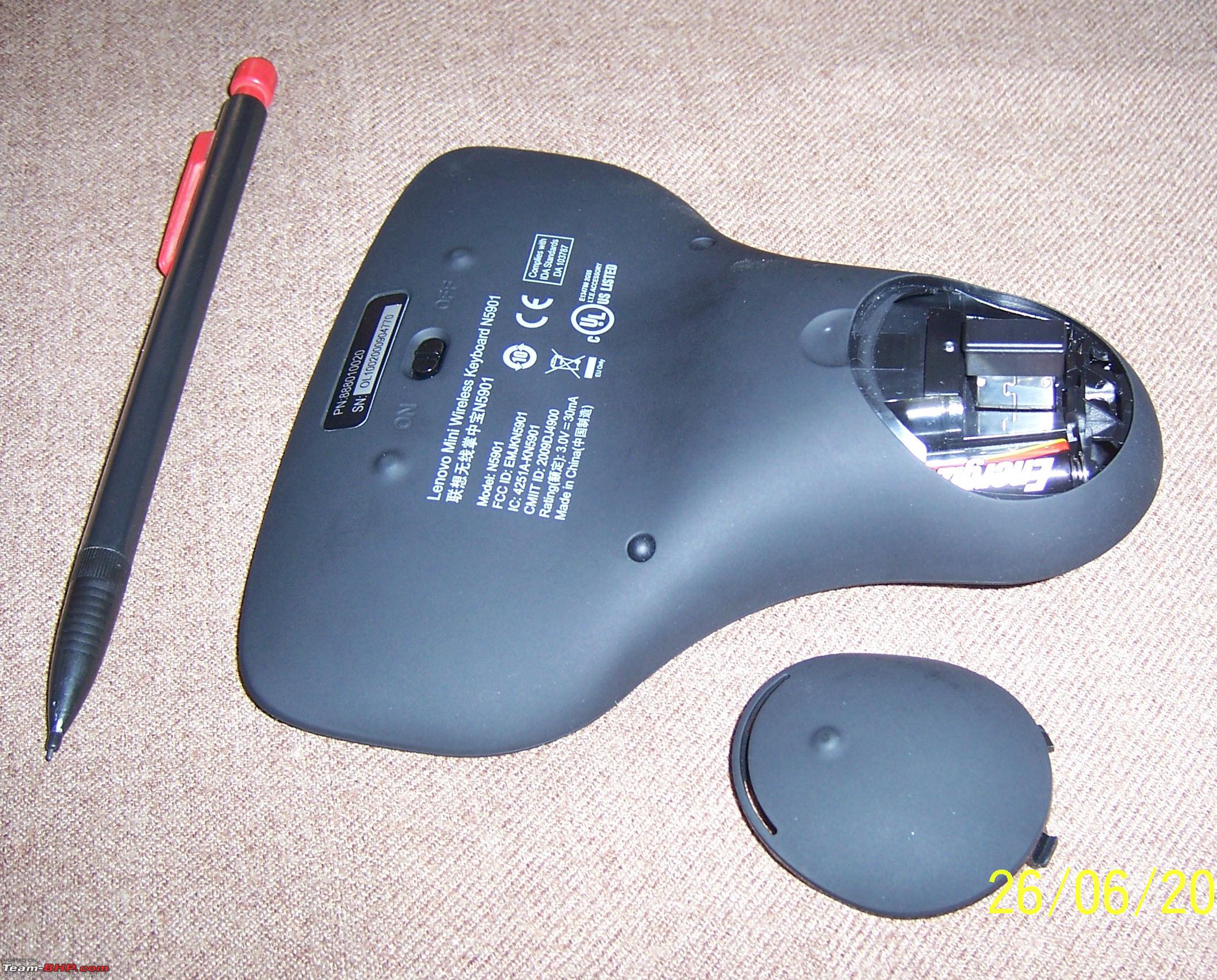

4. The RF mini Keyboard/Trackball mouse:
5. The tiny USB RF receiver:
Note the small ON/OFF switch on the top of the KB.
A tiny USB RF receiver fits into a slot in-between the batteries in the battery compartment for safe-keeping when not plugged into he CPU's USB port. Leave it out and you are sure to lose it.

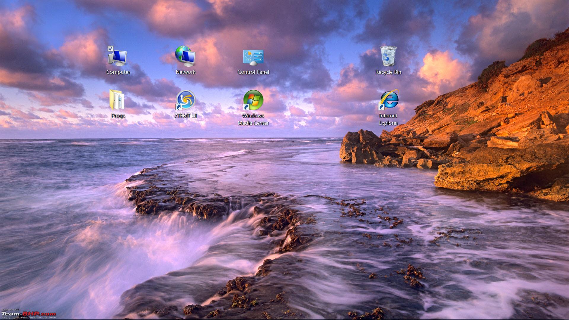

The Desktop:

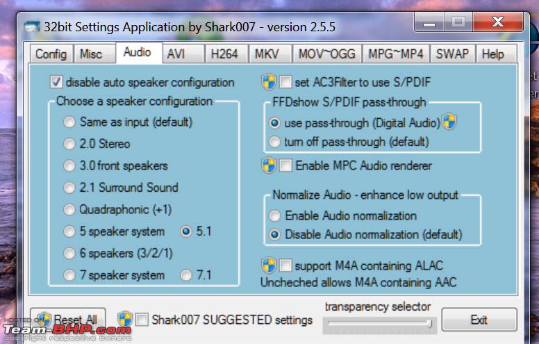

Shark007 codec: (the only selections I made in the Audio Tab)

No stutter, no skips, smooth play all the way with 5.1 surround. Have a popcorn and enjoy. :)

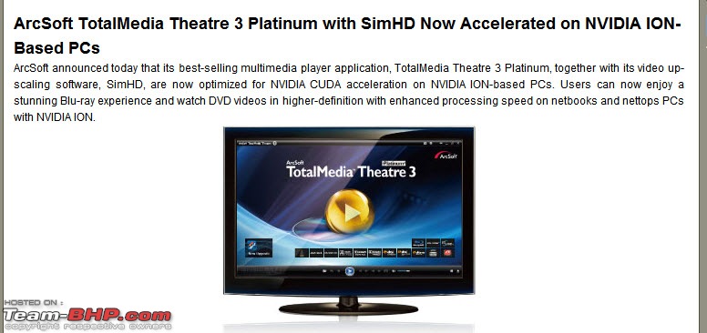

With my Zotac Zbox HD-ID11 build almost nearing completion, and with the external Sony Optiarc BD ROM BC-5500S USB drive on hand (delivered on 03 Jul 2010), I started looking for the best software BD player. (WMP/WMC7 do not natively support Blu Ray.)
With the Corel WIN DVD, Cyberlink Power DVD and Arcsoft TotalMedia Theater equally rated with only some minor differences such as included codecs, ease of use etc., the one aspect that tilted me in favour of Arcsoft TMT was this Jan 2010 news item that read:
When I reached the Arcsoft website, I was pleasantly surprised to find that Arcsoft is giving a 35% rebate on their products in celebration of U.S. Independance Day celebrations on 04 Jul 2010. This offer is valid for 3 days till 07 July 2010. (U.S. time - whether ET, PT,MT or CT not mentioned.). No sooner I was poorer by USD 65, though I saved 35. ( List price USD 100.)
It integrates well into the Windows Media center better than the other two as per expert reviews.
Anyone who wants a Software BD Player may use this opportunity - but do read all three player reviews before putting out your cash.
