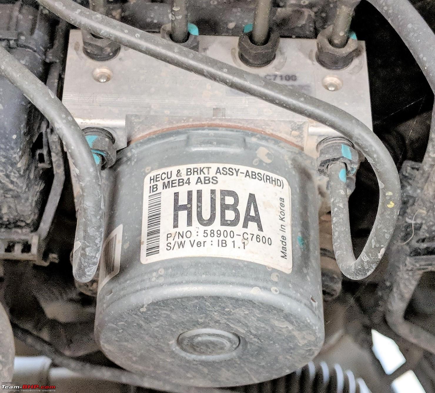

If any one can share photographic evidence of Hyundai Mobis unit in above cars
Here you go, Part no and Software version. Sep 14 Elite i20 Asta Diesel ABS unit.

Thanks for the picture.
HUBA is Swiss company. Their website doesn't list whether they manufacture ABS products but they are into manufacturing of sensors.
IB is the code for Elite i20 vehicle.
I am little bit confused. Frankly, MEB4 stands for Mobis Electronic brake (4th gen) but it has to be manufactured by Mobis and not by other supplier. Can someone more pictures of ABS units from Hyundai cars? I would prefer pic from Elantra for quick comparison.
