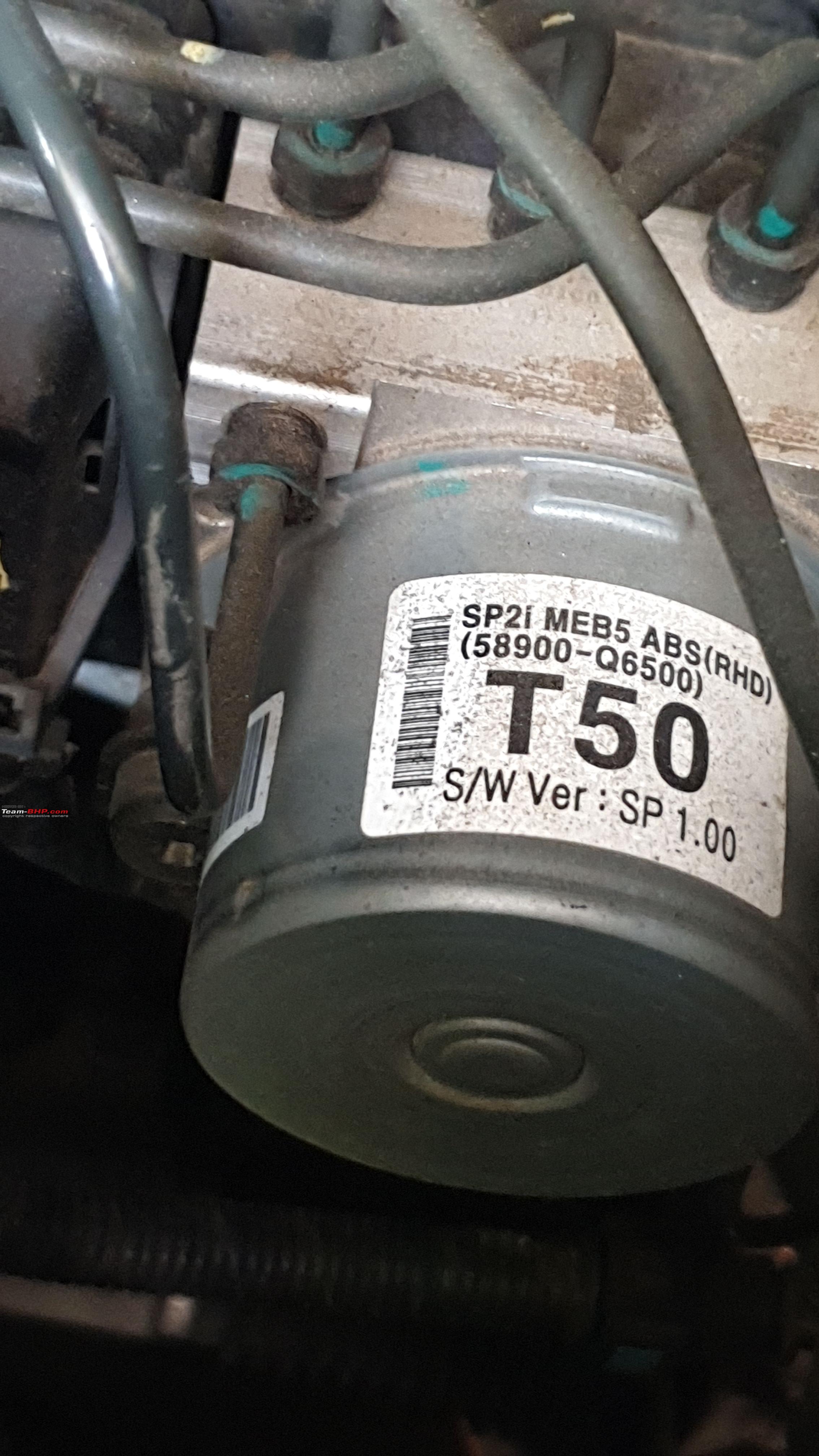

Originally Posted by naveen.raju (Post 4911529)
I think this batch of Seltos used the same ABS vendor as the first gen Creta. (The 2020 Creta now use a new vendor).
Hello Naveen, Both the cars in question are Feb'20 make, both NA petrol - one a 6 MT and other an IVT. Details as below.
Originally Posted by Bibendum90949 (Post 4910261)
Coming back to the topic, i've the VIN of both these cars. Few common things.
1. Both are manufactured in Feb'20, 6th and 12 th.
2. Both have all four discs.
3. All these issues which had taken place are at slow to very slow speeds.(30-40-50 kmph range).
Point 1 could just be a coincidence, may be not.
Originally Posted by PYSO (Post 4911533)
Does anyone know who the previous ABS vendor was? And who the new ABS vendor is? Is there some way to confirm that the vendor has actually changed, perhaps from the parts catalogue or by physically examining the parts.
In fact bhpian a4anurag reached out today morning on this and this is what I could find in the ABS unit of my Seltos, attaching the image below. Old gen Creta ABS was supplied by Georgia based Mando America Corporation as shared by Anurag. I guess he has some findings to add on here.
