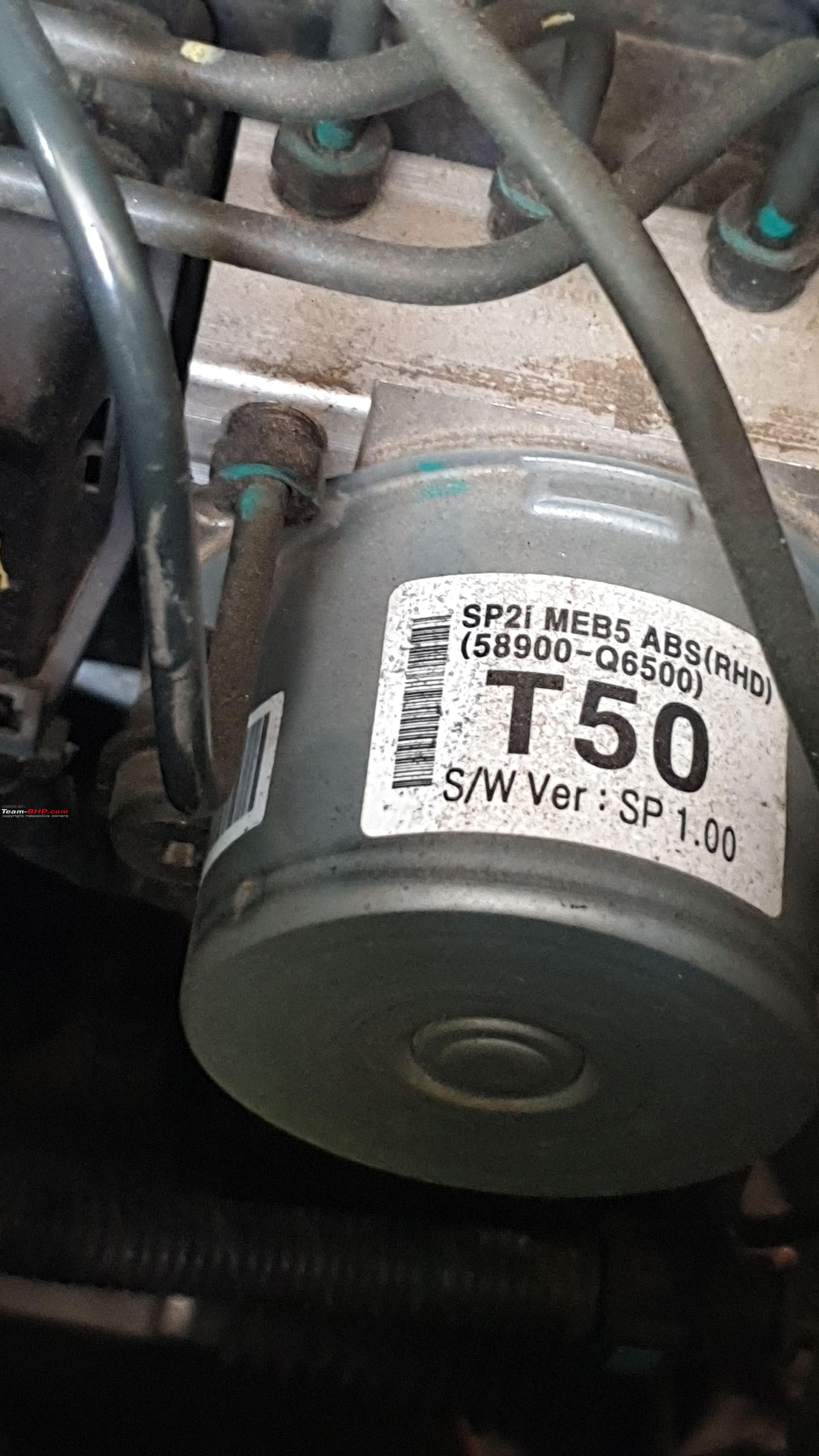

In fact bhpian a4anurag reached out today morning on this and this is what I could find in the ABS unit of my Seltos, attaching the image below. Old gen Creta ABS was supplied by Georgia based Mando America Corporation as shared by Anurag. I guess he has some findings to add on here.
Attachment 2069755
Thanks for sharing the pic of by the ABS unit of your Seltos.
Anyone here, who can figure out the vendor of this unit from the attached pic?
Three questions worth figuring out
1) Was Mando the vendor of ABS unit of initial batches of Seltos
2) Has the vendor been changed in the recent batches of Seltos
3) Has the vendor been changed in the new Creta 2020
If the vendor has been changed by either or both Seltos and Creta, then it's perhaps a mea culpa from Kia/Hyundai. It likely means that the old ABS unit was unsatisfactory. Old Creta/Seltos owners could then push for a free change of ABS unit from Hyundai/Kia (to a ABS unit sourced from the new vendor).
Mods, sorry for the back to back posts. Please merge them into one.
