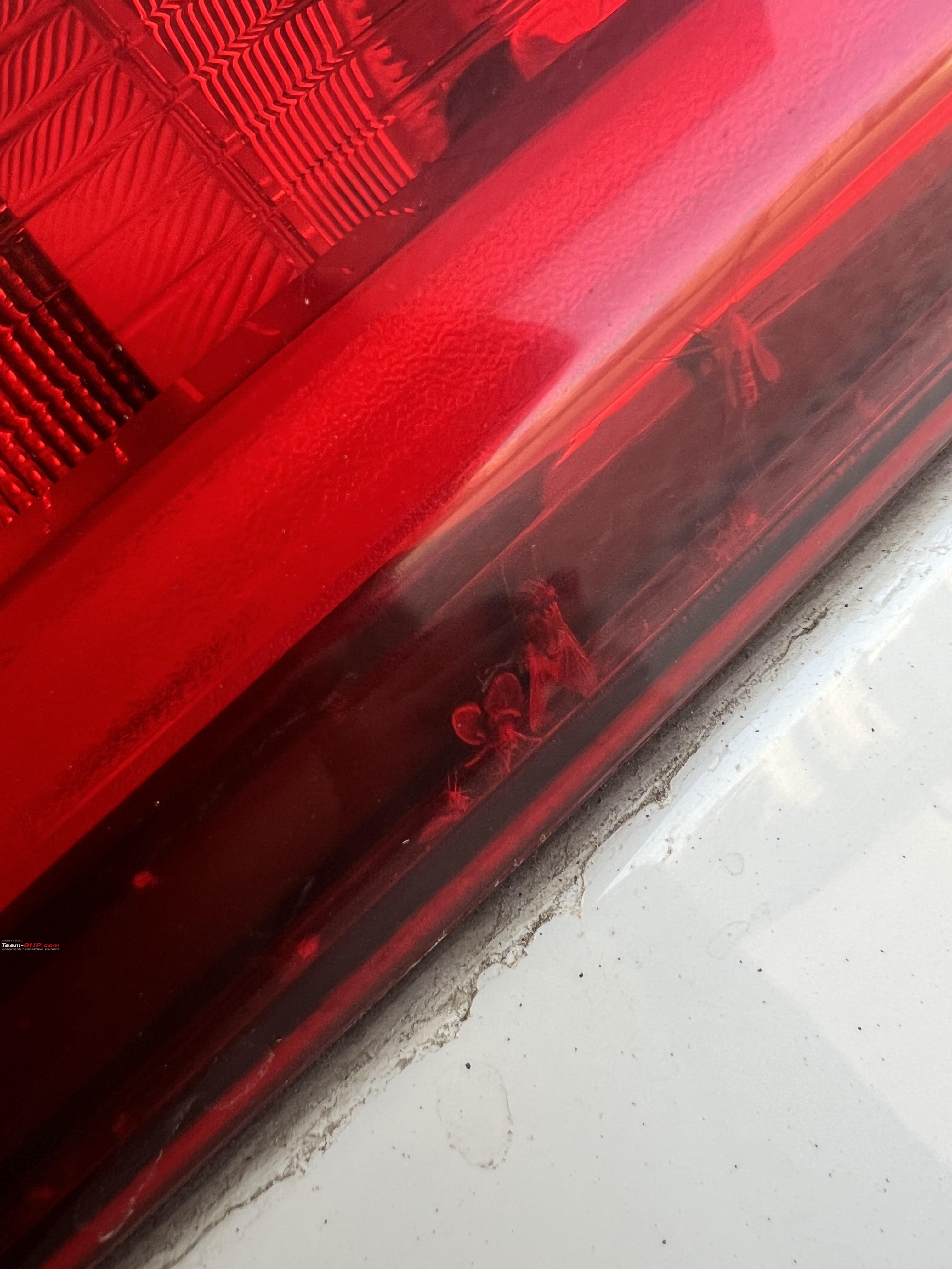

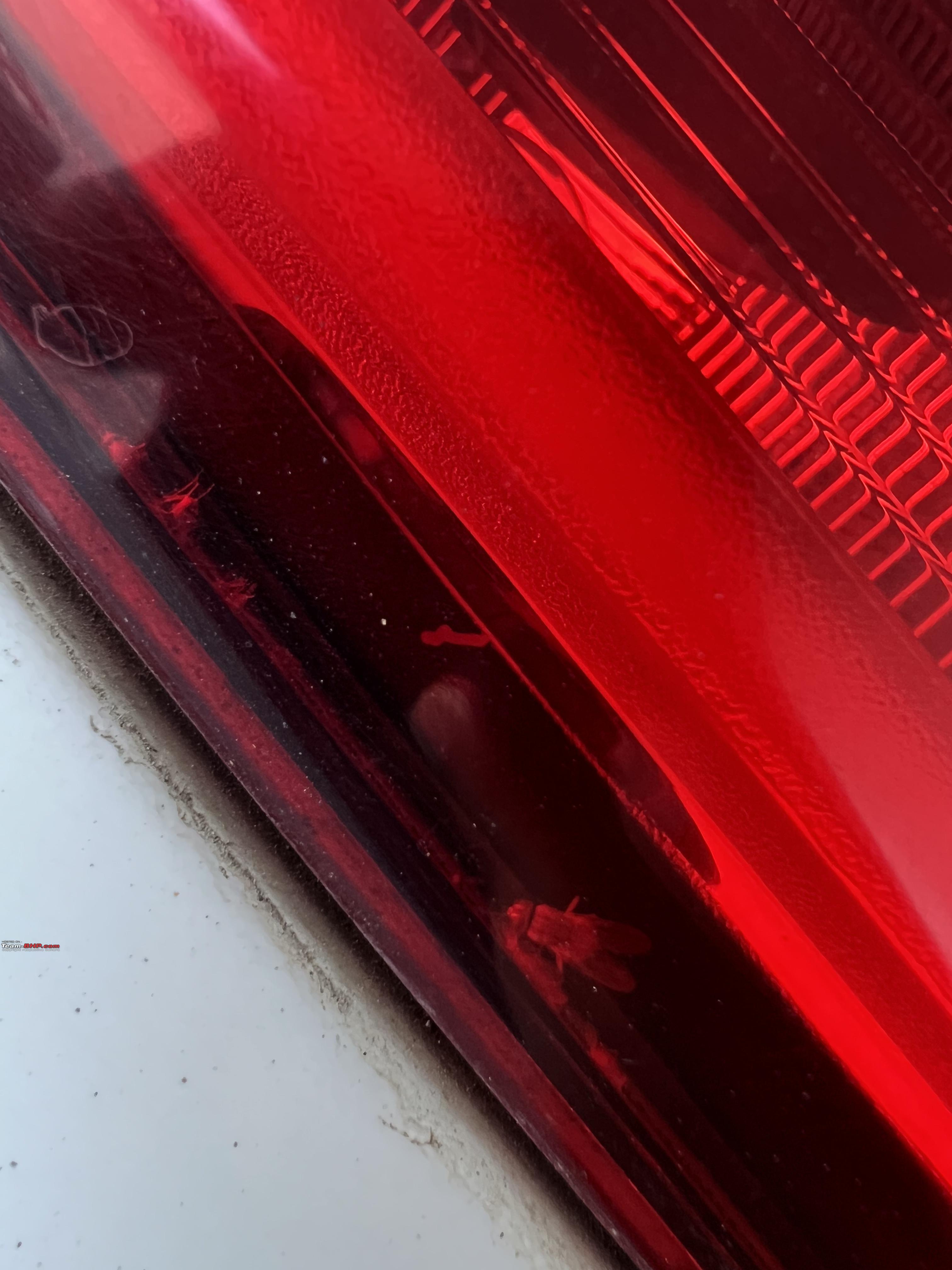

Both rear led lights have bunch of bugs trapped in them. Shouldn’t this be sealed? Any fix?

These are not sealed so as to allow any condensation to evaporate. I have had the same thing happen on my X1(bugs trapped in tail lights), and the service technician removed the light and got the bugs out. Seems like a common occurrence looking at his expertise in this matter. Especially considering I had not noticed anything and they took care of it on their own.

BTW, the tail lights are well sealed at front but have openings at the back, which can be seen by taking off the panels on the backside(in tailgate), there is enough space to get them out.
This is not a quality problem but a design flaw.

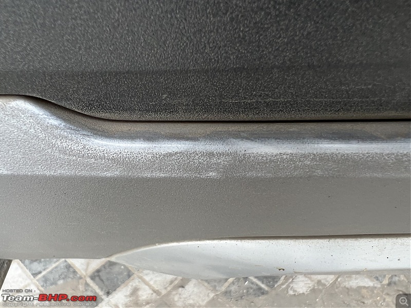

Quality problems is not limited to just the lights. My car is barely 3 years old yet showing age of 10.

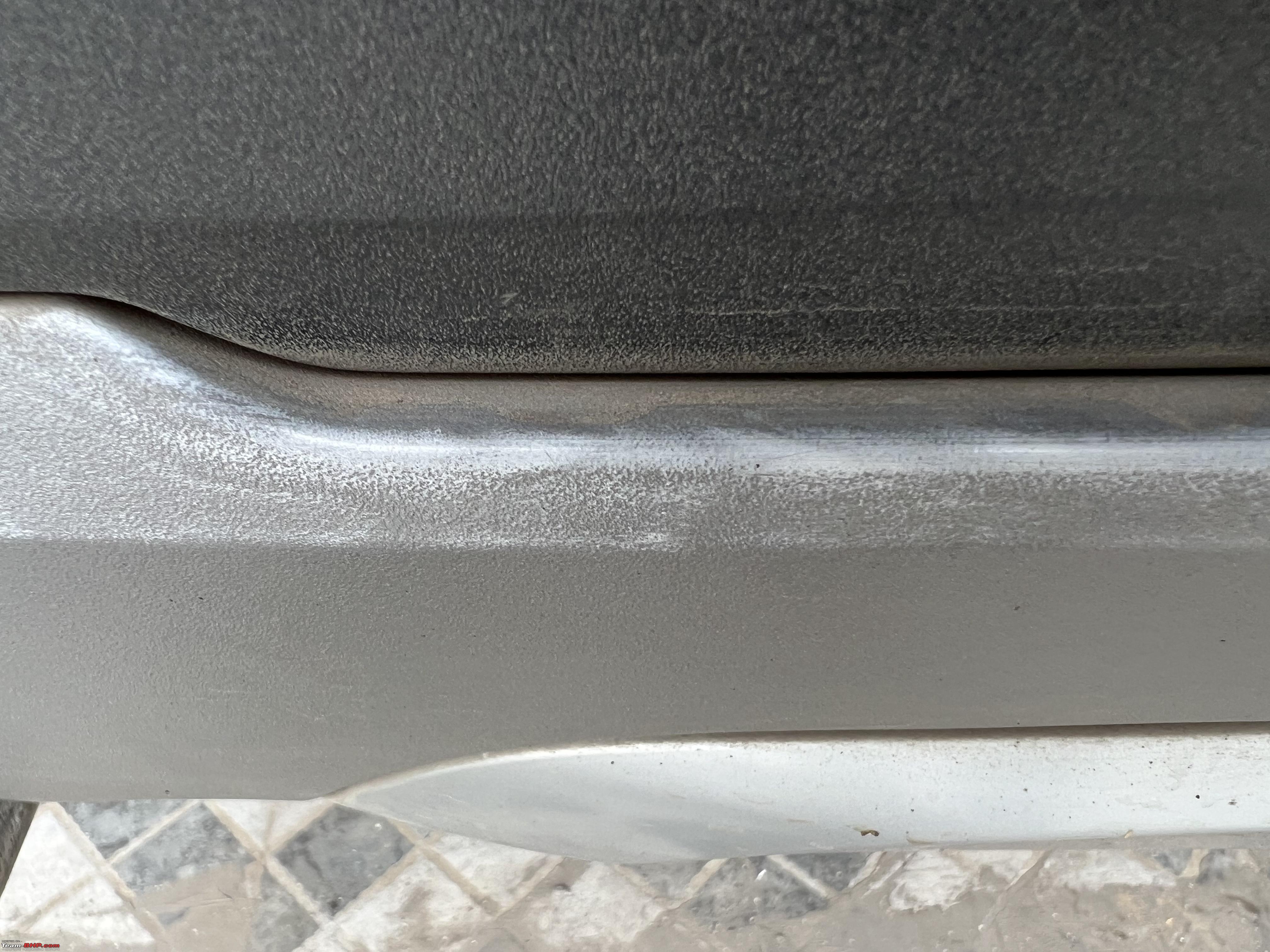

Plastic cladding paint coming off. This is not scratch or damage.

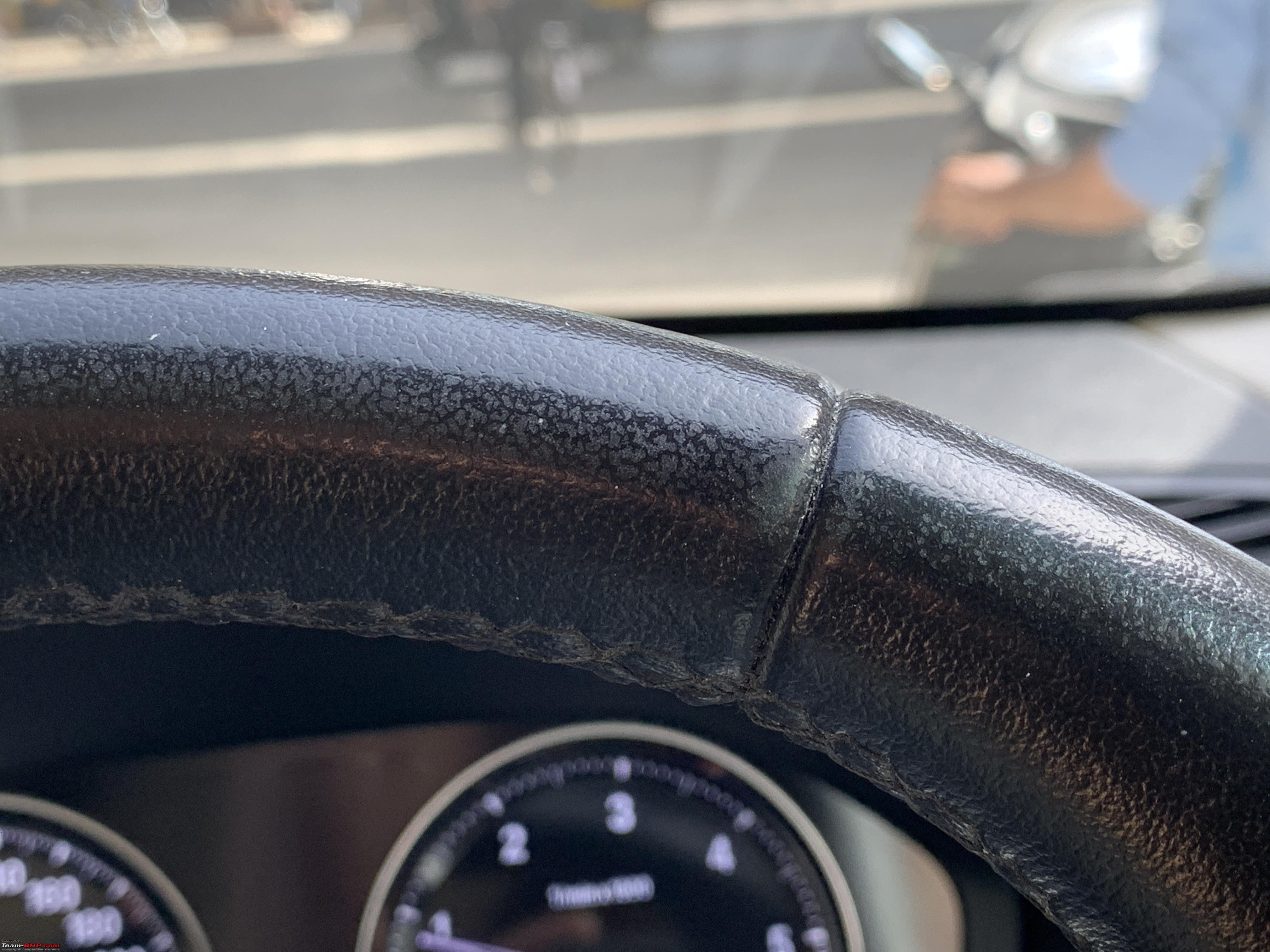

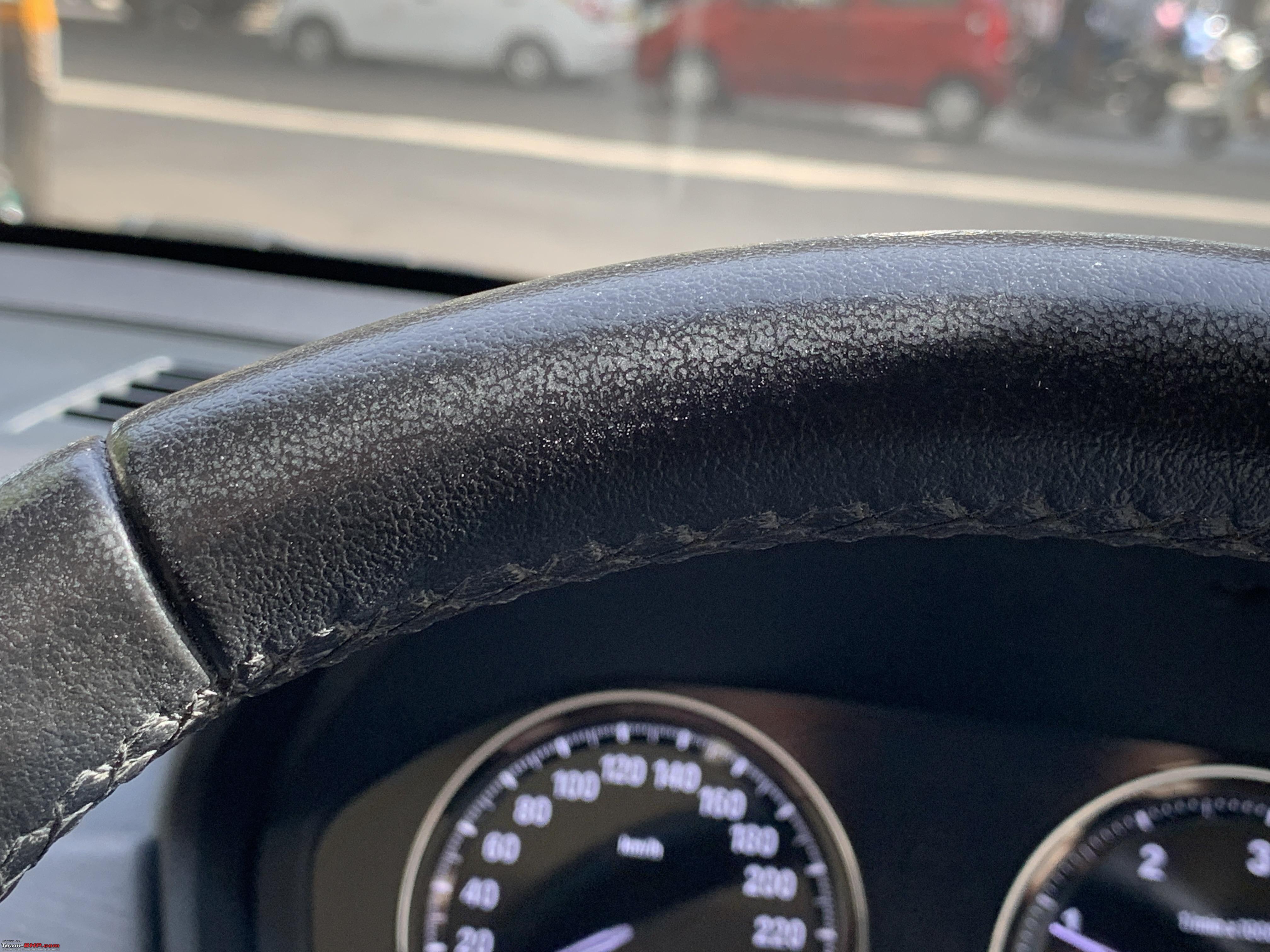

Leather steering paint coming off
BMW X1 Quality Problems | Bugs trapped inside LED tail-lamps-dd3142bf2ae04ca984b93ac81ff9eddc.jpeg

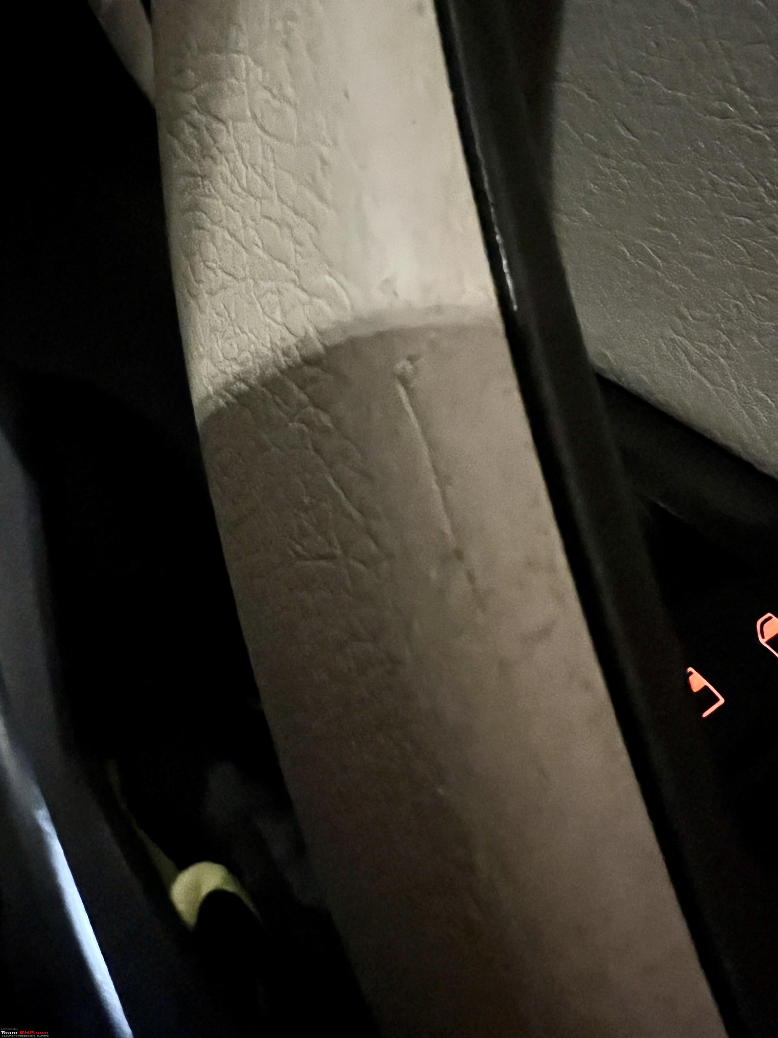

And the most prominent door handle melting. Almost all BMW’s are affected over a decade yet they continue to put substandard materials.

I think your car just needs some detailing work, mainly plastic restorer and would look much better. The Greying out of plastic can easily be fixed by any detail. Also, this sort of thing is common in any car that gets regular exposure to the hot sun. Try changing the parking spot if possible, that much help.
