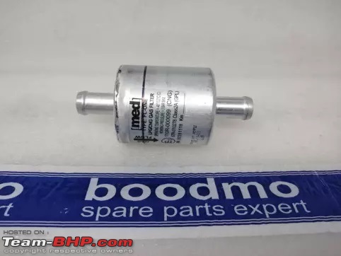

It is a well-known fact that the maintenance cost for CNG cars is higher than petrol cars. You need to follow the service manual to the T. In comparison, the maintenance of petrol cars is much more straightforward and forgiving. Here are some of the points you need to consider in terms of maintenance of a CNG car -
1. Air filter and spark plugs need to be replaced more frequently.
2. CNG-specific filters also need to be replaced regularly (Related Thread).
3. CNG Cylinder needs to get hydro-tested once every 3 years. This is a process to check the cylinders for leaks, structural flaws, durability and corrosion.
4. Even when a CNG car is out of warranty, you cannot give it to any neighbourhood garage. For any CNG-related issue, you need to take your car to either an authorized service centre or CNG-specific garages.

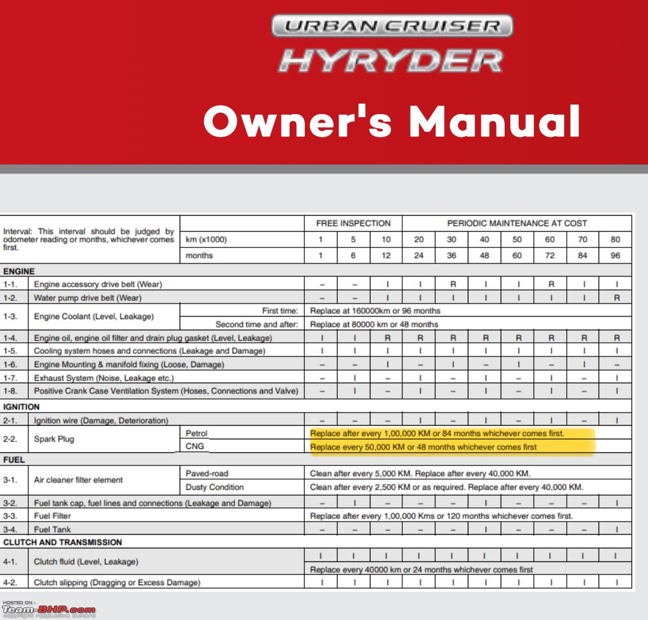

I agree about spark plugs, but don’t we all replace air filters every 10,000 km (or as per the recommended maintenance interval)? CNG spark plugs need to be replaced at 50,000 km, while petrol spark plugs need to be replaced at 1,00,000 km.

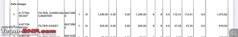

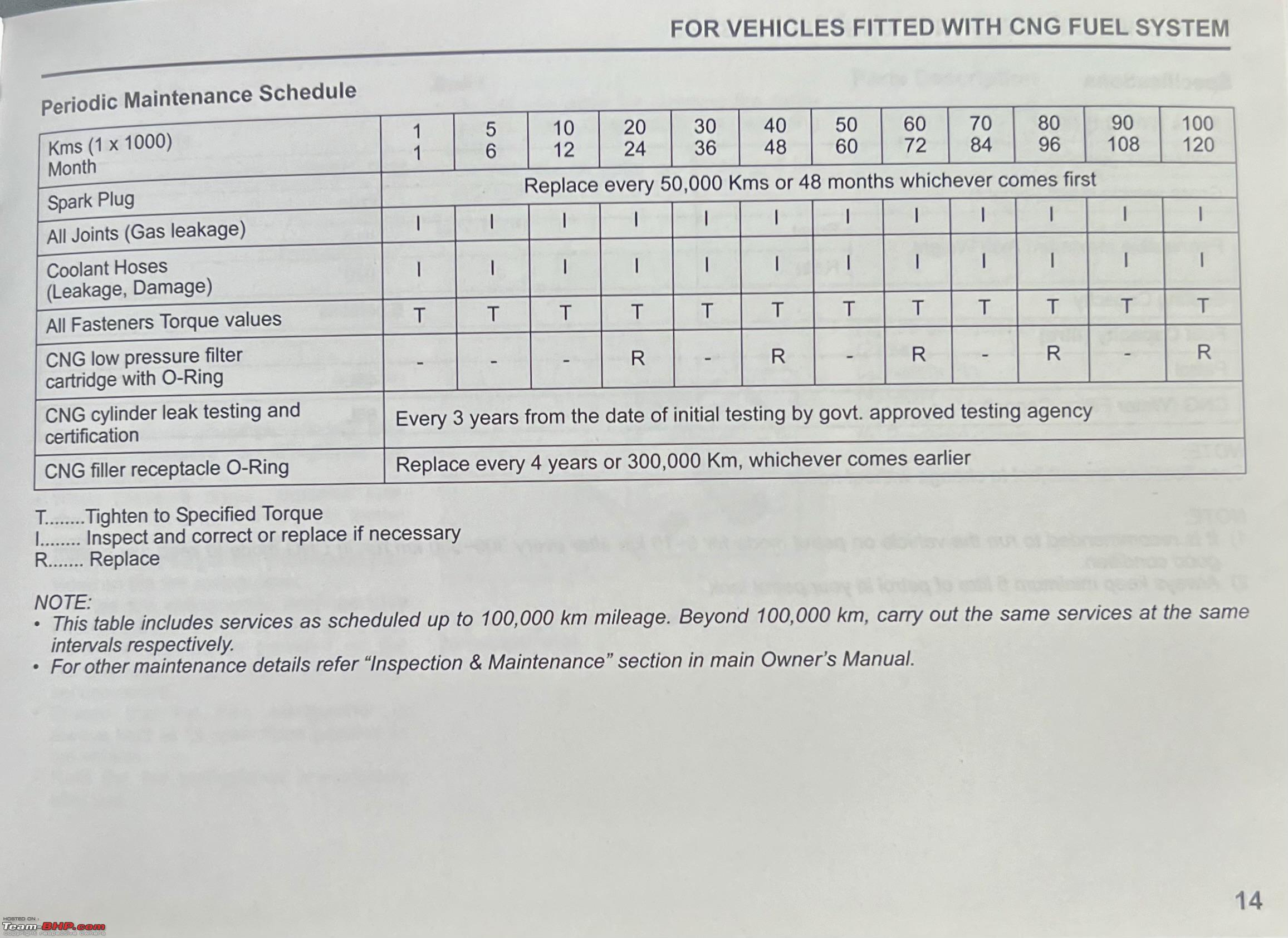

I have been following this. Have been replacing the filter every 20,000 km. The charcoal canister filter costs ~ ₹1500.
