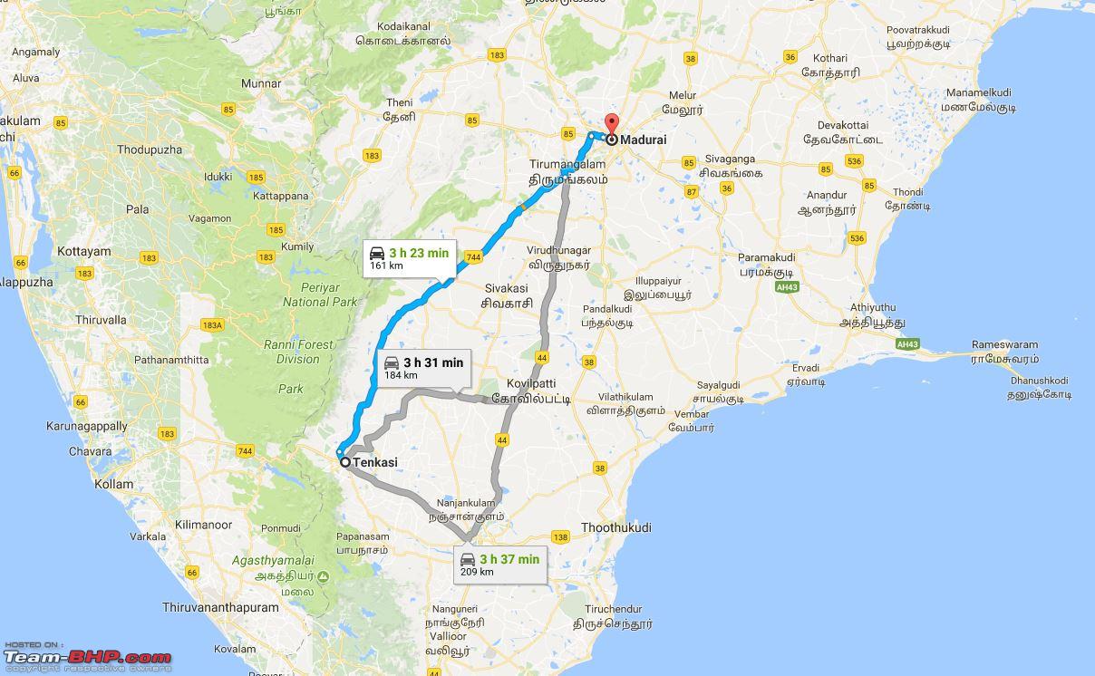

Ergonomics! Back Pain!
It can also happen when you seriously try to find justification to upgrade the car Just kidding!
Very thankful to his suggestion as the road in itself was brilliant, as the pics below would suggest. As of now - with the Marthandam section being under construction, it makes a lot more sense to take this route instead.
Glad you liked this route
Adding to marthandam flyover work, flyover work at Parvathipuram too has started, so this route is going to be a pain to travel all the hours of the day.
The highlighted signboard read - "Toll - 1 km"!
I faced this torture once and since then, I try my best to avoid peak hours during long weekends.
Originally Posted by narayans80 View Post
An evening-sundown drive of Tenkasi-Tirumangalam is not recommended. It sees heavy traffic resulting in average speeds in the order of 30 kmph. Keep options like Tenkasi-Tirunelveli or Puliyangudi-Kazhugumalai-Sankarankoil-Kovilpatti or Srivilliputtur-Sivakasi-Virudhunagar will help cause in case traffic goes bad.
Tenkasi - Tirunelveli and Tenkasi - Sankarankoil will help to cut down the 2L distance but time-wise it won't make much difference. I am not sure about the truck traffic though.

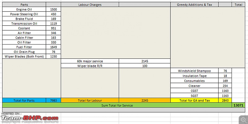

Billing -
A thin line between genius and insanity - Fiat Grande Punto 90HP - 2,00,000 km up! Edit: Sold-150kservice_2.jpg

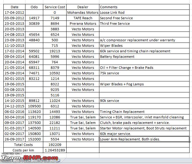

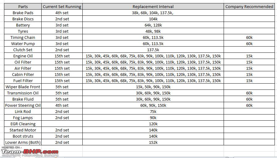

Service History -
A thin line between genius and insanity - Fiat Grande Punto 90HP - 2,00,000 km up! Edit: Sold-150kservice_1.jpg
A thin line between genius and insanity - Fiat Grande Punto 90HP - 2,00,000 km up! Edit: Sold-150kservice_3.jpg

Service Satisfaction - ****-
Service Centre - Vecto Motors, Bangalore.
May be I overestimated them by giving a 4/5. Whereas it should be a 2.5/5 or lower.
Reasons?
1. No news of the lower arm spares yet. It's been almost 2 1/2 weeks now. Will seek elsewhere if they don't have it by tomorrow.
Yesterday, I received a call from the SA that the parts have arrived. Went and got them fitted today morning itself. Had started from home by 8AM, but due to unexpected traffic conditions - reached only around 11 AM. The place was surprisingly crowded, possibly due to the upcoming festival holidays. Still, they were good enough to get the work done immediately and deliver the car around 12:45 PM.

Issues faced + Service Experience #24 - Suspension lower arm replacement @ 1,52,000 kms.
Brake pads replacement at roughly 35k km in your case. Does this figure vary on highways and city? My punto primarily does highway driving and the SA has said the first change should be at 45k km. The Abarth has done 34k as of now.
Regarding oil changes, I have a feeling that changing it at 10k km makes sense. I haven't yet observed a drastic deterioration in the quality, but after every servicing, the car feels a lot more fresh. Would you recommend a 10k interval or something like 7.5k for the Tjet? Car is 1.5 years old.
Once again, your detailed ownership thread is motivating me and giving me the confidence to hold the car for eternity .
The petrol engines use full synthetic oil and it should be good enough for 10K kms. So the 10K kms interval may coincide with the 1 year interval as well. No harm changing it at 10K kms, for MJD, 8k kms is more like it.
