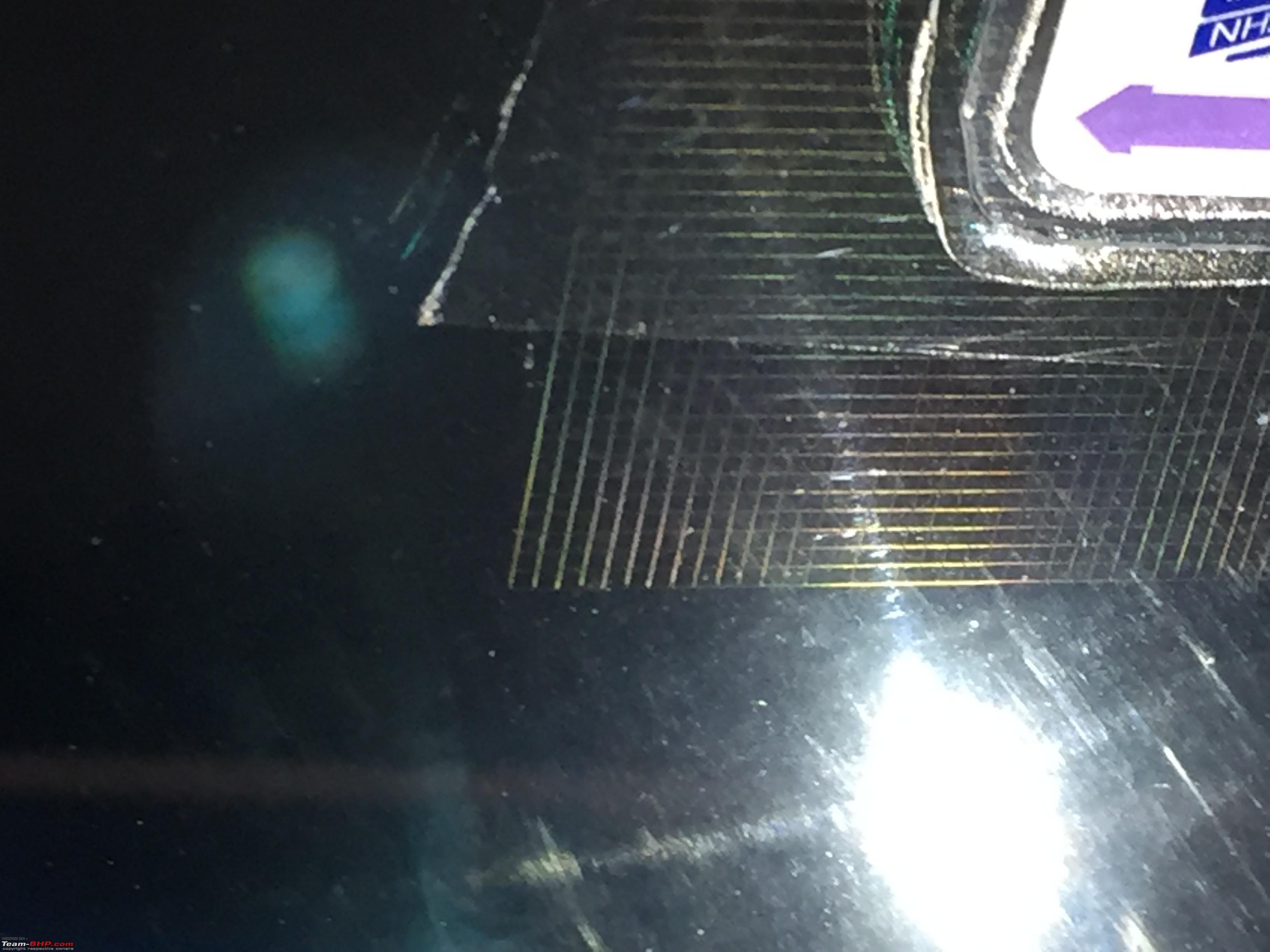

Here is a pic from my S class windshield. Easier to spot from inside the cabin. I have a 6"x4" patch with this pattern where I can place my tag and it works flawlessly.
Volvo XC60, D5 Summum AWD. EDIT: Sold at 9-years and 1,00,000 kms!-tolltagpatchonwindshield.jpeg
androdev is offline   (3) Thanks

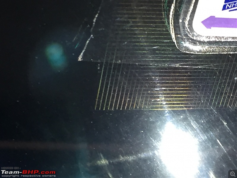

Attachment 2109953
I checked the manual and it says there is a heat-reflecting film (IR) which is an option/accessory. Picture attached. Guess that's why it is not affecting all the Volvos. The manual also says there is a non-IR covered strip on the top of the windshield.
I checked that from the inside of the car, and you can clearly see a line on top. It runs across the top of the whole windshield. Picture attached. You will note my FASTag is below that line. So guess I will have get a new one and to stick it above that line.
Volvo XC60, D5 Summum AWD. EDIT: Sold at 9-years and 1,00,000 kms!-fastag-2.jpg
Volvo XC60, D5 Summum AWD. EDIT: Sold at 9-years and 1,00,000 kms!-manual.jpg
manualManuel is offline   (1) Thanks
