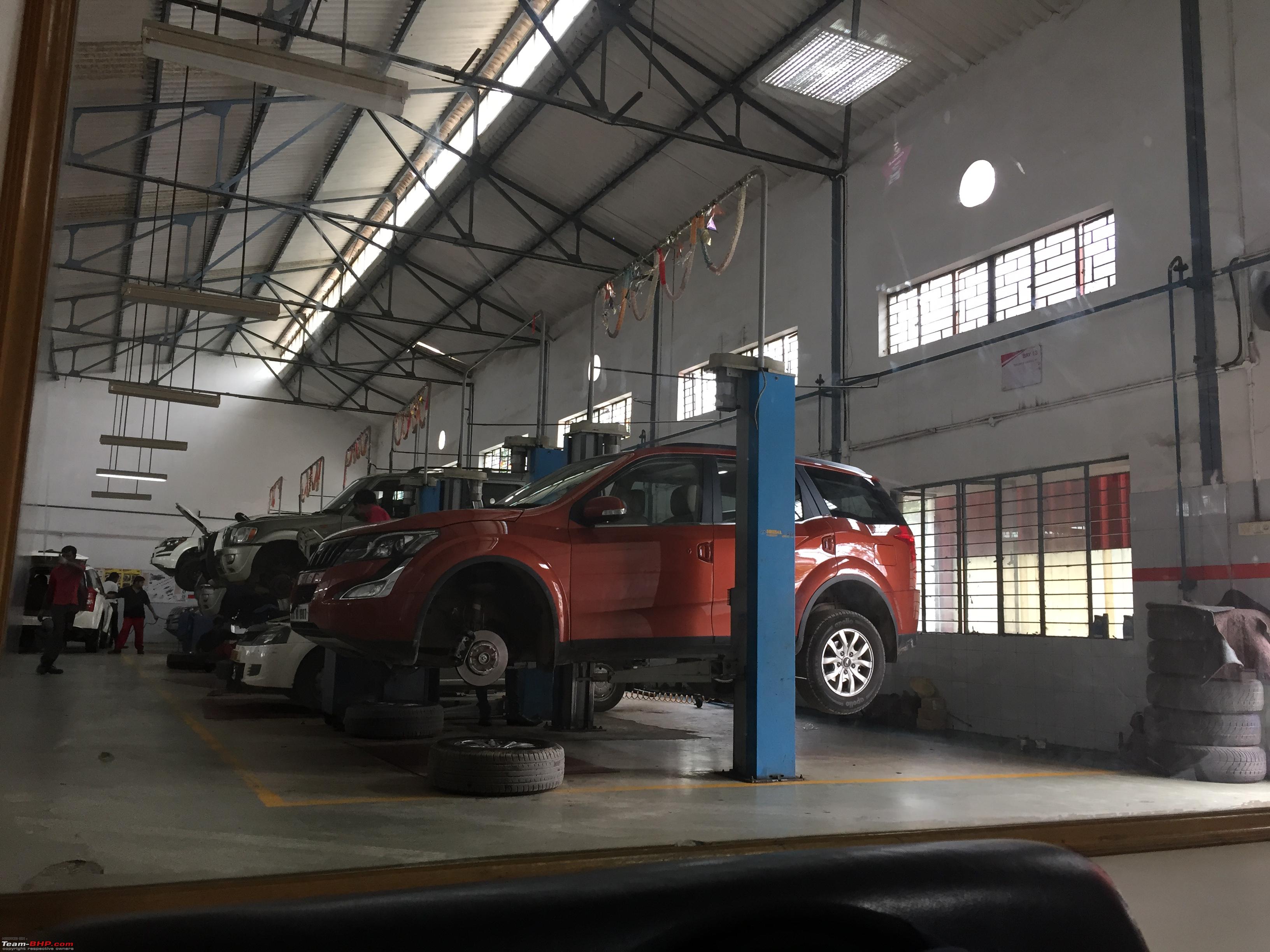

Who would have thought of my adventure ending with a black lining on so far silver shiny clouds?
With a huge list of wishes, questions and niggles I had handed over the car today for serving. I had picture perfect start of the day! First in line, First to check in the vehicle for first free service! First SA and RM spending a lot of time with me to understand what I want and what are my concerns. First experience at Mahindra/ Sireesh Automobiles to witness the servicing! I was expected to receive the vehicle by lunch time! So I decided to bunk the work to take the car with me.
During service, I was closely watching the car! Things were so nice. SA once called me inside the work bay to show how the software update to ECU and Infotainment are being done! No other car of mine had given me this chance, you see.
Ownership tales of Orange Cheetah, my 2015 Mahindra XUV5OO W10 FWD. EDIT: Sold after 150,000 km-img_3638.jpg
Ownership tales of Orange Cheetah, my 2015 Mahindra XUV5OO W10 FWD. EDIT: Sold after 150,000 km-img_3643.jpg
Ownership tales of Orange Cheetah, my 2015 Mahindra XUV5OO W10 FWD. EDIT: Sold after 150,000 km-img_3645.jpg
But then the honeymoon ends here. It's almost 3.30pm and the car is still not washed, the rear quarter panel sticker is not in place yet! I am getting late for my 4pm meeting. I asked SA and RM to intervene. The do so fiercely taking on all other teams at work. Great intentions, I must say.
And then service - GM pitches in to replace the rear quarter chrome line with a brand new under warranty. Good. This time they claim is a different adhesive. Should last longer. And if it falls off again, they will do the sticker job. Agreed.
So finally I missed my 4pm meeting and took vehicle delivery by 4.30pm. I drive out of the gate to set the destination to my home so I can take my extremely important video conference call from home at 6pm. Only to discover that Navigation is showing that weird window - contact service station! I took a 180 degree turn back into the service station. The Techno expert pitches in. He refreshed the infotainment software thrice in front of me, updated map software 4 times only to see the same screen :( And I missed the 6pm meeting too. by this time everyone has eft the service station except this early bird and my tech support team!
They finally concluded that this problem cannot be solved by them. They are escalating this to Nippon and expect the "silver" box to be dispatched for my car in next 1-2 days! And this ends my first service visit with a essential follow up visit! So in short for the lack of navigation I did not want to cancel the trip starting tomorrow. Hence decided to pull out the car. I will be visiting the service station again next week upon my return to have this navigation issue fixed.

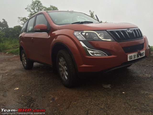

And some random pictures from drive yesterday -
Ownership tales of Orange Cheetah, my 2015 Mahindra XUV5OO W10 FWD. EDIT: Sold after 150,000 km-imageuploadedbyteambhp1442452402.159561.jpg
Ownership tales of Orange Cheetah, my 2015 Mahindra XUV5OO W10 FWD. EDIT: Sold after 150,000 km-imageuploadedbyteambhp1442452435.129213.jpg
Ownership tales of Orange Cheetah, my 2015 Mahindra XUV5OO W10 FWD. EDIT: Sold after 150,000 km-imageuploadedbyteambhp1442452457.303405.jpg
Ownership tales of Orange Cheetah, my 2015 Mahindra XUV5OO W10 FWD. EDIT: Sold after 150,000 km-imageuploadedbyteambhp1442452490.119930.jpg
