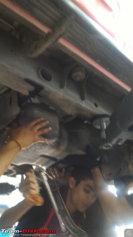

and thus today - R3 was put on the lift
- and shortly after the fuel tank was manhandled out of its fastenings

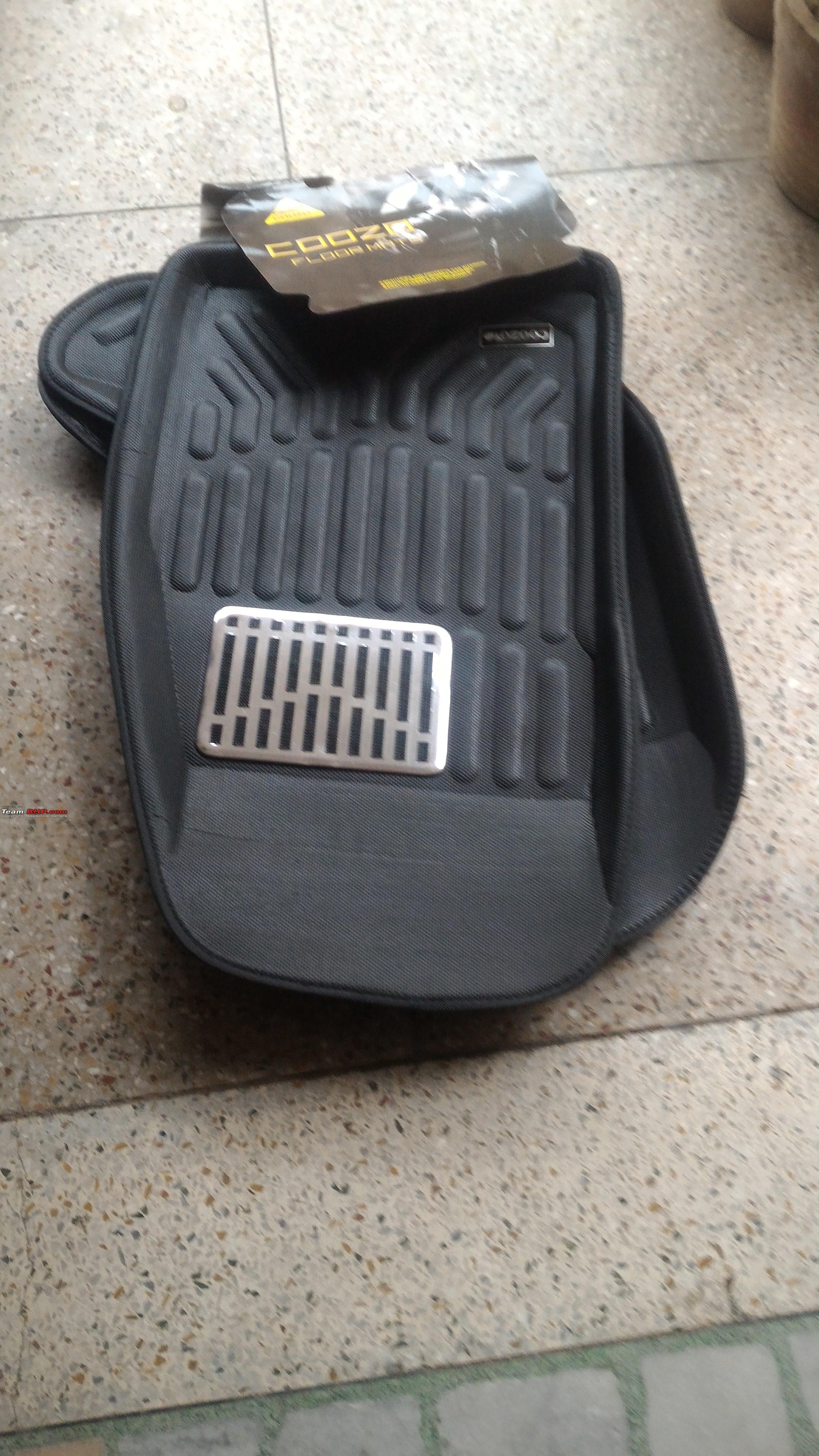

In other news - a set of new mats arrived from ebay
Raging Red Rover (R3) - My Mahindra Scorpio S10 4x4. EDIT: Sold!-p_20161225_132448.jpg

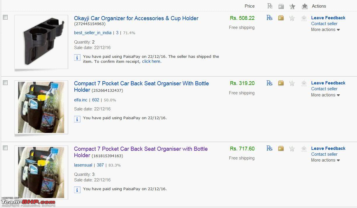

Due to the distinct inadequacy of cubby holes and niches - that are an absolutely mandatory ingredient of any long drive , I decided to splurge on the following accessories - (again on ebay)
Organizers
Raging Red Rover (R3) - My Mahindra Scorpio S10 4x4. EDIT: Sold!-77bdc9f1cab5c3e.jpg
