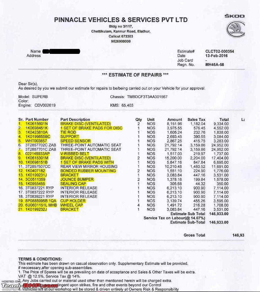

  • (B)We had asked for a thorough checkup and requested to provide estimates for the concerns we had mentioned as well as for anything extra they observed. The ASC provided an estimate of parts based on these and the same is attached below.
    • Highlighted in yellow in the estimate below, are the parts which I asked them to order. As you would notice, for the damaged interior trims (sticky door armrests, damaged rear center armrest) and slow retraction of seat-belts, ASC could suggest to only replace the item.
    • Door armrests were priced Rs.7000 each (x 3 = Rs.21000). For the slow retraction of seatbelts (only front seats belts had the problem), suggestion was to replace the belt assemblies, which is Rs.25000 each (x 2 = Rs.50000). So a total of Rs.71000 alone was suggested for the trims and belts alone.
    • These items were not approved from the estimate submitted to us(as can be seen below). Remaining haldex oil, brake discs/pads, suspension brackets / bushes, engine/gearbox rear support etc were approved (highlighted in yellow). The engine support went into back order while rest of the parts were received in around 3 weeks time.
    Estimate provided and approved items (B)
    Czech sleeper: Pre-owned Skoda Superb 3.6 FSI 4x4-estimate-approved-item-service-2.jpg

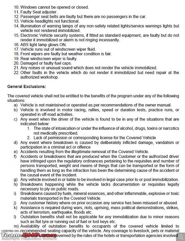

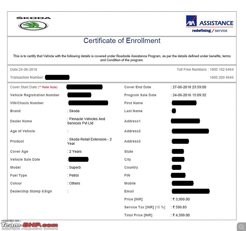

Roadside Assistance - Fine Print
Owing to the fact that there is a small amount of unpredictability when taking these cars for a long drive, we had opted to purchase the roadside assistance (2 years) policy from Skoda. I was informed by the dealer that the cost of the roadside assistance policy is a flat rate of Rs.4600, irrespective of vehicle model. The policy can be taken for cars up to 10 years old.
The way we saw it, having the need to use a flatbed for one time alone can offset this cost. Also unlike the roadside assistance policies bundled into some vehicle insurances, this policy assures that vehicle will be taken to an authorized ASC itself irrespective of the distance to one. The benefits/cover (on paper atleast) also seemed to be better. The dealer could send a payment link via email that had a 24hrs validity. Upon payment, you instantly get the e-receipt of the policy, no need to visit the dealership. The fine print of the policy is attached below if anyone is interested.
Czech sleeper: Pre-owned Skoda Superb 3.6 FSI 4x4-rsa-fine-print-1.jpg
Czech sleeper: Pre-owned Skoda Superb 3.6 FSI 4x4-rsa-fine-print-2.jpg
Czech sleeper: Pre-owned Skoda Superb 3.6 FSI 4x4-rsa-fine-print-3.jpg
Czech sleeper: Pre-owned Skoda Superb 3.6 FSI 4x4-rsa-fine-print-4.jpg
Czech sleeper: Pre-owned Skoda Superb 3.6 FSI 4x4-rsa-fine-print-5.jpg
